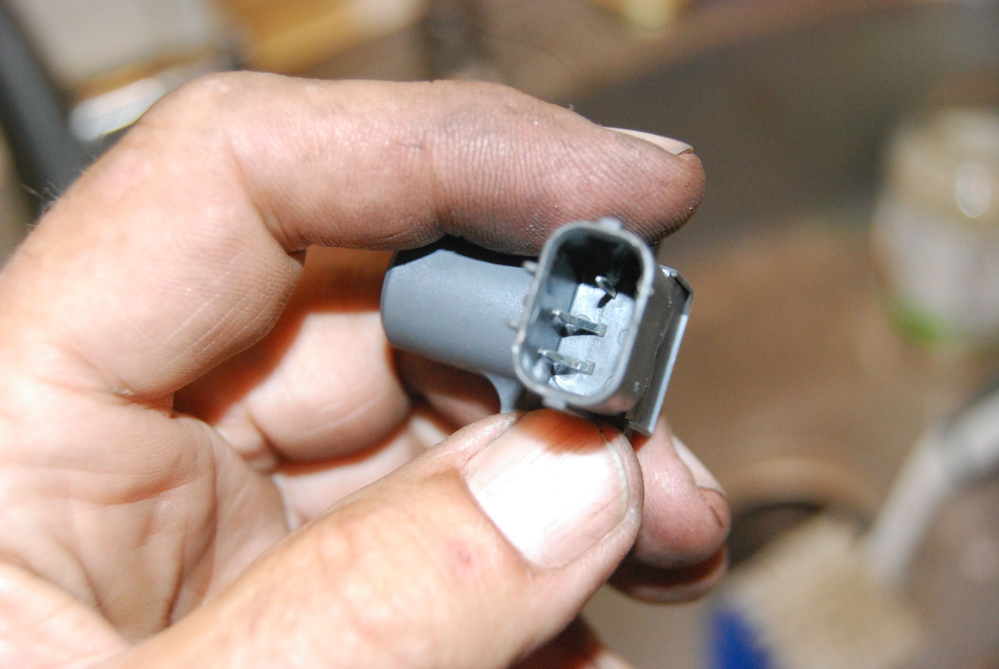

Mystery solved! I guess I was ham-fisted putting it back together and bent two pins. Big sigh. I'll probably have to wait until the morning to get it back together, as the sun's going down, but maybe now the car will actually run decently with no codes.

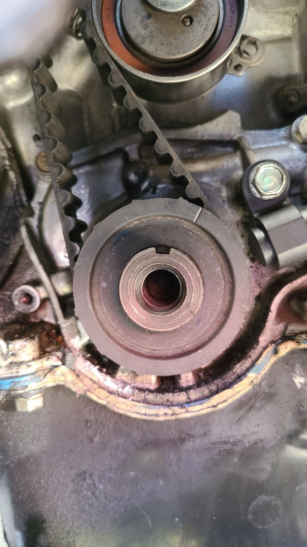

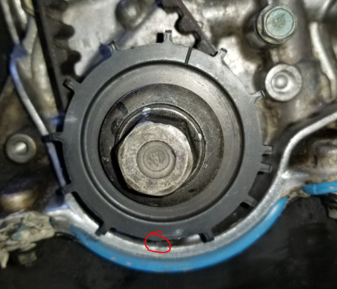

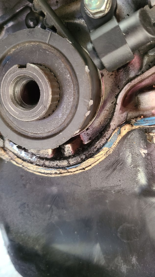

Found a/the problem... all of the teeth on the timing gear are sheared off!
I'm beginning to belive this isn't a 30k mile engine. ..

oh what the hell. That's a new one. CKP sensor freaking the hell out

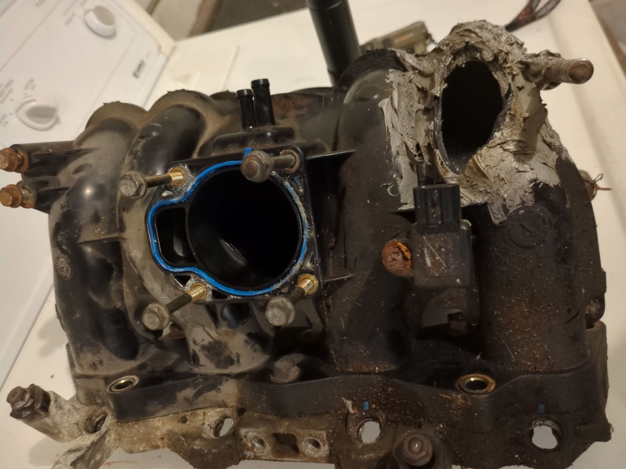

So I think I found the problem, probably need a second opinion though. /s
I gotta hand it to the JB weld / RTV folks. The patch last at least four years, maybe longer.
