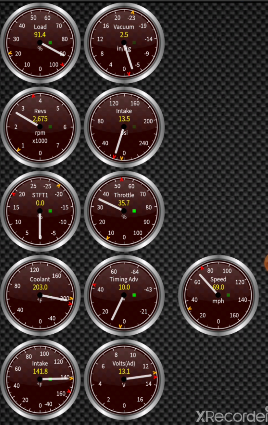

Just did a tranny swap and timing belt replacement, car was running fine then all of a sudden the car is acting like it's not wanting to go over 3k rpm unless forced but feels bigger down when pushed harder. I have a recording on my drive of the diagnostics but it's Greek to me and I was wondering if anyone could glean any info from it. I can check stuff las posted. This is my only vehicle for work and I'm depending on it hard.

The picture is during acceleration if that helps.
