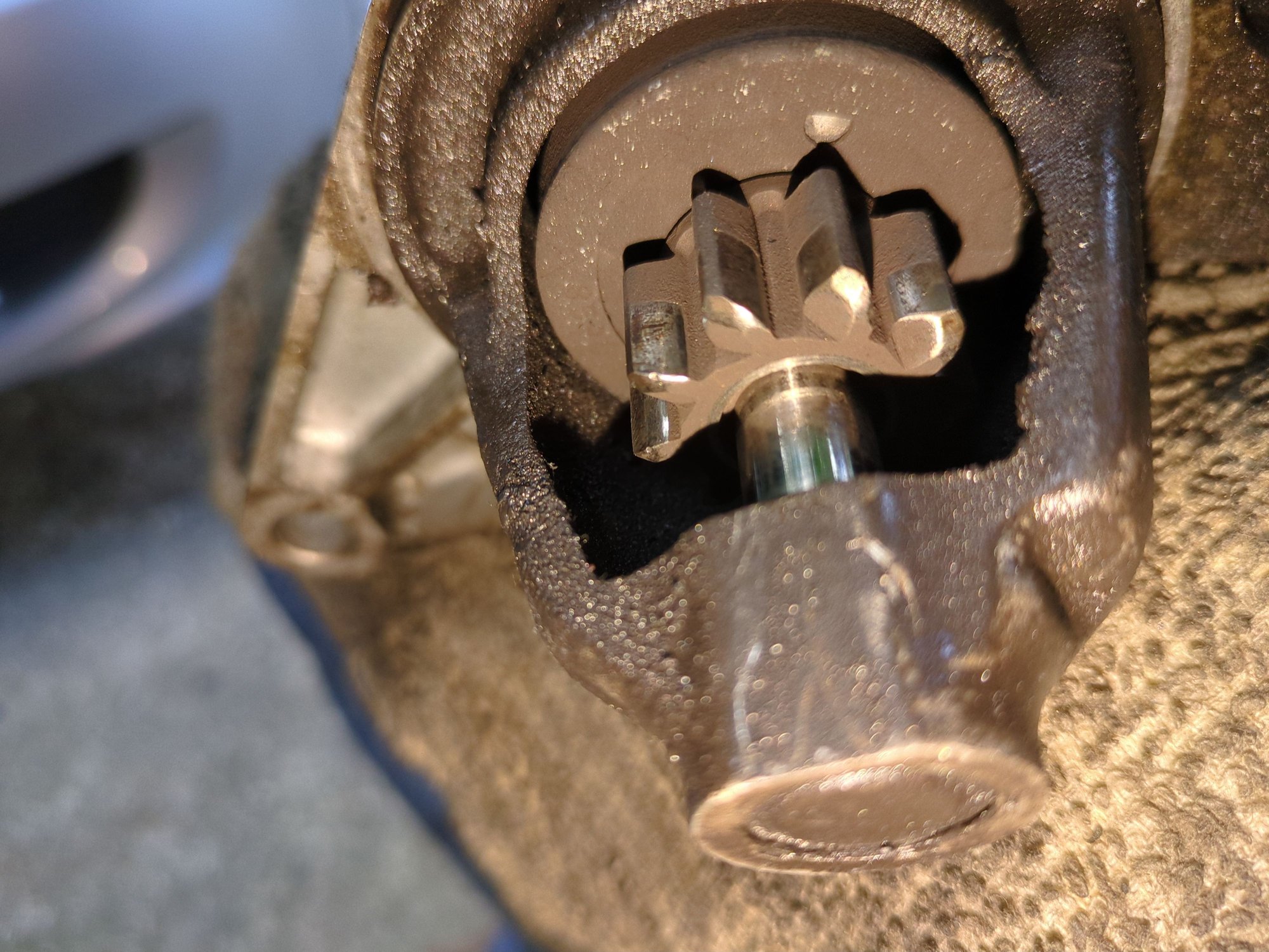

I just pulled the starter. I tested it with some jumper cables and a test lead. Gear spun and solenoid extended it. Seems good.
All the on vehicle connections were tight, with MAYBE the signal wire being somewhat loose.
That said, I don't know how to recognize bad teeth. Anybody able to weigh in on these?

Teeth are not the issue. It's probably a failing solenoid. Unless the battery is real low.

Battery is fine. My test used the car battery and the pinion gear fully extended.
Could be a semi-break in the wiring hardness?

The only way to get the starter to spin without engaging the flywheel is if the starter is bad.

Even if the pinion is fully extending when I test it? Doesn't that seem to indicate wiring?

You could try cleaning up the starter and reinstalling if you wanted.
Only two wires going to the starter. A main battery feed which always has battery power, and a solenoid wire which turns on the solenoid and starter motor. If either of those circuits were intermittent, you couldn't get starter spinning but solenoid retracted.

Fair points. I am not trying to be difficult. I just want to avoid spending the money on the starter, installing it, and winding up with the same behavior as before. The contacts all look clean, both on the starter and the wiring unfortunately.
To your spinning point, the starter ALWAYS would spin. I never turned the key and it didn't spin. The only question was if it would engage the flywheel. So perhaps the solenoid is going.

Yes, exactly. With the starter always spinning, that points to failing solenoid or the mechanical portion sticking. With the starter being on top of the trans, it isn't that difficult to replace if you wanted to try cleaning it up first. TYC brand alternator on RockAuto is about $100.
