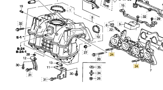

I am slowly progressing with this project. I was able to separate the old manifold upper and lower today. However, to get the nuts off the studs which hold the upper to the lower I had to grind through them and the studs. Does anybody have a place to get the part number for these?

Part number 92900-08028-1B.

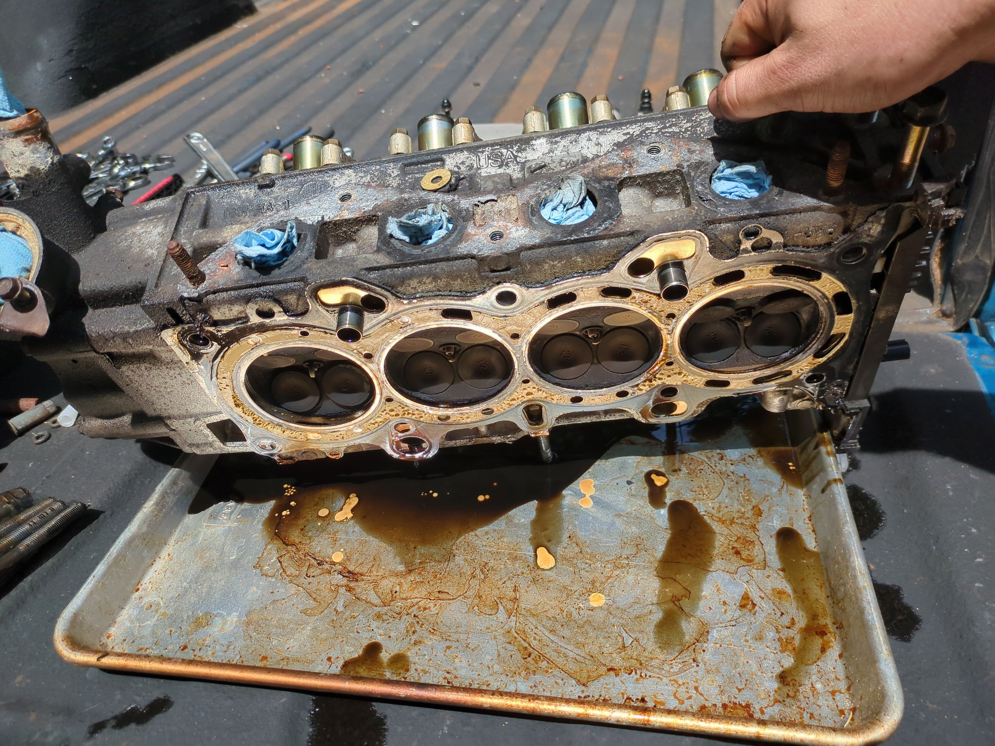

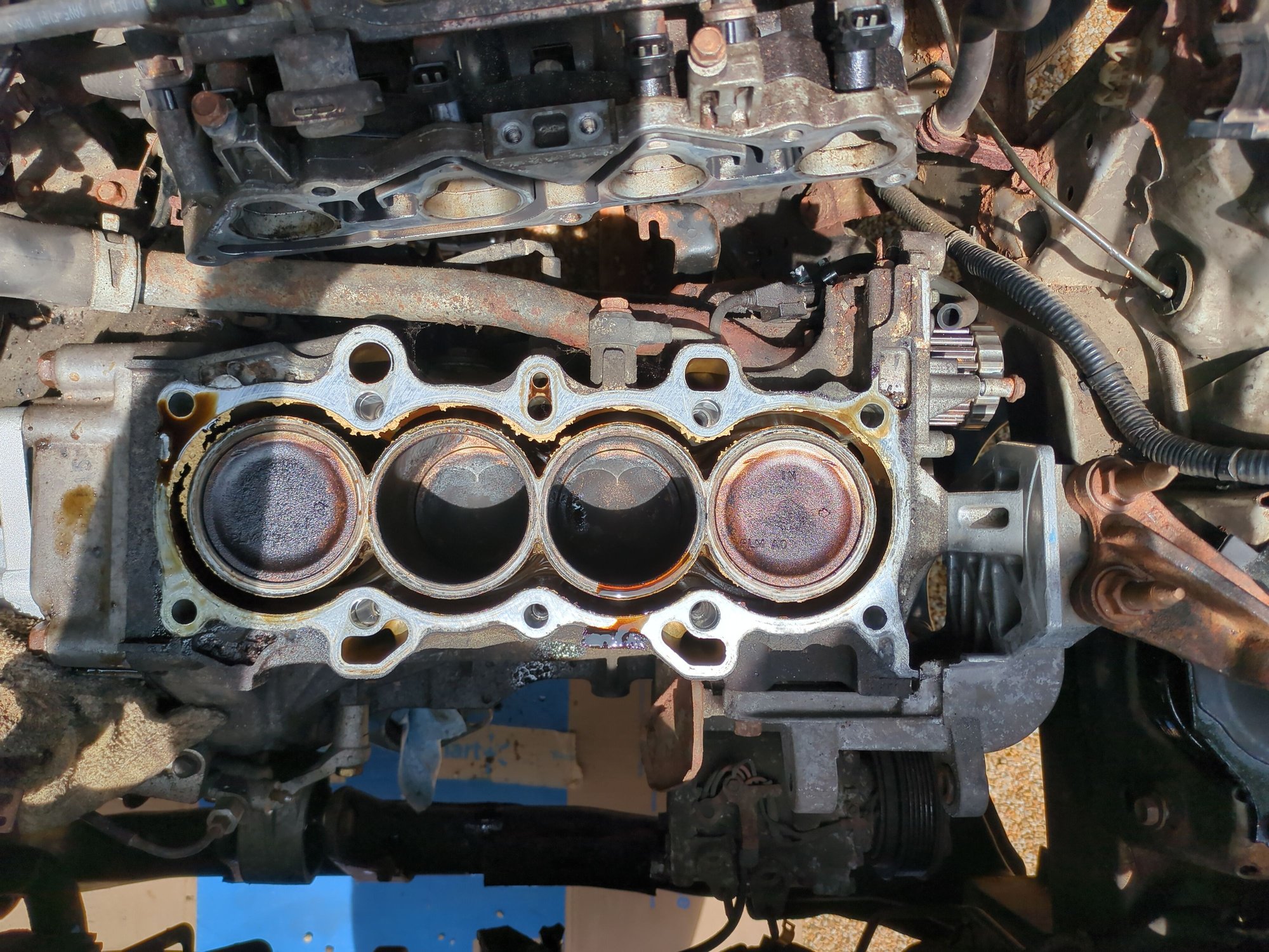

So I got most of the parts in over this week. I dug into her this weekend. I found a few things that explain some other things.
1. Oil pan is totally coated. I suspect the oil pan gasket was leaking in multiple places.
2. When cleaning up the pan I used a wire brush for the rust and found 2 slightly larger than pin holes in the pan. So that explains at least some of the leak.
3. Removing the timing cover I saw no oil around the cam sprocket so I suspect that seal is good. Is there any reason to replace the seal for age reasons if no leak is seen?
4. The belt says honda on it so I suspect original belt, no cracks in it on the top or bottom side, but does show it's age. I think it has never been done. Alternator and PS belts look similar.
5. After removing the harmonic balancer I found a bunch of oil near the bottom of the timing cover. I had been spraying penetrant so its possible that I made it look worse than it is. Either way, I think that either there was a leak in the pan gasket right there, or the crank seal is leaking, or the oil pump o-rings are leaking, or a combination of the 3. I plan to do all 3 anyway.
6. The water pump and tensioner pulleys feel solid but I bought them so I will change them out. At this point I will wait until I get the head off and on to do them.
7. I messed up the timing when removing the harmonic balancer. Afterward, I set the crank to TDC. I just need to turn the cam sprocket until it lines up properly before putting the new belt on. I will check the firing order, but I think I just need to ensure that both cylinder 1 valves are closed and both cylinder 3 valves are open and the timing will be correct. Any reason that this method won't work?
8. I found many specialty bolts quite rusted and rounded off that I will need to order before reassembly.
9. The adjuster screw is missing from the alternator bracket entirely. I guess whomever put it in just got the belt tight by hand.
Its not going too badly I think. I haven't broken a bolt off yet.

Definitely won’t be the original belt. It’ll just have been replaced with a Honda kit the last time it was done.

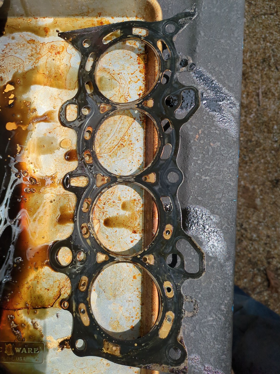

Old Jun 22, 2025
  #47
crowfather's Avatar
Joined: Jun 2023
Posts: 58
Likes: 12
crowfather is an unknown quantity at this point
Re: 04 Civic DX, Manual Trans Idle Issues
Old Jun 22, 2025
  #48
crowfather's Avatar
Joined: Jun 2023
Posts: 58
Likes: 12

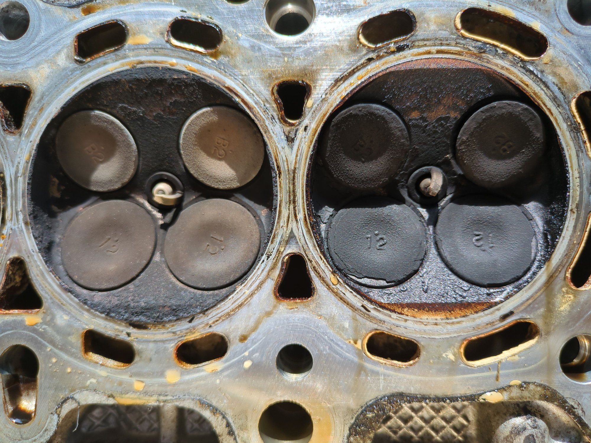

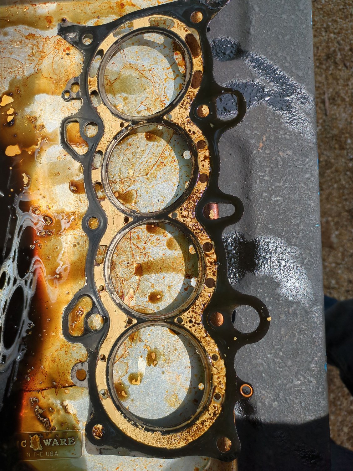

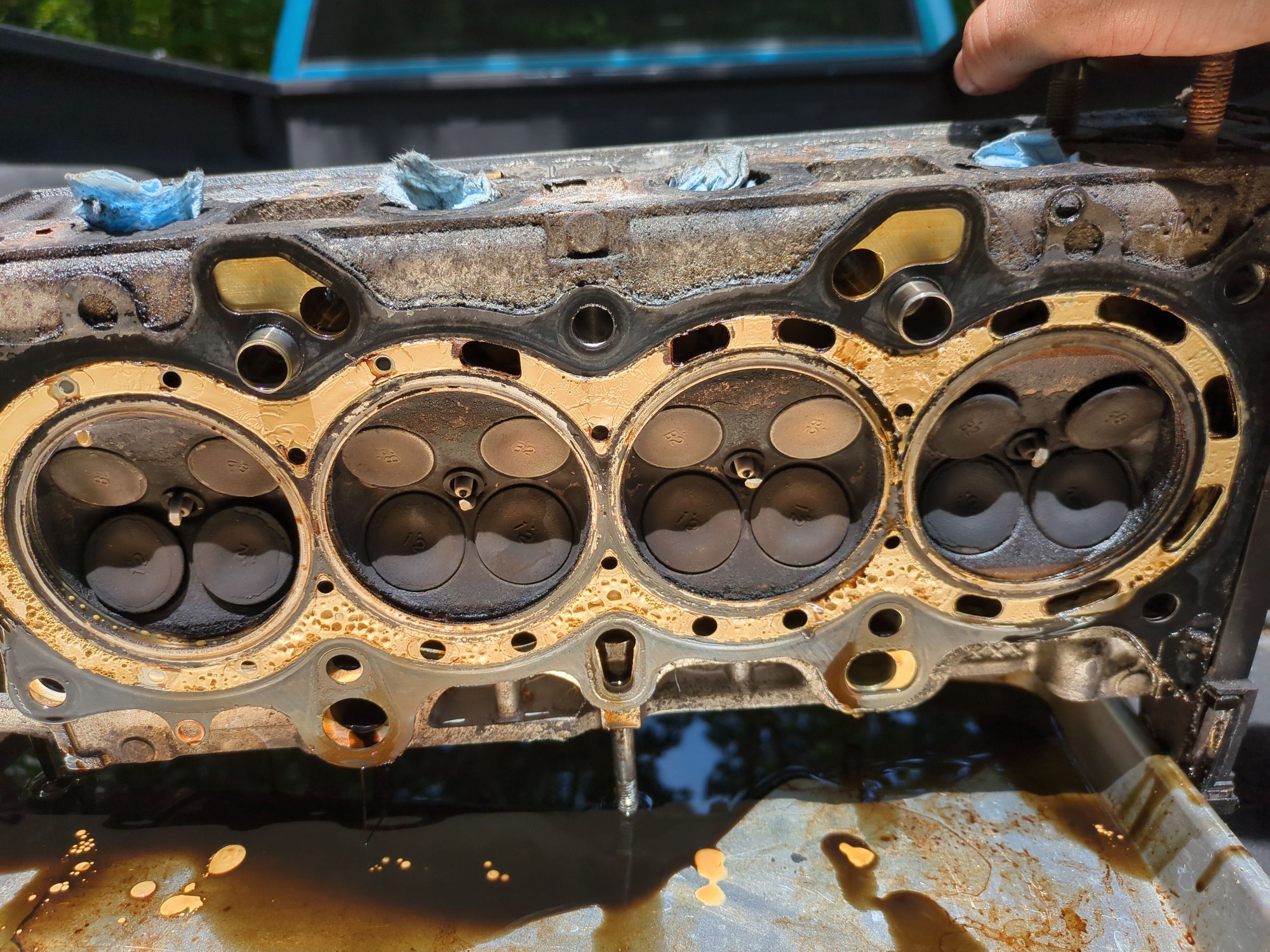

Coolant shows signs of boiling and bubbly nature in the water jacket just like at the thermostat. I also got a bunch of gunky coagulated coolant out of the drain plug hole, next to the oil filter. I am not sure how to look for signs of gasket failure on these MLS gaskets.
Old Jun 22, 2025
  #49
crowfather's Avatar
Joined: Jun 2023
Posts: 58
Likes: 12
It looks like the cylinder 1 head, right, is cleaner than the rest at the top and bottom. Also looking at the pistons themselves, cylinder 1 is cleaner than the rest. I think that's where my leak was.
