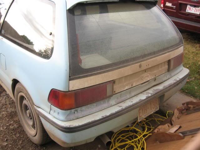

okay so if i buy this it will be my first civic... 89 civic dx hatch this is the kijiji add... i offered him 750 and going to puck it up tomorrow if i get some feedback off this site http://edmonton.kijiji.ca/c-cars-veh...AdIdZ243947332
Exact specs on car:
99-00 civic motor D16Y7 (100-110,000 kms)
Mitsu 14B turbo (good for 17 psi)
DSM 440 cc injectors
Turbosmart boost controller
Innovative motorsports Wideband A/F gauge
DSM blow off valve
88-91 Civic SI tranny, works well has no grinds.
Fairly new front tires (195's)
Skunk2 street coilovers(not cheap slip ons)

I wouldn't run any boost on that motor without giving it a serious mechanical inspection first, get everything in good shape and then it would probably handle 5-8psi but no more. Otherwise, you get what you get for $750..

If the guy was running a stock engine at 12psi the internals are probably all junk by now, without forged internals 8psi is pretty much as high as you can go without causing damage. Starting to build the internals to handle boost would easily cost a minimum of two thousand, but you could easily spend several times that.
If you want to swap the set-up onto your s-10 look into the specific parts, but I doubt it would be worthwhile.
It looks like a great deal on the surface, but I wouldn't touch it.

It kinda comes down to the old rule about buying modified cars, don't.
The Mitsu 14b turbo came on 1st gen eclipses and talons I think, so its not the most valuable piece. For an OEM turbo its in pretty good though. The whole turbo set-up is less than $1000 new..
The usual problem with boost is that it just wears everything down way faster than normal, but it is a Honda motor so if the compression test are all good the motor should be okay. I would also be asking if he had it professionally tuned, tune is key when turbo'd.
