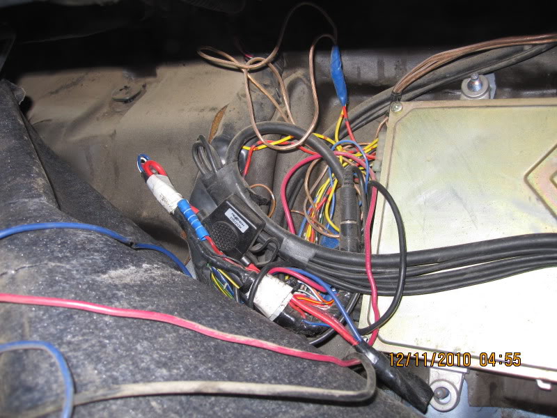

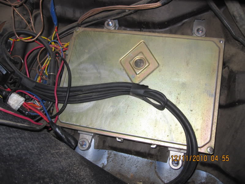

think i may have just found it... looks after market since it has a nextech fuse

Old Dec 11, 2010
  #114
Rep Power: 513
Re: no idea if this is a good set up or not
follow the group of black coated wires.. where do they go?

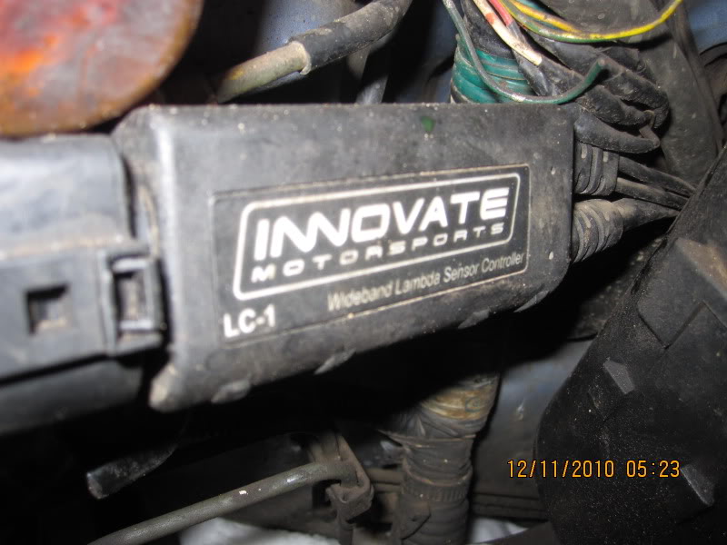

the go threw the firewall to this... it says wideband lambda sensor

THEN to a sensor in my turbo
Ah, just to an a/f sensor.. I'd ask the last owner what they used for engine management, just to be 100% sure

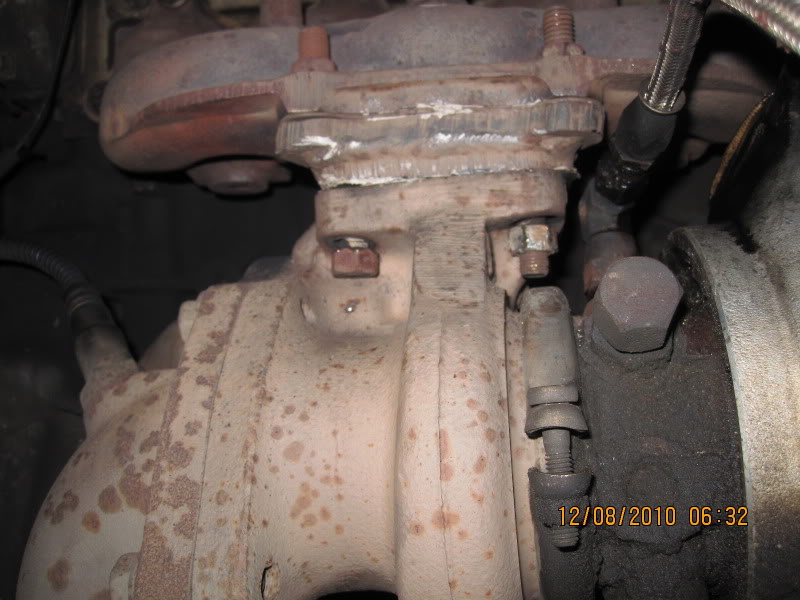

this is where that sensor controller goes.... right to that sensor on my turbo on the left
Damn, you weren't kidding, right on the turbo.. That sensor can be installed anywhere within 18" from the turbo discharge.. Lol
Thats a wide band controller, it plugs into the 02 sensor to control the A/F mixture but it doesn't give you to much control.
http://www.innovatemotorsports.com/products/lc1.php
