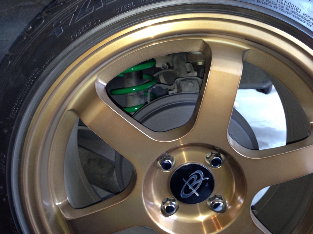

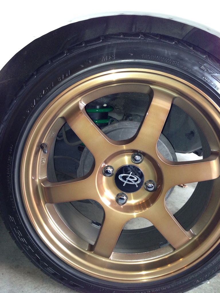

Got the damaged rim replaced.
Next project will probably involve the trunk floorboard.

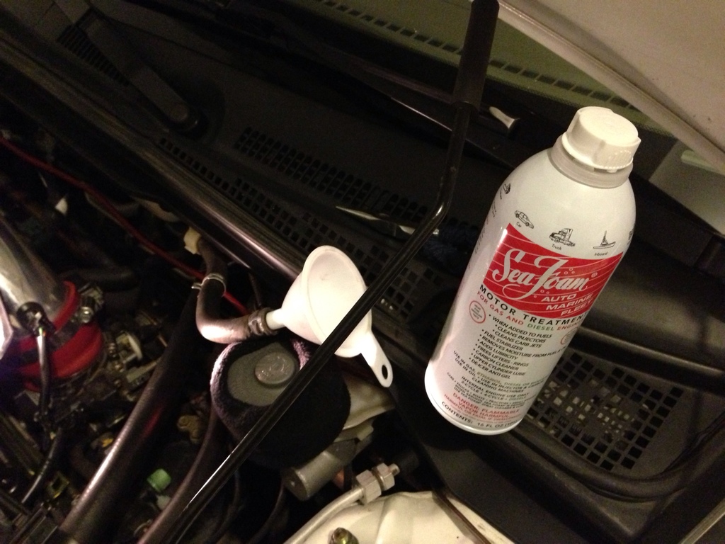

Also finished Seafoam tonight.

Rep Power: 353
Re: Kennykid2002's Build Thread
Did you see a butT load of smoke?

Lol yeah, it was pretty intense for like 10 mins

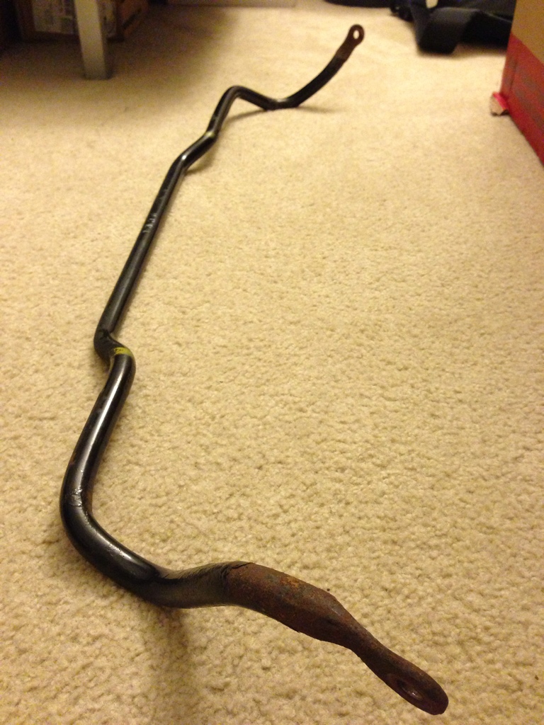

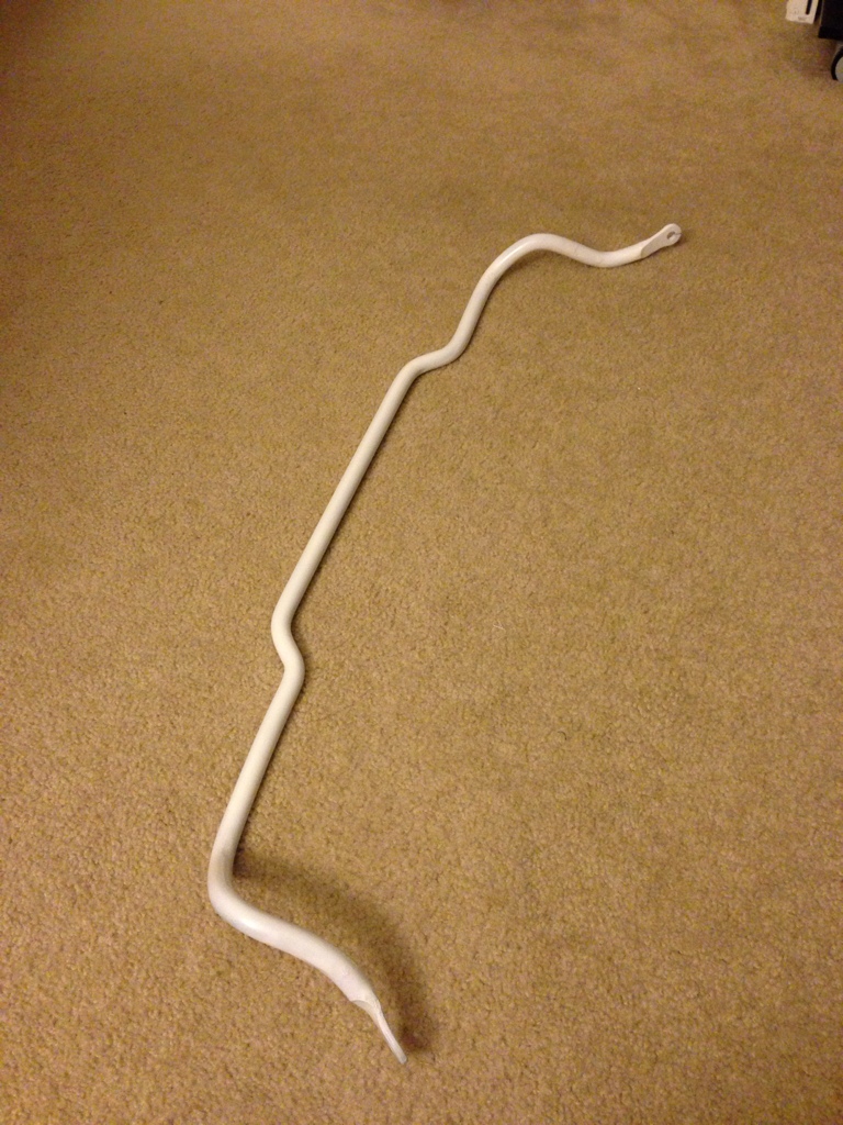

Mini DIY: RSX Sway Swap
Got my stock RSX sway 19mm today.
I was planning on going 21mm, but the 19mm was cheap enough for me to hop on it.
The ends were slightly rusted where the paint had come off.
When I got it

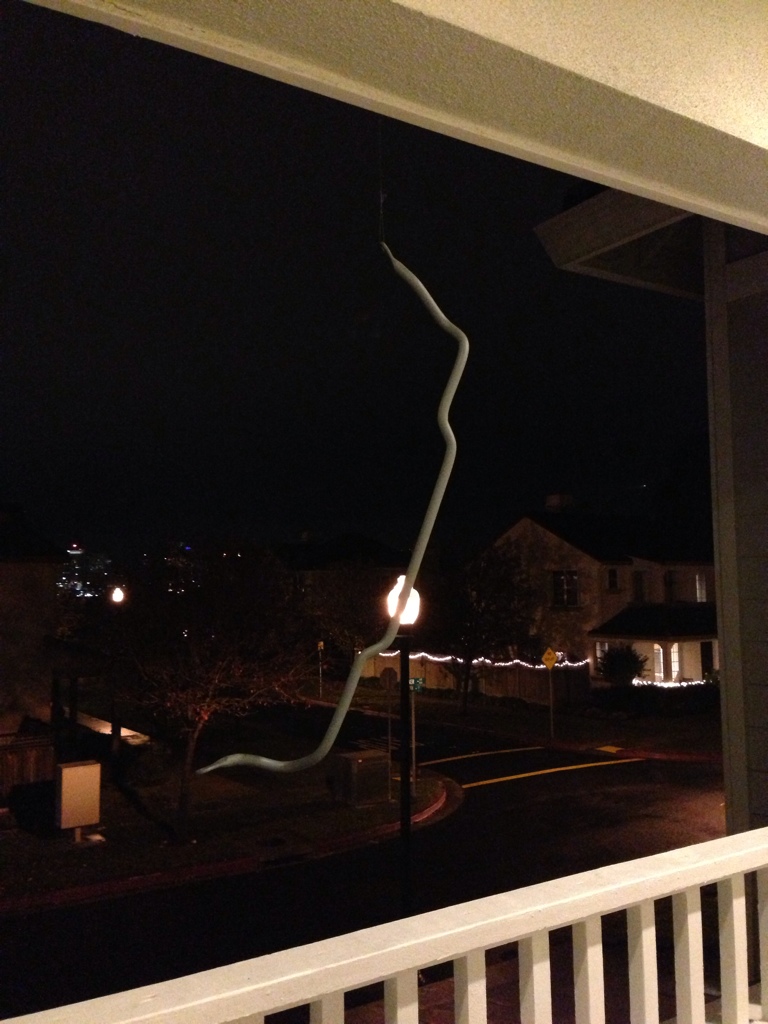

Decided to sand it down and paint it to prevent further rusting.
Used what I had in the garage, primer, primer sealer, and a little bit of white enamel.
No paint booth?
Ricer innovation!
Didn't have enough white to do multiple coats, so I just went with one thick coat.
Didn't get 100% full coverage though.
Here it is finished.

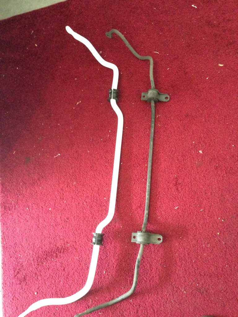

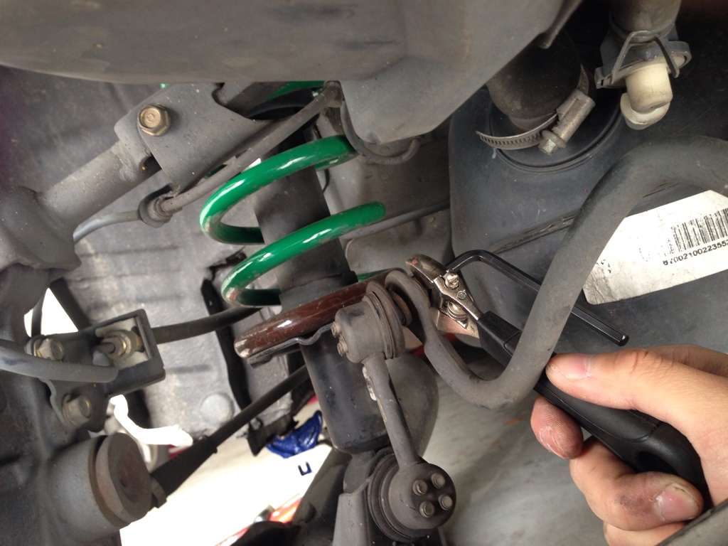

So time to take out the toothpick of a sway.
Size 5 hex key, with adjustable wrench will do; sockets will just turn the nut indefinitely. Do on both sides and take off the two mounts with 4 12mm bolts.
Compare the toothpick to the monster

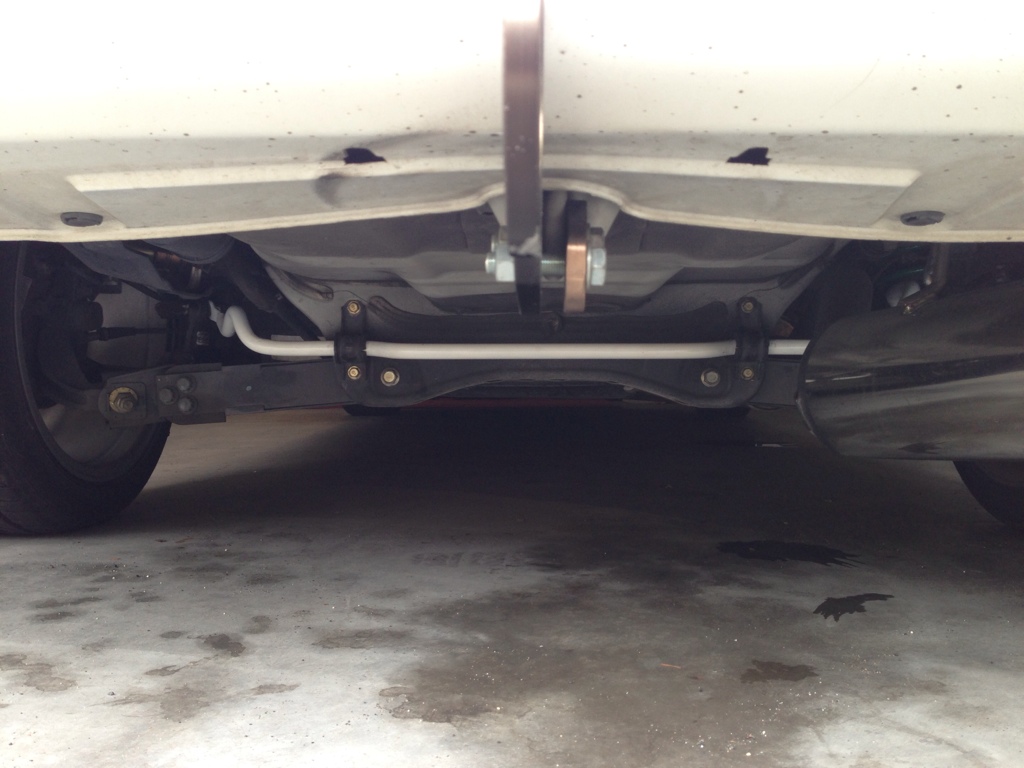

Reassemble opposite of assembly.
Tada!
It feels a lot better in the corners now, body roll is significantly reduced.
There's still some, but it's manageable.

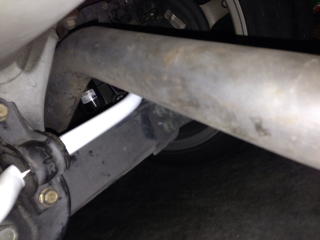

Originally Posted by PearlVic
hahaha your painting process is funny, looks good, uhm question, you probably didnt notice this but did the 19mm sit closer to your exhaust than the 13mm did? thats why i'm worried about getting the 21, because my stock one is fairly close to my 3" exhaust pipe and if i hit a bump hard enough my stock sway bar actually rubs my exhaust pipe a little bit lol
The paint process is the same whether you're in a booth or out on a balcony.
You hang up the piece to be sprayed and spray it down.
The sway sits nowhere near my exhaust.
But that may be due to the exhaust being angled out.
Plus, I don't have 3" piping lol

Angled ricer exhaust ftmfw lol
Plenty of clearence.

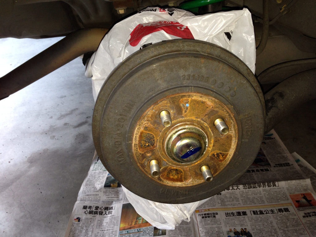

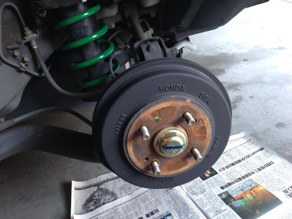

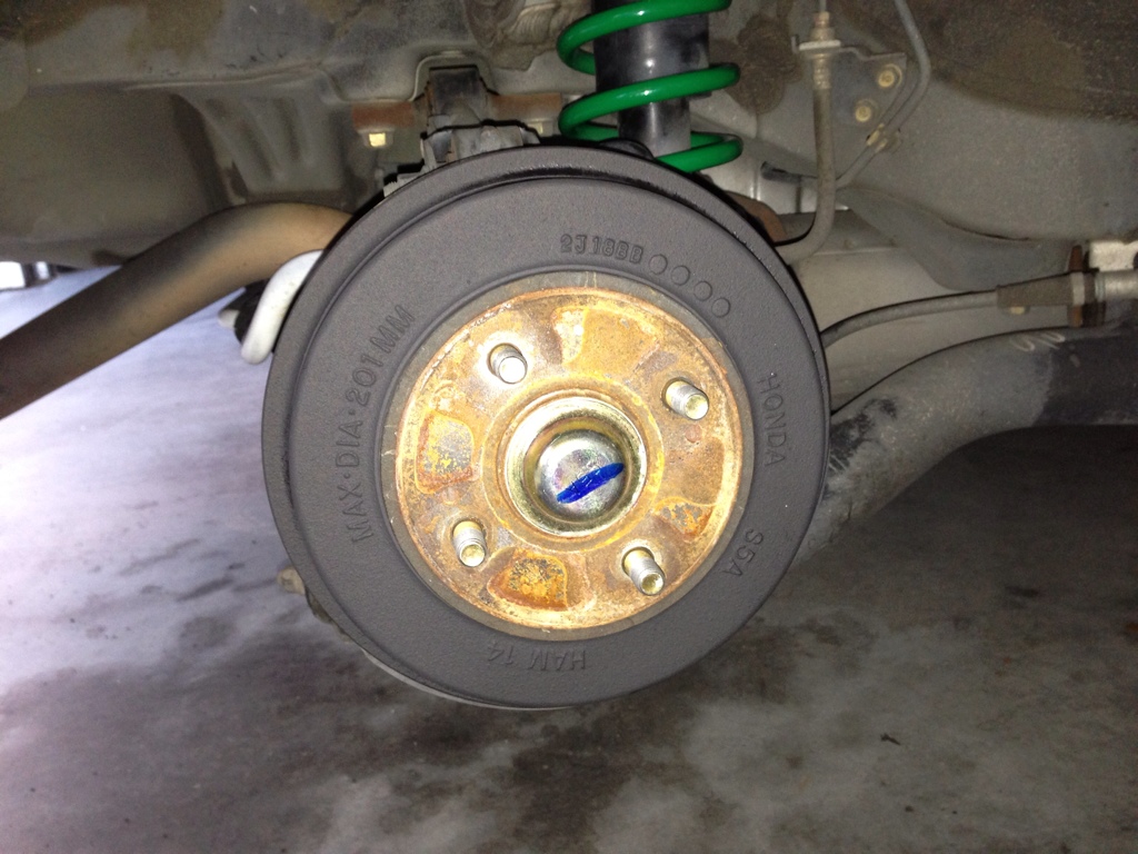

Painted my rear drums.
Didn't turn out as black as I thought it'd be.
But I sort of like this gunmetal gray type color.
Didn't get to do front calipers, will probably get to do them tomorrow.
Before:
After:
