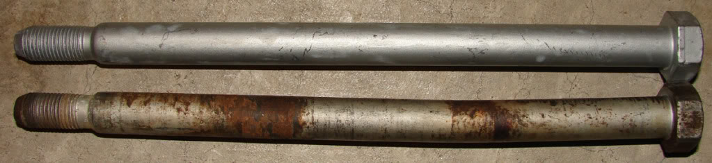

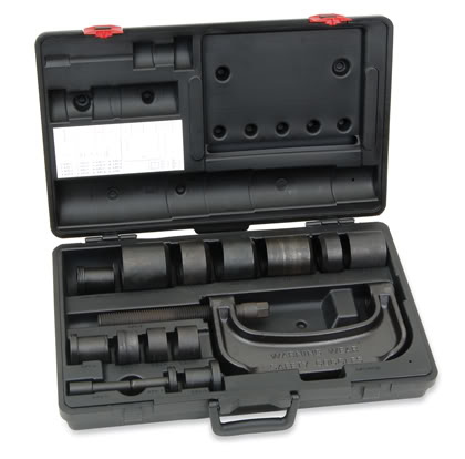

I'm going to add a little bit to this as well. If you decide to replace your ball joints you don't need a press it CAN be done at home. You need this tool that acts as a mini press and its a DIY job instantly:
Just figure I'd throw my .2 cents in since I just replaced both mine... Most places rent this tool for free too so you don't have to buy it!

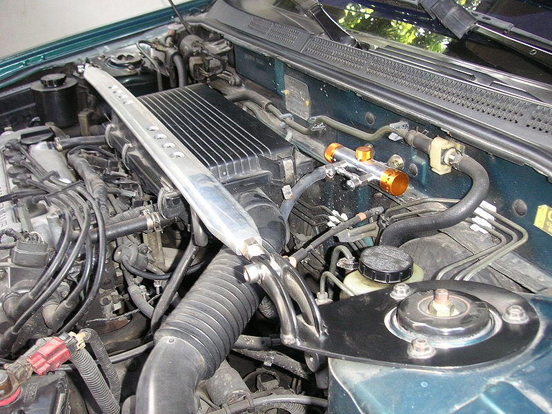

this one is full of bends and wrong direction of the cross section...

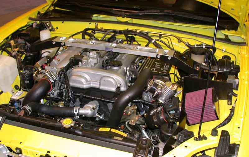

Struts, somewhat at a distance from the firewall, might benefit on torsion when passing one wheel per time over a bump. Improve the steering feel - you will get more feed back from steering and it will not be as sloppy.
4-6th gen
Double wishbone - will get less improvements than the strut 7th gen.
Here is a good reading on them.
http://forum.miata.net/vb/showthread...wer+bar&page=2
But, in comparison, the miata does have the upper arm mounted in the subframe extension, while the honda is quite high and mounted to the chassis, so some improvements (more than the miata) can be expected.
The distance from the firewall is similar to the 7th gen.
Older models might have less stiffening in the firewall, so they might profit more from install.

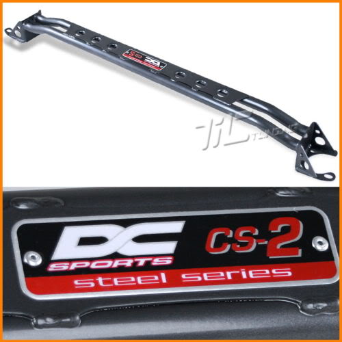

Good design:
1) One-Piece (They do not flex, no pivoting points that change the geometry freely - just simply sturdy - tubular design resists flex to any direction):
DC Sports:

2) Multi-piece: - will not allow bending/ flex at all either. very sturdy.
3) Three-point design - supposed to be the best solution, will depend how strong your firewall is.
This design below... hard to say, cross section IS wrong, but triangular design might save it?

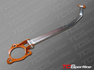

Not so good design:
Why? the mounts are in angle towards the front of the car - these pieces will bend. Also, cross section is wider in the horizontal... They need to be sturdy in the vertical so as to keep the toweres apart... Pivot will also allow the geometry change - no resistance
Pityful design: These will bend if you lean over it...
The cross section direction is wrong, pivoted and have the bends that will just... increase the bending...

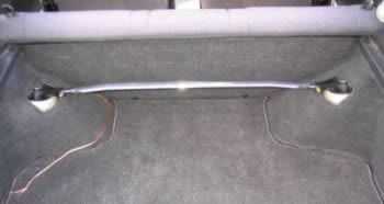

Rear:
Still thinking about the low height of the towers and close to the wall... Are they going to give any improvement?

Well, i had a "small" encounter with a curb just after buying my miata (bald tires from PO, etc) and the car always was kinda strange to drive, some insecurity when turning - i can push the civc much harder than i can the miata. Very strange, actually, miatas are supposed to be much faster in corners.
After a few years, since i was able to align it, i never looked too close to it.
Well, i got new control arms (all 8), and was disassemblying them.
Heh! found the culprit! Control arm to the knuckle bolt...
So, bottom line is: whatever you ask here, replies are simply... worthless if the guy asking did not inpect nor did disassemble the parts.
I put the new control arms side-to-side with the removed ones and they seem all perfect.
What was not "perfect" was this bolt... And it was not visible from the outside.
So, if you are going to ask what's wrong with the suspension, just don't, and disassemble it, inspect and then post here.
Could be anything.

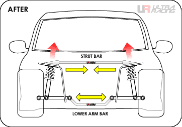

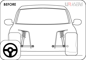

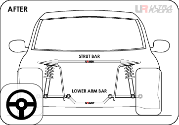

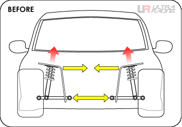

found these online, so decided to share
