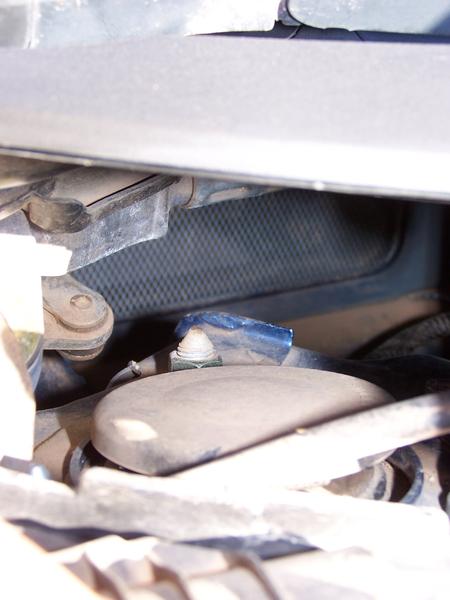

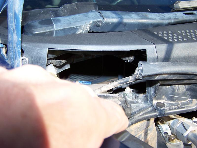

We had a similar problem with our 2006 Civic EX but the mice were also running around inside the car, chewing on items like the seat belts and nesting in the trunk spare tire well. The only place I could find where they might have been getting in was the fresh air intake ductwork. We decided to always place the air handler in ‘recirc’ mode to block their access but it didn’t take them long to chew thru the recirc door.
If you look at the fresh air input from the outside, thru the black cowl cover, you will see that the opening has no screen over it. The cowl cover keeps things like leaves from entering but mice can get into that area by crawling thru the opening for the hood hinges.
I removed the black plastic cowl cover with the intent of installing wire mesh but it was impossible to get that far into the cowl. I then removed the entire blower motor housing which gave me access to the inside of the firewall. I installed thick mesh screening, on the inside, then reinstalled the blower motor housing. We have not had a mouse inside the car since.

It wasn't too bad. There are a couple of screws way in the back that I had to use a mirror and flashlight to find. I did not remove the blower fan, it stayed mounted in the housing. Unfortunately I did not take any pictures of the procedure at the time but I just took these that show where the problem was and the type of mesh used.

The oval shaped mesh screen in the photos....? is that what you added ???

Yes but it only looks oval because the opening in the firewall is oval. The piece of mesh I added was rectangular. I screwed it to the firewall so it would stay in place. The blower box had foam around the area that mates to the firewall so it just compressed up against the mesh.

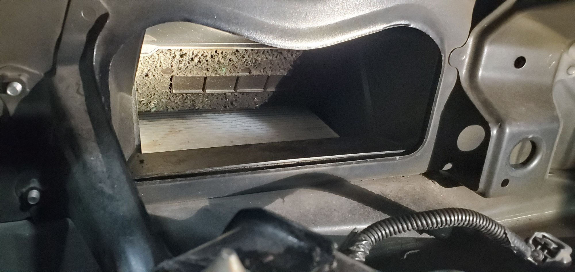

It's an old thread but not an old problem. I built a home for my mother-in-law at our farm. She seldom drives and parks next to a wooded area. Anyhow, she complained of a stench in her 2008 civic. Upon investigation I found a tremendous amount of debris and a dead mouse in the cabin filter area. It was cleared and the filter replaced. Over the next few weeks I discovered more debris, mostly jute from the car, blocking the new cabin filter. The mice had started chewing the filter too! Today I removed the cowl (A1Auto has a great video) and removed the wiper assembly to gain full access. The fresh air intake is wide open, 9" x 5", allowing the mice to easily get in after climbing around the plastic cowl. I made a template and cut a grate from a piece of SS perforated sheet. Four nutserts were fitted and I installed it in the intake hole. I don't know if a mouse is still in the ventilation ducting but I know it can't get out. Heading to the store to replace the pee stained filter and hopefully an end to this dilemma.

Nice fix
