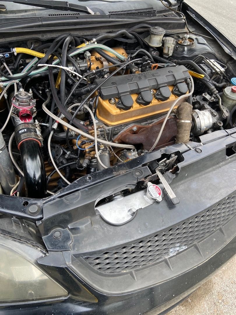

What is UP community? I finally took the car out to drive! I can hear the turbo spooling up, but I am not yet ready on tuning my fuel map so I made it a short drive just to pass my idle/WOT tests for A/F ratios. My boost gauge sits at 0 the entire time and doesn't even read vacuum. I have it hooked up to my GE vac mani. The vac mani gets a main line from the brake booster which is Teed. One line goes to the intake manifold, the other goes to the vac manifold 1/2 supply port. I have my boost gauge and BOV hooked up to the GE manifold. I have to fix my boost gauge. I am using a manual boost controller. The manual boost controller gets it bottom port hooked up to the turbo pressure source, and top port ran to the wastegate port. I have a 5psi spring in the wastegate with my MBC set to minimal setting.
1) Not sure why I am not reading vacuum at idle on boost gauge/nor boost on load....... Any ideas?
2) Is it ok to tap in the turbo water line into the two heater core water lines? I've been running it this way, but for some reason the coolant lines to the turbo are not getting warm too the touch. They are -AN lines, and I now realized my heater does not blow warm air when dialed to the heat position and in defrost mode. I am wondering if me tapping the heater lines incorrectly has something to do with this? I read somewhere there is a one way valve for the heater core lines you must be cautious of. Not sure if they exist before the firewall on the EM2 by the firewall where I tapped in.

-Fixed boost gauge (Forgot to drill out the holes on the vacuum manifold)
-Fixed turbo coolant lines (correct way is to tap the hot side to the hot heater core feed inlet BEFORE the heater water valve (sits behind intake manifold) and run the cold turbo coolant feed from heater core return
-Went for test drive, and the boost is fun! I let her sit around 5psi, and she pulls! Boost kicked in unexpectedly and got me haha.
-Tuning: You want to aim for 14.7 psi before boost (in KManager this is columns 1-7)
Going to do a street tune write up and add to this thread soon. Stay safe out there boys. The show goes on.

Sup gang, Here is my updated progress on the build.
As many of you know, I posted a video a few replies ago. I have since Mid-Feb completed the project, and been fine tuning since then.
Fine tuning: Kpro fuel tables, wiring, getting all devices functioning like gauges, vacuum manifold plumbing, exhaust leak fixed, and I even test drove it 4-5 times.
The main issue I have not allowing me to progress is overheating.
I am running a 98 civic half radiator I bought from Autozone (same one I had while running N/A).
I have been trying to diagnose the reason for it.
So far, I changed my water pump.
I noticed this, The return line from my heater core (cold) which goes to turbo’s center housing coolant feed port had no flow through it while the car was running (even let engine warm up).
I am waiting on a motor mount to arrive in mail, so I can put on P\S and Alt, then fill the engine with coolant, bleed air, and see if the engine still overheats
One thing I have to say is, in 2017, I put on a new headgasket, timing belt, water pump, the whole 9 yards. I drove probably 20k miles before I put the car to the side to finish the turbo project.
The car sat with no coolant in the entire system for a little over a year until in February I started the engine up with fluids topped off.
Good news
I got the fuel maps made and it was idling and driving well. I hit boost at 5psi, and can say if you’re planning on going turbo, a Hondata Kpro is the best way to go in terms of fuel management.
I can’t wait to get the engine cool and normal to really up the boost.

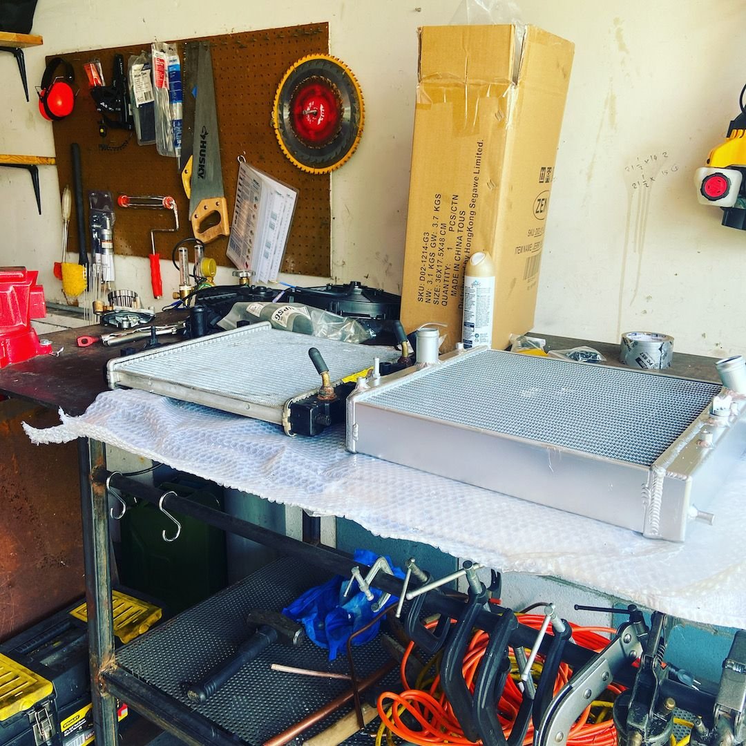

No I figured it out. It's working now.
-Replace faulty water pump
-Upgraded my radiator and replaced radiator fan
She runs like normal now. No more overheating, just need to play with the tune a little bit. This project is coming to a close. I can honestly say I am done at this point with the boost project!
Here is a direct comparison of the stock radiator to the new upgraded radiator I installed. (Left=Stock, Right=Upgrade) Works wonderfully

I was able to also cool the turbo using my heater core lines as I plumbed them correctly. The return line from the heater core is tapped for cold supply to the turbo coolant inlet banjo port. The coolant line exiting the turbo from its banjo fitting is Teed into the hot thermostat housing coolant line. The only thing left to do now is to tune my A/F ratios properly. I am running KPRO in closed loop, but have to modify some things and run it in open loop to obtain desired idle, PT, and WOT ignition/fuel settings. Might do a write up.
With minor modifications and cutting I was able to fit the giant radiator behind the bumper and have great fitment still.

Wastegate Spring is “small red” on catalog for Tial F38 installed currently which equates to 5.60 psi
NXS Motorsport Manual Boost Controller (ADJUSTED ALL THE WAY TO LOWEST SETTING TO ALLOW FOR 5psi, BE CAREFUL, THE MORE YOU ROTATE CLOCKWISE, it adds 1psi of boost to motor per thread) (Small red thing with two stainless steel lines connected to it is the manual boost controller MBC) This allows you to increase the boost without opening the wastegate and replacing the spring!
Crankcase Breather System
Ebay Oil Catch Can Plumbed from Valve-Cover to Intake Tube before Throttle Body to allow pressure to dissipate
Turbocharger
Turbonetics T3 .63 A/R Ceramic Ball Bearing with water-cooling ports and oil lubrication ports (both connected)
Turbo receives oil from stock oil pump off a brass Tee from the oil pressure switch location where I have plumbed the oil pressure switch that comes stock in addition to a pressure sender unit for the pressure gauge for oil on the dash and finally the oil feed line to the turbo
Recommend replacing the oil pressure sender unit (brass cylinder) about 30 bucks from Autometer
Turbo feed line has been plumbed to top of turbo with -AN line size -4AN
Turbo return has been plumbed to oil pan with -AN line size -10AN
Turbo oil restrictor came installed on the turbo when bought new
RECOMMEND INSTALLING A TURBO MESH FILTER ($60 online) or a MUSHROOM FILTER on the TURBO to PREVENT DIRT and DEBRIS from ENTERING
Intercooler
-RDT motoring universal kit aluminum tubing black from ebay
-RDT motoring intercooler
Radiator & Cooling
-Speed Daddy Ebay Triple Core Radiator (February 2020 installed)
-A/C delete (No A/C compressor, condenser, belt)
-Ebay coolant expansion tank (reservoir..the long shiny cylinder full of coolant/anti-freeze located by the battery distro-block)
Engine Computing Unit (ECU)
-HONDATA® K-Pro (Use a WINDOWS laptop with KManager software to connect to the ECU)
-USB connection cable is in passenger glove box for tuning
-AEM custom cam gear for D17 (has to be installed for ECU to work, per instructions of Hondata)
