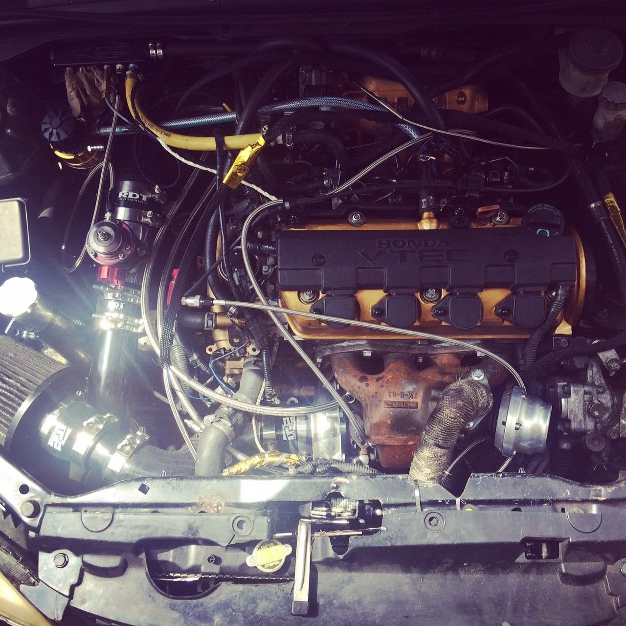

-VC installed (my 3rd one! haha)
-Fixed hood not closing issue; it turned out the reinf. I had cut out from the old A/C fan support I removed was making the hood latch flex downwards when pressure was applied so I welded angle iron to the frame and below the hood latch to keep it rigid and voila. I also cut some support from the hood where the dumptube bends upwards (the primary layer only).
What is left to do?
This summer is winding down for me and I am headed back to my last semester of school.
My plate has somewhat emptied out now, so I feel more relieved. My EM2 project is nearing completion, so I will have more time to wrap the project up and get her tuned.
-I have to fabricate the remaining portion of the stainless steel exhuast system I designed using 3in .065wall stainless steel tubing. Check out aceraceparts they have really good deals on bends. Especially if you buy in bulk. And they offer UL approved tubing which has a much higher quality then generic ebay stainless steel.
-I am contemplating fabbing up a heim joint support brace? anyone? Needed?
-I am also not sure how this will go if I want to refill coolant and burp the car without a tune will it be an issue?
-Fill the oil/ oil filter install, injector size update KPRO
Tune after burping coolant/checking for leaks
Thank you everyone for the support! Can't wait to drive her again!

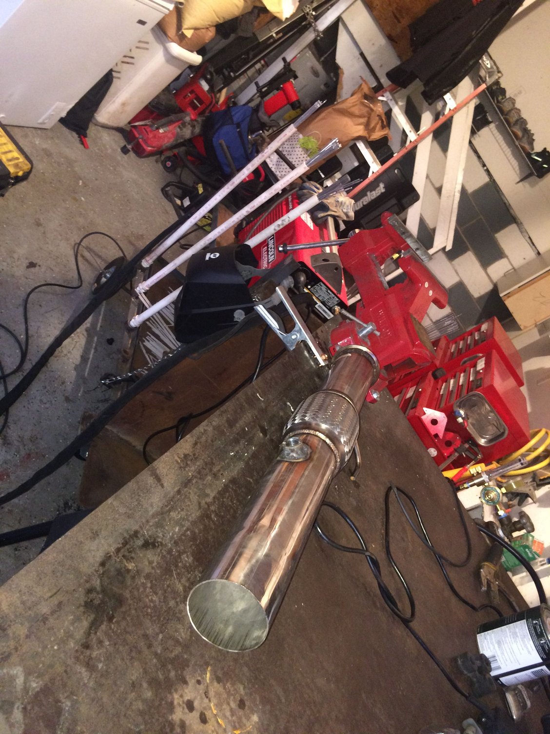

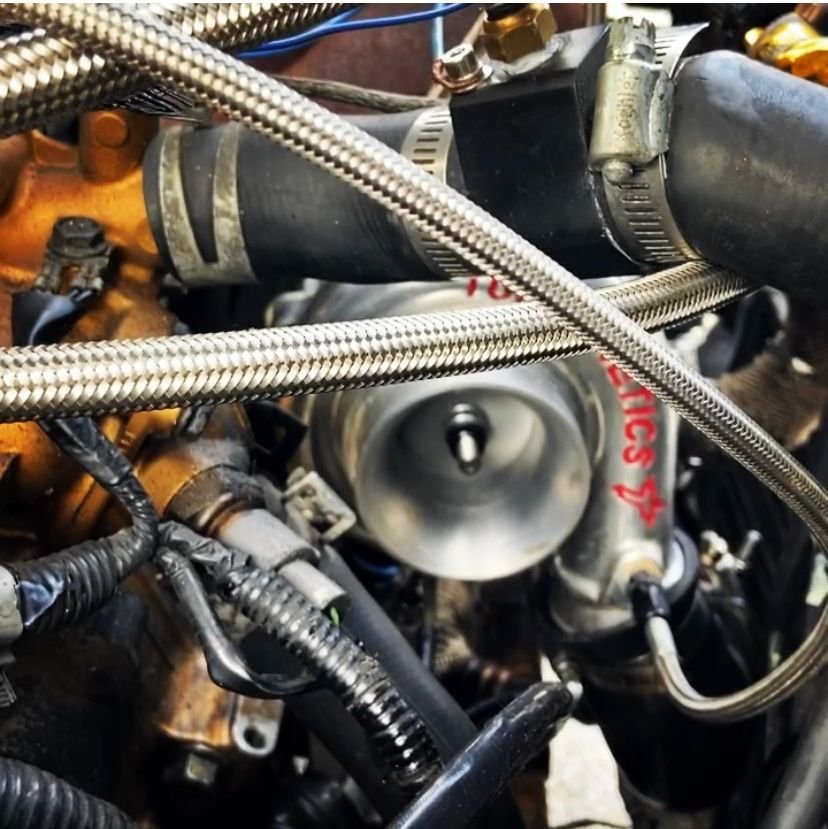

I got some preparations done. Moved the car to the street for jacking and underbody work. Made some headway on the exhaust (see pics) O2 bung for secondary O2 added and bend added to transition following the OEM path of the exhuast.
There she sits in all her glory waiting to be tuned!!

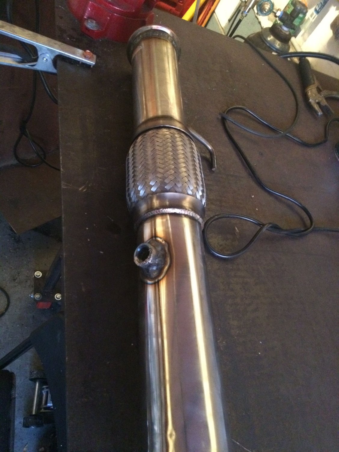

O2 welding
Tubing I am on currently. Hangers, Vband, and Bends must be ordered to continue
I am in the middle of a semester (final one) graduate December. The biggest hurdles left are to finish welding the exhaust (need more V bands, hangers and bends) and tuning the car.
I can breathe a bit more once I can have the exhaust done so I dont have to get dirty under the car and chill out in a seat for once.

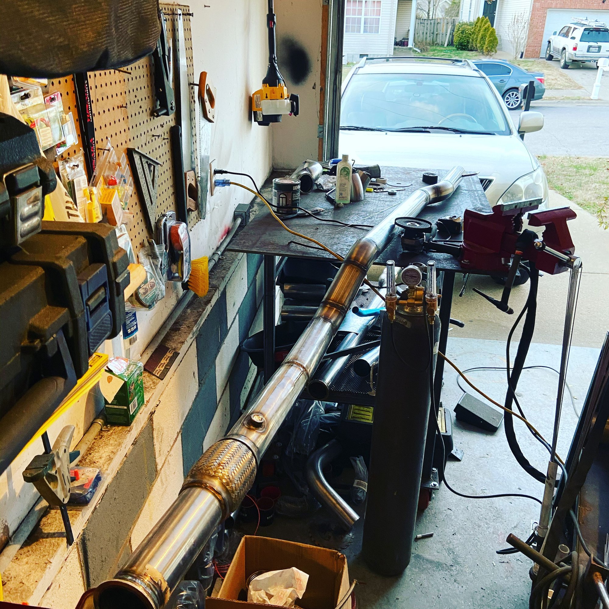

The last time I made progress me and a friend fabricated the entire new exhaust sections, but it sits WAY TOO LOW. So I need to fab up some custom length hangers using traditional stainless rods instead of the Walker Exhaust hangers I used. I will use the stock hanger locations and somehow make it work. The 3in exhaust sits half an in from the ground when the car is lowered onto the ground. So, that will be the next goal; to modify the exhaust system so it sits higher.

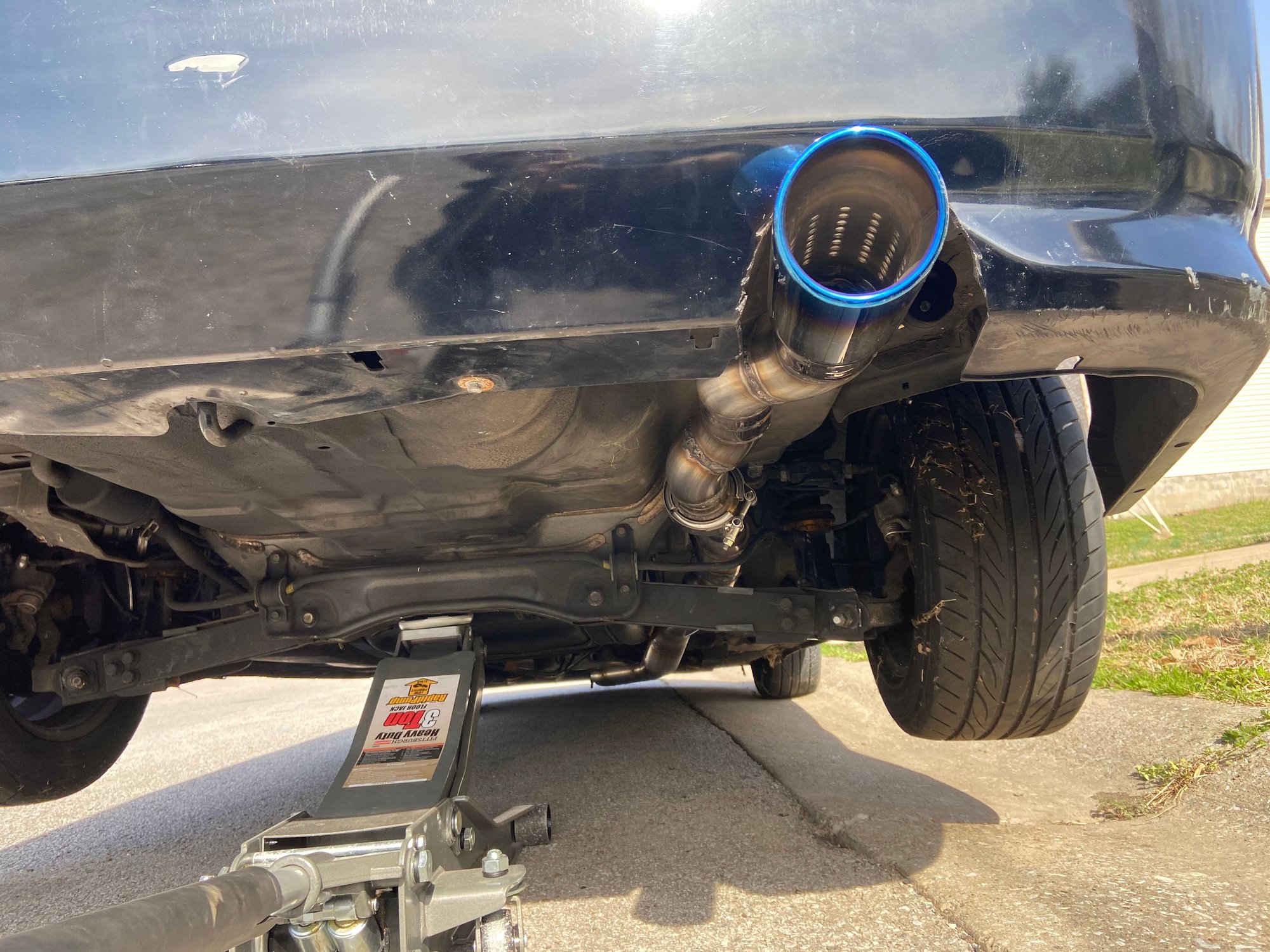

Below is a teaser shot

jesus. That all 3"

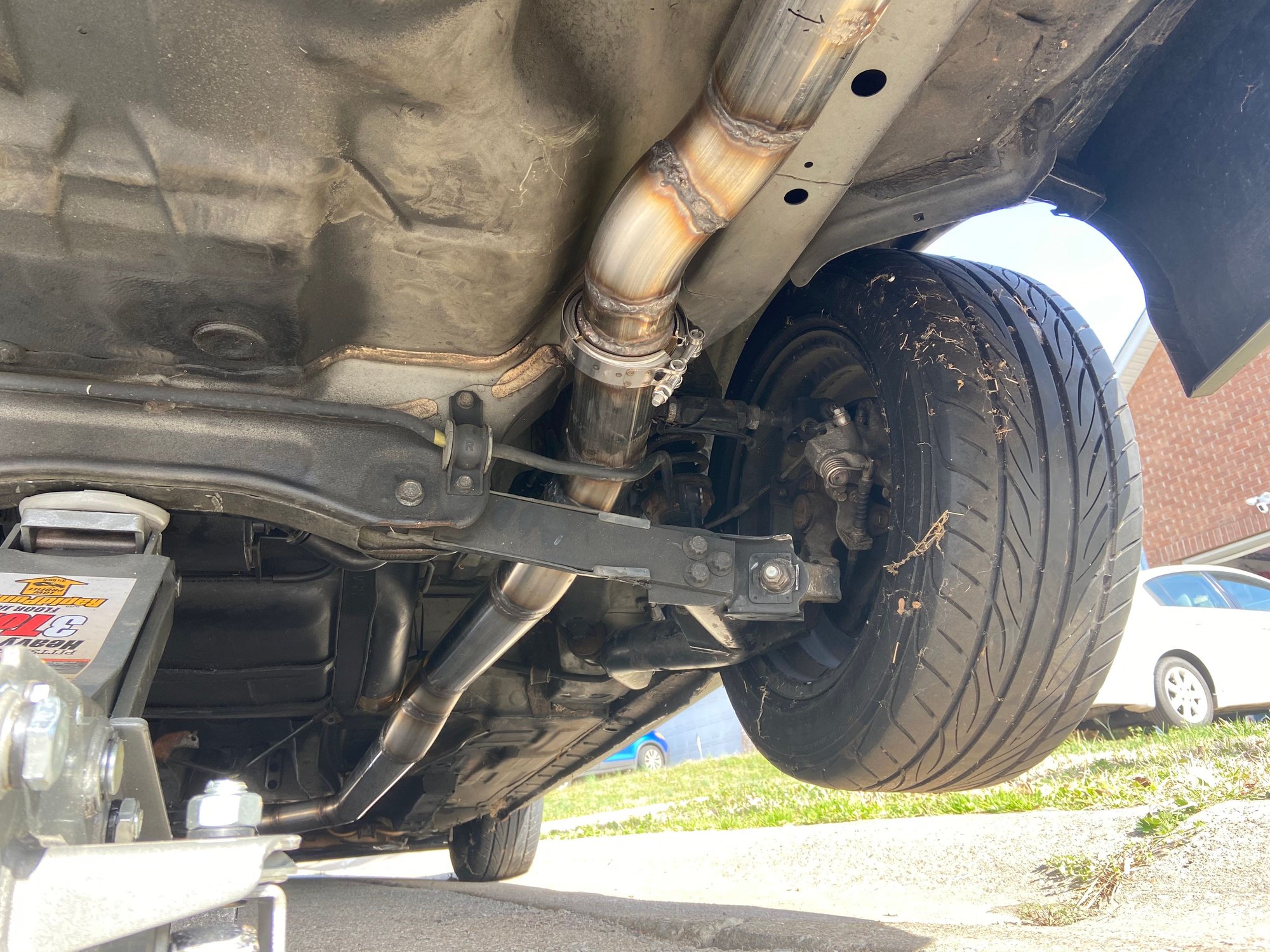

jesus. That all 3"

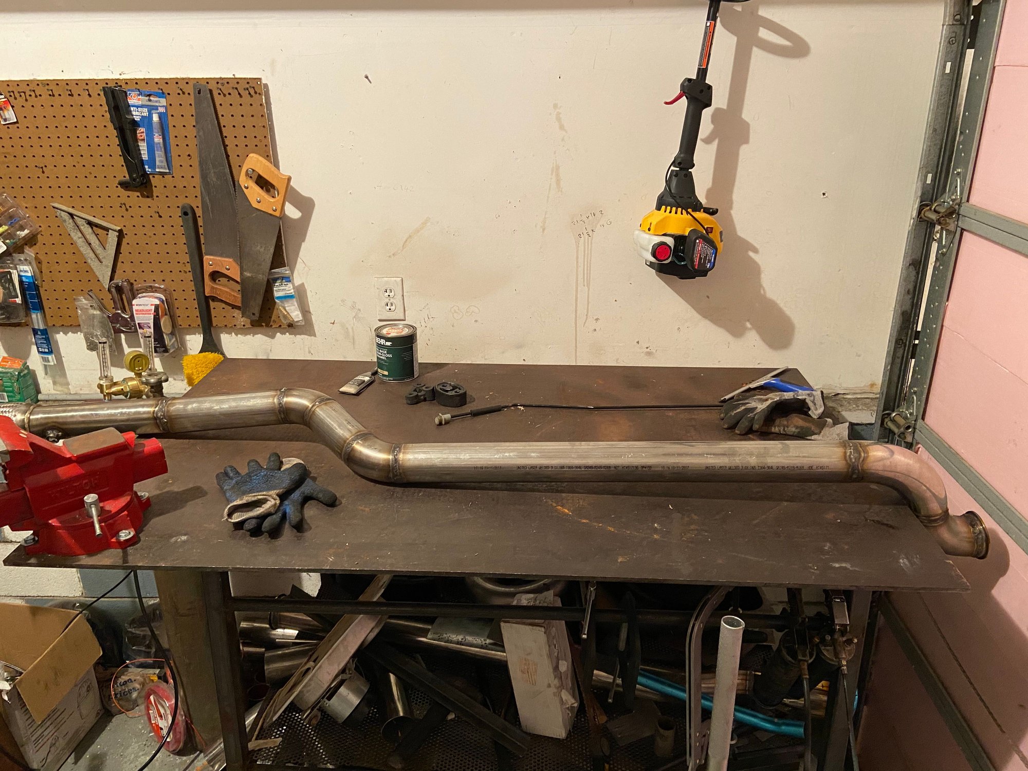

And it got longer....
Got the hangers fixed today!
Just need to route the axle pipe out back and it will be all done.

soooo lotta awesome news so far! lets keep it brief.
-Finished the mid-pipe, now just need to fab up the axle tube about 24"-36" piece, which I have to fab next weekend.
Hopefully my remaining argon gas I used for TIG will suffice before I have to make a long trip again to the welding supply.
Remaining steps

I'm glad I was able to find the time this weekend to get this axle tube welded together.
After many hours, cursing, cutting, and sweating!

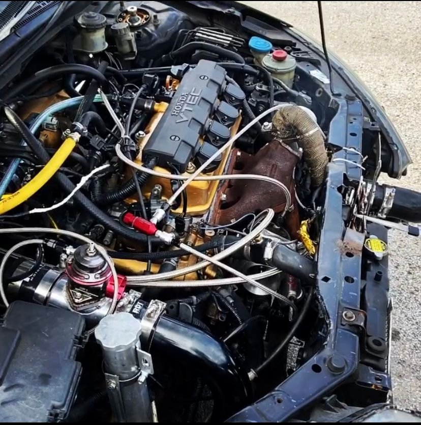

So I finally got the Civic started and running. This morning I updated the ECU and calibration and then I went to start it up. The battery required a good jump start and charge because the battery had become completely depleted after sitting for over a year. (Oct 18' was last I drove her)
What I am glad to see is that there were no leaks of fluids or vacuum.
I did idle for about an hour and burped the coolant. I noticed the idle was really rough until the ECU went into re-learn procedure. Then the car really got to idling around 800rpm which I was super relieved about. The last time I drove the car I had a faulty IACV sensor and it idled sporadically, and after I bought a genuine one and replaced it, I went ahead with finishing the turbo build and crossed my fingers and no more idle issues after over a year! The turbo looks good. I got some minor repairs I have to work out but nothing major. The exhaust note is deeper while idling and sounds much better, and I can't wait to actually rev this D17 engine.
Here is a video if anyone is interested.

Just a little teaser before I actually get this vehicle tuned properly and on the road.
Cool engine bay shot.
