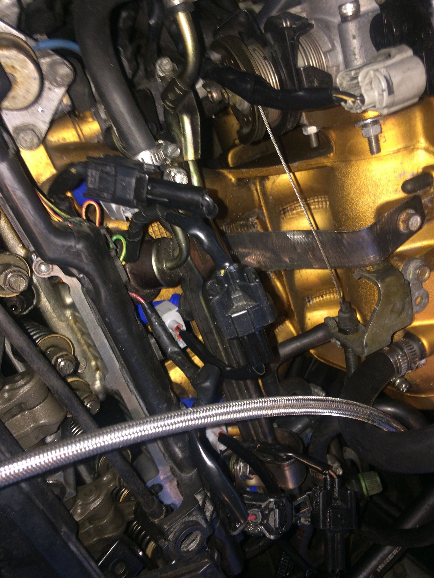

Sup fellas.
Spring break started
Came back home

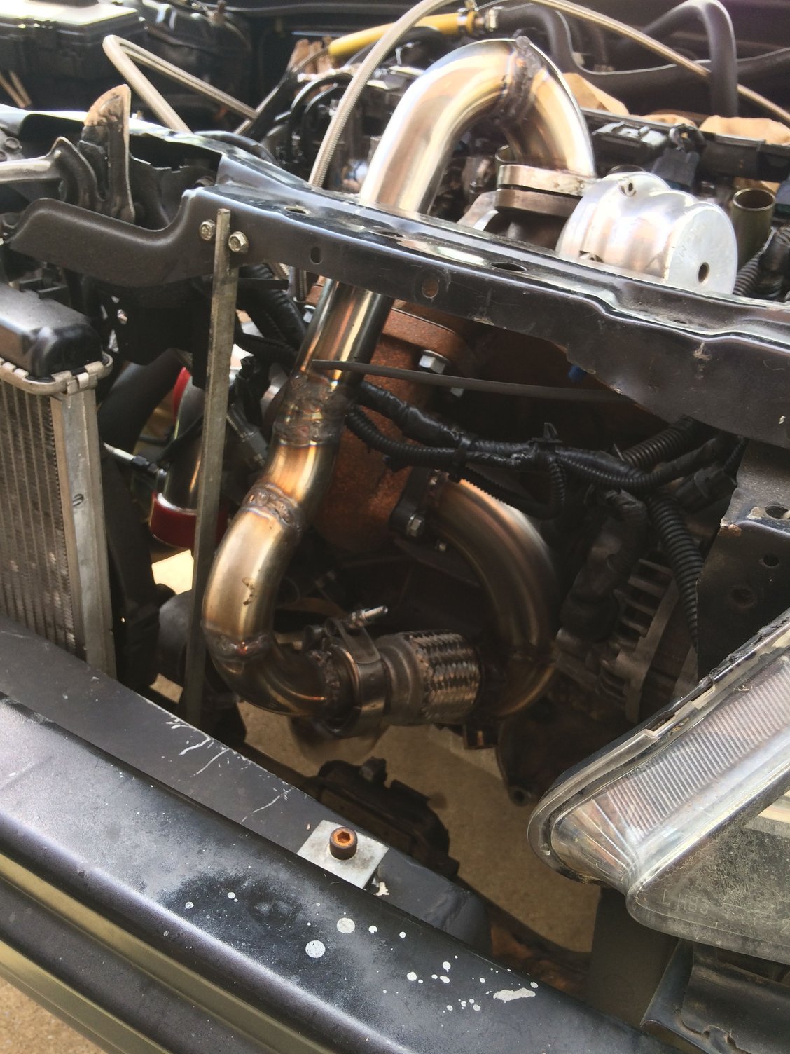

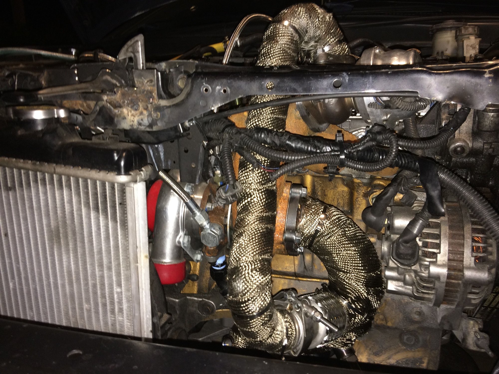

-Turbo manifold installed
-Vac manifold installed
-Turbo coolant lines installed
To do list
-Get real RDX injectors (I got ripped off on ebay 2 years ago and didn’t find out til today -_-)
-plumb oil lines
-run lines to BOV/WG/Boost cont from vac mani

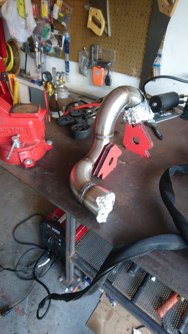

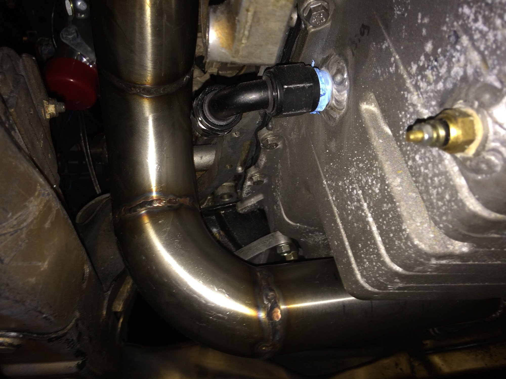

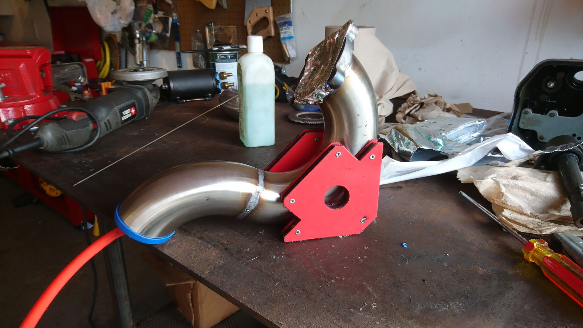

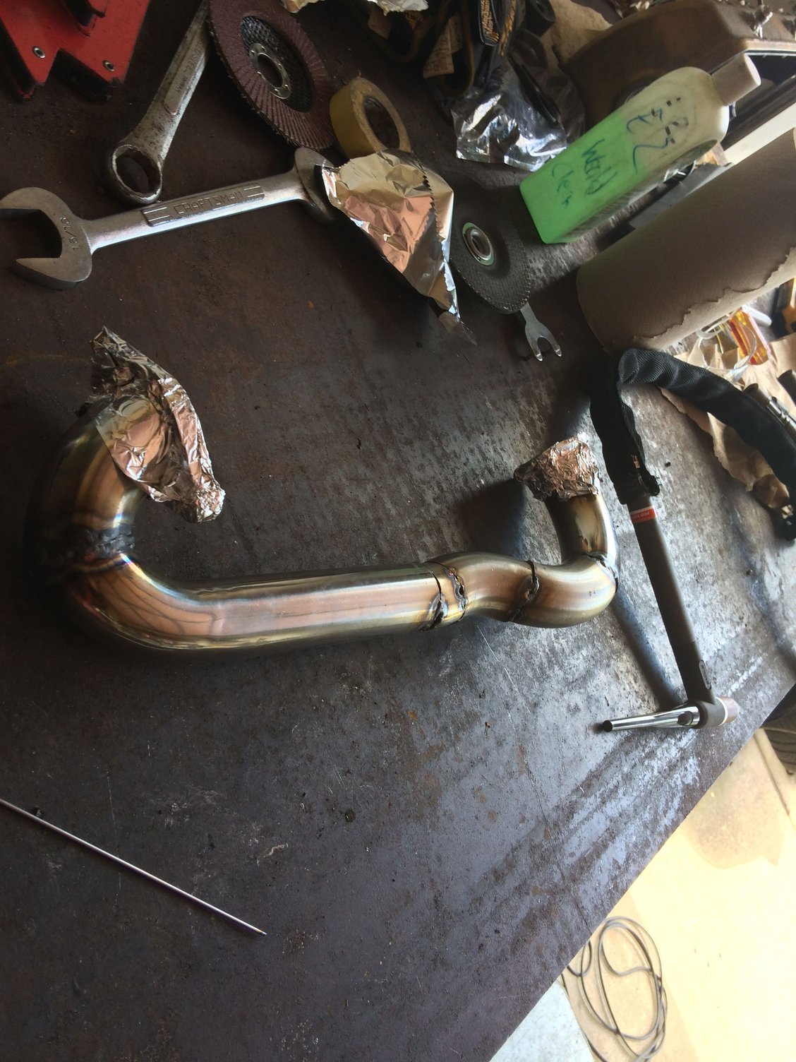

Today I fabbed up the downpipe from the turbo to under the oil pan. More stuff has to be done to the downpipe thought see below..
I ended up going with a 2.5" downpipe and plan on transition to 3.0 once under the oil pan.
2.5----> Vband for removability-----> transition------>3.0 straight pipe to axle (rest Ill fab later)
Grind the end flat again
Determine whether to use the 45 2.5” elbow or go straight to a transition?
Mark/Drill the tie-in for the waste gate pipe
Tie in the waste gate dump-tube make it removable
Weld the two bungs for O2 upstream and AEM wide-band on down-pipes
Clean the down-pipe of residue
Wrap the down-pipe and waste gate tie-in with heat wrap
Now we are done with top-side of exhaust
For the next assignment
Install waste gate plumbing to boost controller
Tighten down the coolant turbo banjo bolts
Mount the E-Bay catch can and run the appropriate lines one from VC to IN side and one from OUT back to the charge pipe before the BOV
Install the fuel rail with new hardware and brackets as well as 410cc injectors
Flush the coolant system
Pour some leftover oil into VC, drain, and empty it back into a dirt oil container to clean the water/oil mixup out the engine from sitting so long
Fill and top off the coolant system
Add oil to engine and install filter
Run the AEM wide-band gauge wiring to KPRO unit and solder the wire to the pin
Gap the plugs to .030 and install new ones in
Wire-in all the gauges professionally this time
Check FMIC plumbing to see if it can be done with current bumper bar and install FMIC piping
Buy a used valve cover, sand it, prime it, paint, clear coat, install it
Wash the engine bay and shine it
Absolute last thing I want to do:
Update injector size to map on pro
Rest of exhaust setup (bring car down from hill)
Tune (tow or drive hmmm)
When all goes well….. add the sub/headunit again and fix up some of the electric work

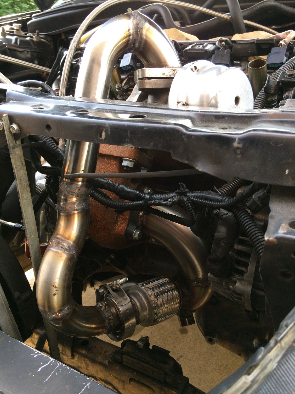

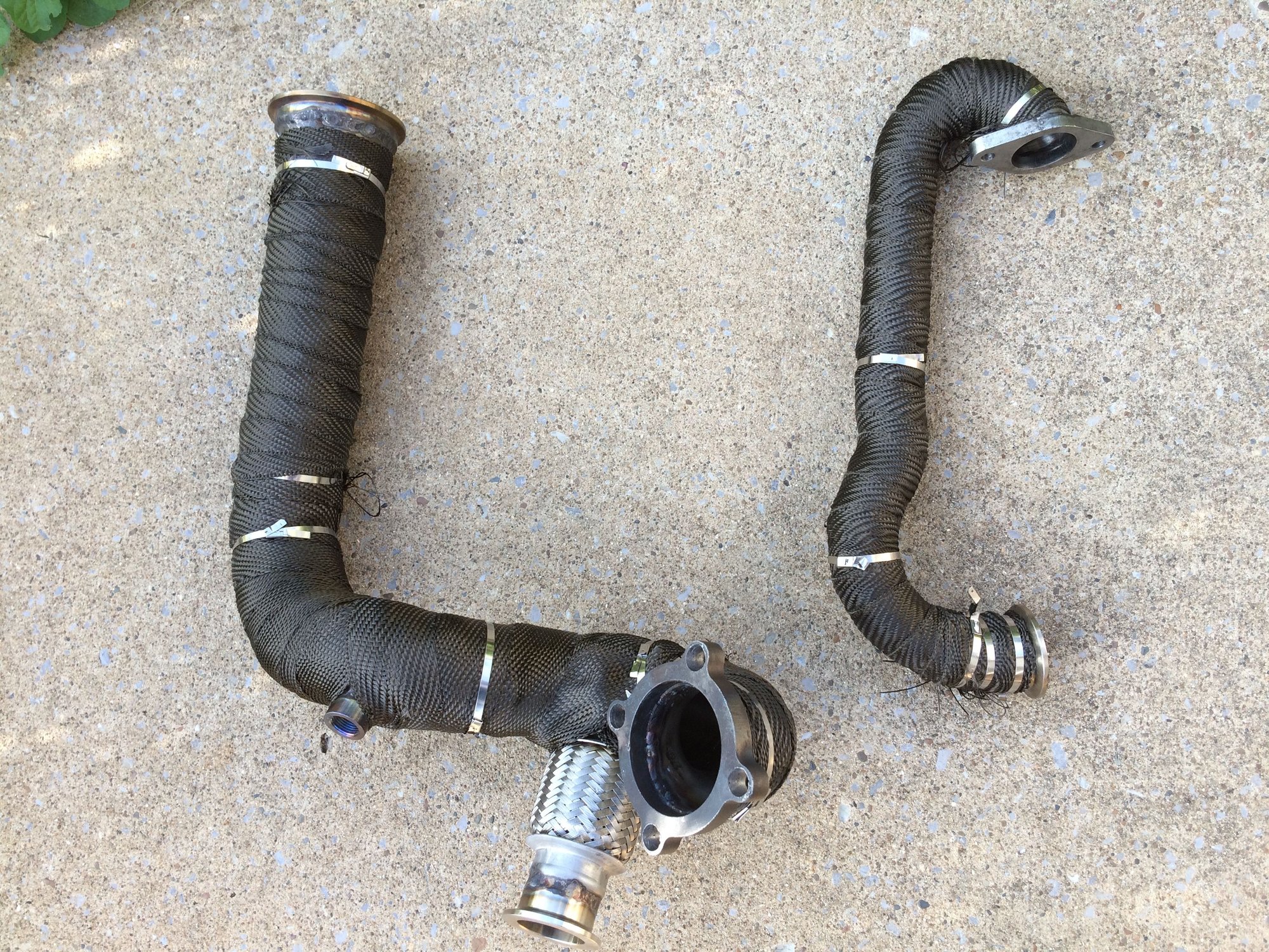

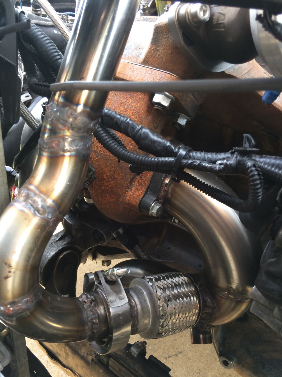

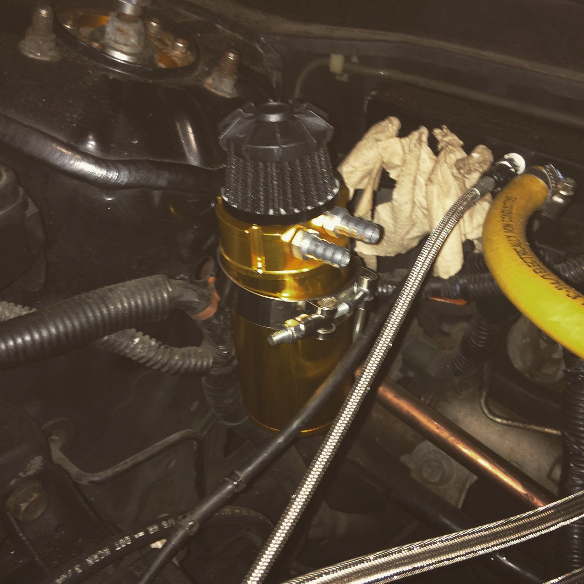

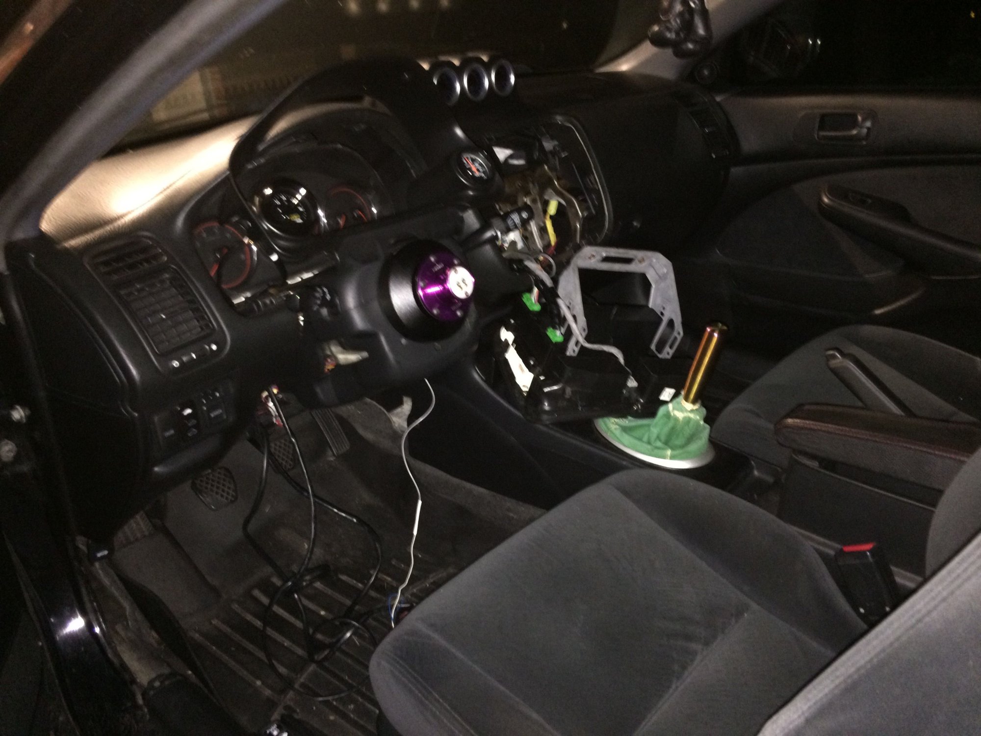

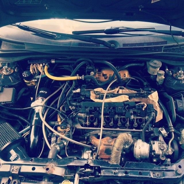

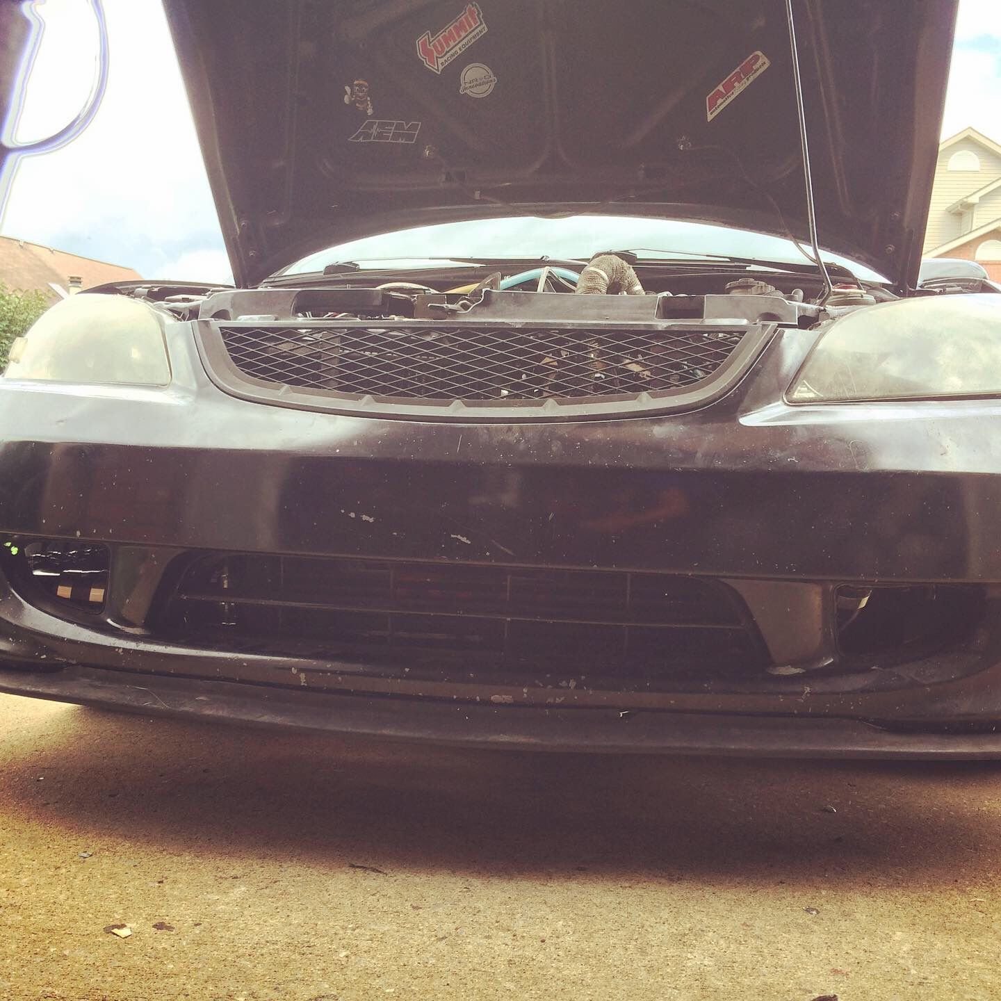

For those who may be wondering what happened to updates, see pics below. I have been extremely busy these past few months with finishing my spring semester at uni. (senior year aka senior design for engineering) (MY TEAM WON TWO AWARDS!!!!), getting ready for my internship which I am now in, and moving to my new apartment/making some side hustle moves........ and April was a crazy month for me, but I still managed to put in overtime and keep the dream alive for those wanting to boost their stock EM2. Keep in mind I drive 3 hours to Nashville to come do this work every now and then, but summer is opening my timetable up and this project WILL be completed by the end of July.
I will do a lesson's learned post at the very end of the project to simplify what to do and what not to do if you plan on following in my footsteps, so look out for that.
It has been an extreme challenge to procure the materials, the welding supplies (had to get a dual flow regulator/refill my argon/timing was critical), and schedule to go ahead and fabricate the downpipe and dumptube together, but it is finally complete. That was my major hurdle for this project. Now, the following remains:
Install waste gate plumbing to boost controller (waiting on AN to M5 fittings to come in early June)
Order the E-Bay catch can and run the appropriate lines one from VC to IN side and one from OUT back to the charge pipe before the BOV
Install the stock fuel rail and the 410cc RDX with new hardware and stainless brackets (gonna have to handwork some brackets to mount the fuel rail)
Run the AEM wide-band gauge wiring to KPRO unit and solder the wire to the pin on the board (gonna have to research the pin to use)
Gap the plugs to .030 and install new ones in (per PianoMan55's lessons learned)
Check FMIC plumbing to see if it can be done with current bumper bar and install FMIC piping (not really concerned on removing the bumper rein. as I wont daily the car every day)

Re: Erf's Low Boost Build (Stock Internals)
looking good
Some of those welds look awesome!
If you don't me suggesting, since you are running what looks like a gen 6 radiator, you can always do some cutting on the upper radiator mount. I personally would get rid of the top portion from your dump tube to your gate valve for some extra clearance.
pic attached...
Maybe get rid of the area in blue for some extra room...
after i took a closer look at that pipe...will your hood be able to close?
Yes, of course I tried the function of the hood closing before tacking them.
I'm keeping the radiator support even if the fan is out of the way because it ties into the hood latch and provides structural support. Without it the hood latch would flex downwards too far. I could cut it out and weld a piece to connect the latch piece, but thats too much work.

Whats up boys so quick update
-Fixed dumptube Vband off center misalignment issue by cutting some material off the dumptube where it mated to the vband flange as it was a bit too long
-Re-wrapped dumptube
-Got the downpipe and dumptube bolted in and ready
-Fixed misc. unrelated to project items that (e.g. replaced hood latch cable, welded some reinforcement in hood latch area)
-AEM is now hooked up to KPRO. Kpro V4 is what I have and is the latest as of 06/23/19 (for anyone wanting to buy it, Kpro V4 came out in 2015 I believe and is still the latest board)
KPRO V4 requires no soldering to the actual board itself. It has a wireharness pigtail you solder to one of those wires
I have attached the color code for KPRO V4 (V4 only!!!!!!) for all the analog inputs. With my AEM GAUGE, I have to run a chassis ground and not a analog ground, so pay attention if you pursue.
-New colder plugs are in (see image for model number of NGK plugs

new catch can. setup will go from valve cover to IN port, then from OUT port back to charge pipe before BOV
Finally finished the dumptube, (had to take some material off to make it sit flush with the wastegate flange and line up the vbands on center but it FITS LIKE A GLOVE!!! shoutout to OJ... well.. not in his case Gloves were too big hahaha
Black and gold! Intercooler tubing next. Finally fixed that annoying hood latch weak area by welding some steel to reinforce the hood latch member on the radiator support frame. Having hood closing issues due to dumptube (shave time)
Just wiring and soldering. Finally got AEM analog wire soldered to the analog input off Kpro V4. Just use the RED wire thats A0 coming from the inside of the ECU.

FMIC tubing installed
-Removed crash bar
-Removed some chassis frame material from areas where tubing meets intercooler
-Mocked up the tubing
-Made some cuts
-Need to order 2in to 2.5in couplings to finish compressor discharge hookup
-Need to relocate coolant reservoir to near the catch can
-Need to fab up stainless brackets for FMIC to connect to front chassis
-Need to grind off some of the hood where the dumptube bends upwards to clear
-Need a good solution to brace this turbo/manifold as heat and weight will be an issue for the head carrying all that weight on one side. (Fab up a triangle bracket? hmm)
-Put the valve cover on
-Fluids fill
-Gauge wiring and routing
-Heat tape on exposed/high heat areas/wiring management
-little sh*t left to do before we can get Nicole on the ground and get the tune date setup!
-Stay tuned fellas.
Thankfully the ebay FMIC tubing kit had ALL the bends I required (plus treadstone 3 in to 2in couplings for turbo compressor 3inlet i ordered seperately. RDC motors makes the ebay FMIC kit I bought it for like 100 bucks ebay two years ago! It was sitting in the attic and I have finally installed it.
Some good shots Currently awaiting the coupling to convert the compressor outlet 2in to 2.5 to make the tubing complete.
that battery relocation really helped me I need as much space as possible

updated bay
fule rail and injectors snapped in (no mods) custom fuel rail brackets from Stainless Steel
Aluminum welded custom FMIC brackets I made :-)
It's my birthday today gang!
Verified the bumper fits, made some mods.
Goodbye fog lights, hello FMIC tubing!
Got some new shots of project. Coming together smoothly now.
