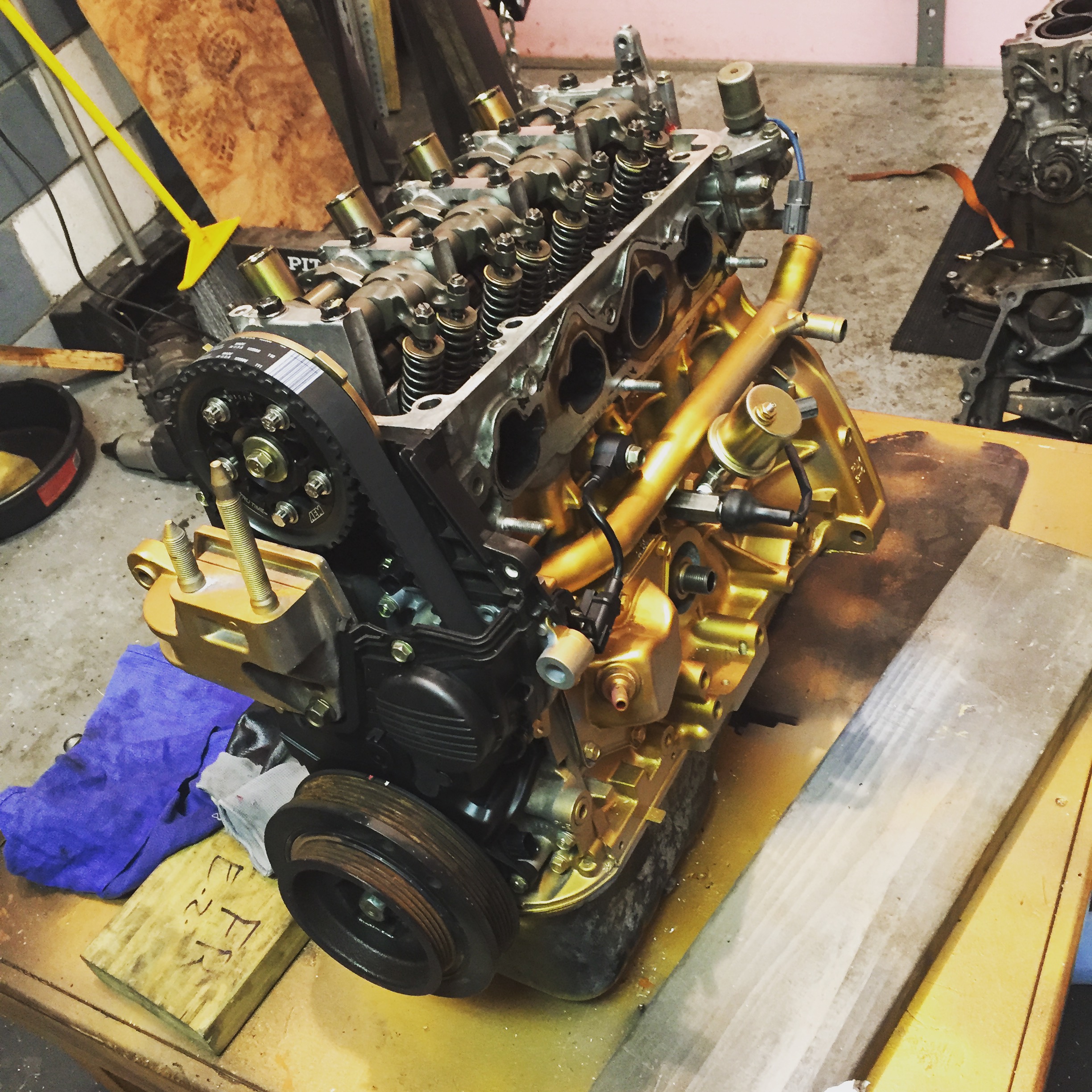

Hello and what's good 7th gen community?

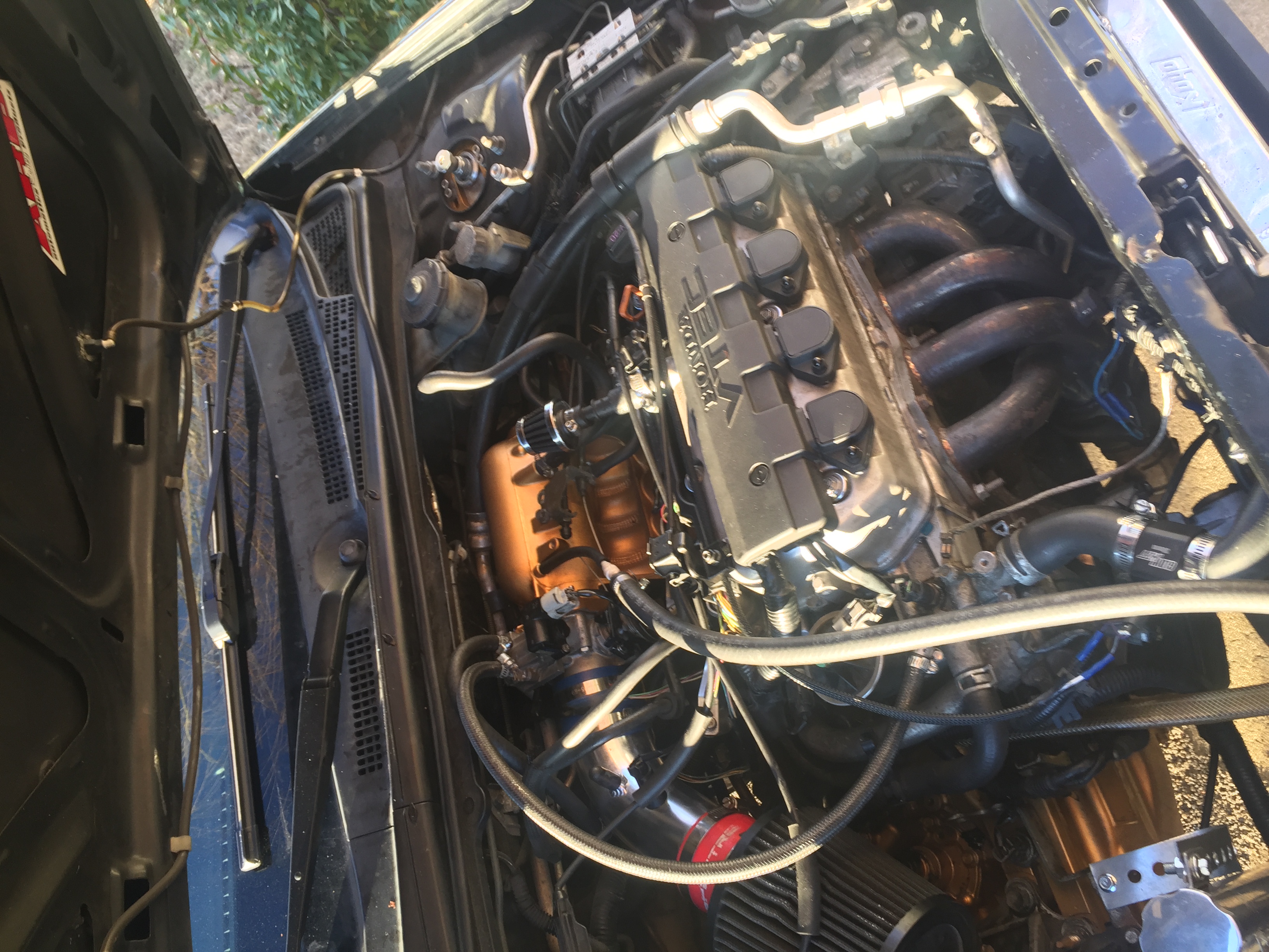

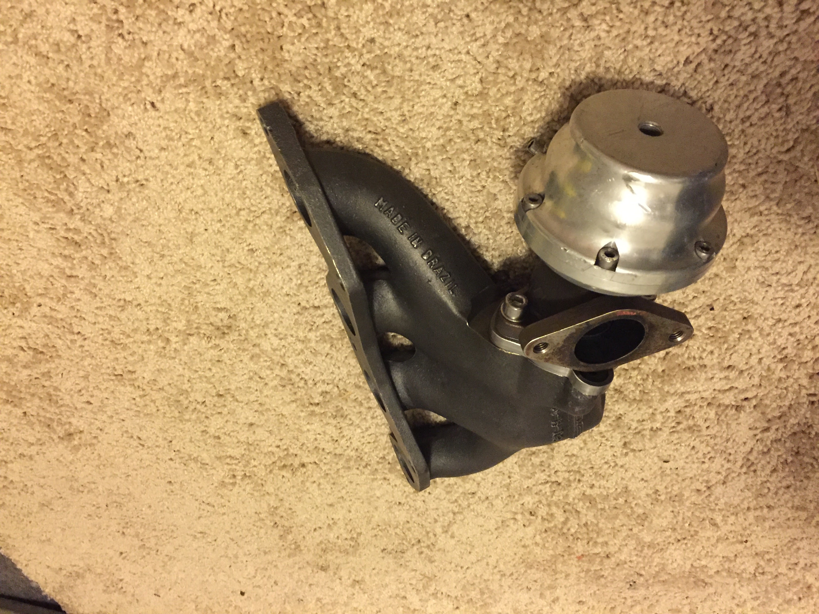

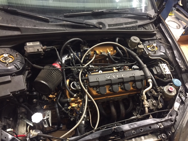

I have been working on this custom turbo kit collecting parts and preparing the car for the past 2.5 years. To be honest, doing the work myself, and learning all this from a Haynes Manual and the community here has been a hell of an experience. Now that it is near completion, and things are almost one, I have decided to share the information with interested EM2 Owners who also would like to go the turbo-route against the K-swap or buying a new car.
As most of us know, the d17a2 is an infamous engine that does not respond to bolt-on modifications such as : a 4-1 header, cold air intake/short ram intake, and or a catback exhaust system. With a good turbo setup designed for lower RPM spool-up, the EM2 can be a fun, light, and good looking car to daily.
To those on a low budget and looking to increase performance from their EM2, just getting started and would like to see a turbo build, and/or would just like something cool to follow, welcome to my build.
Turbo: Turbonetics T3 .63 AR Super 60 Trim 3in inlet, 4 bolt discharge, ceramic ball bearing, water cooled 16mm

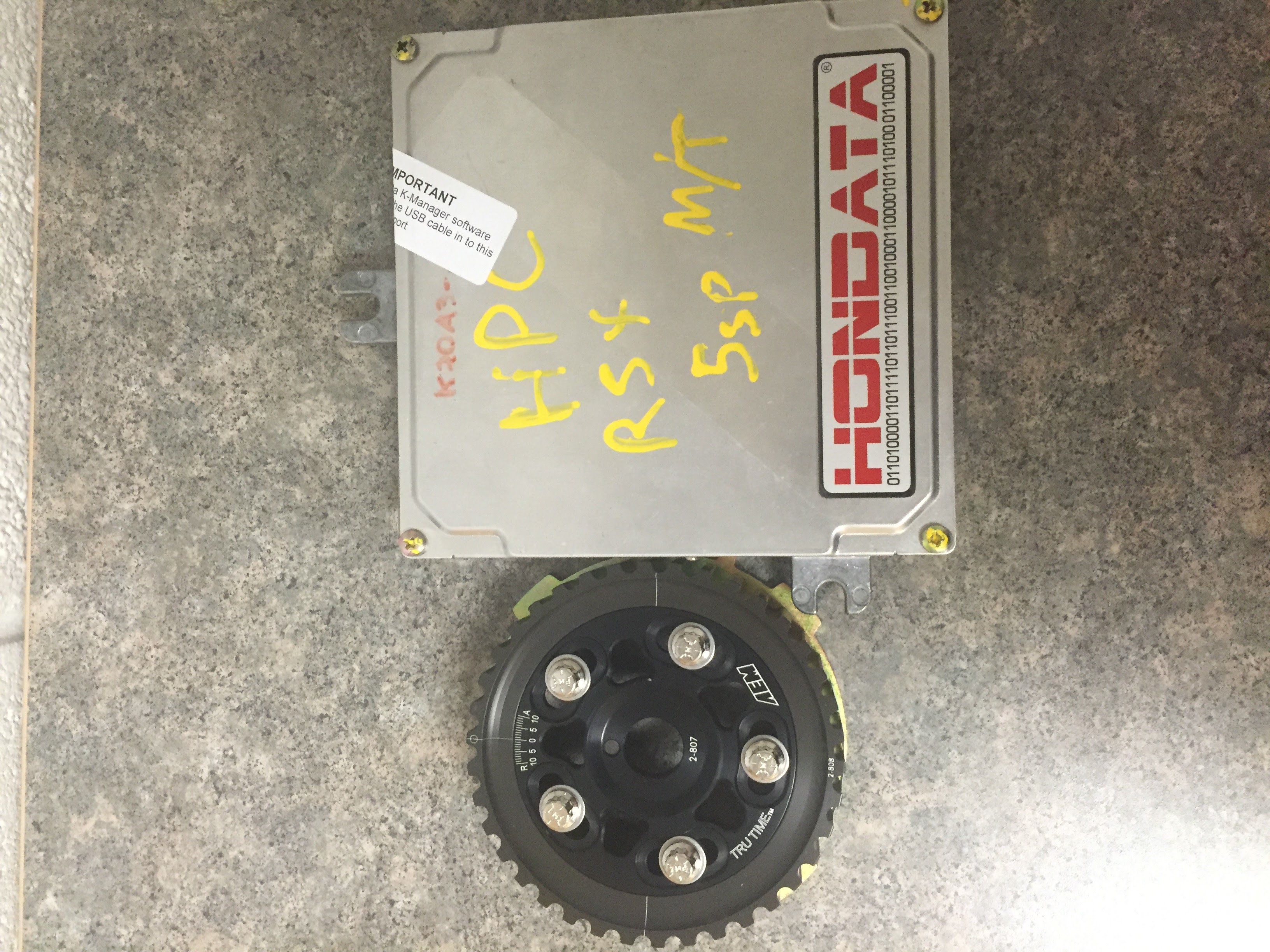

ECU: Hondata KPro
Intake: D16y8 Manifold

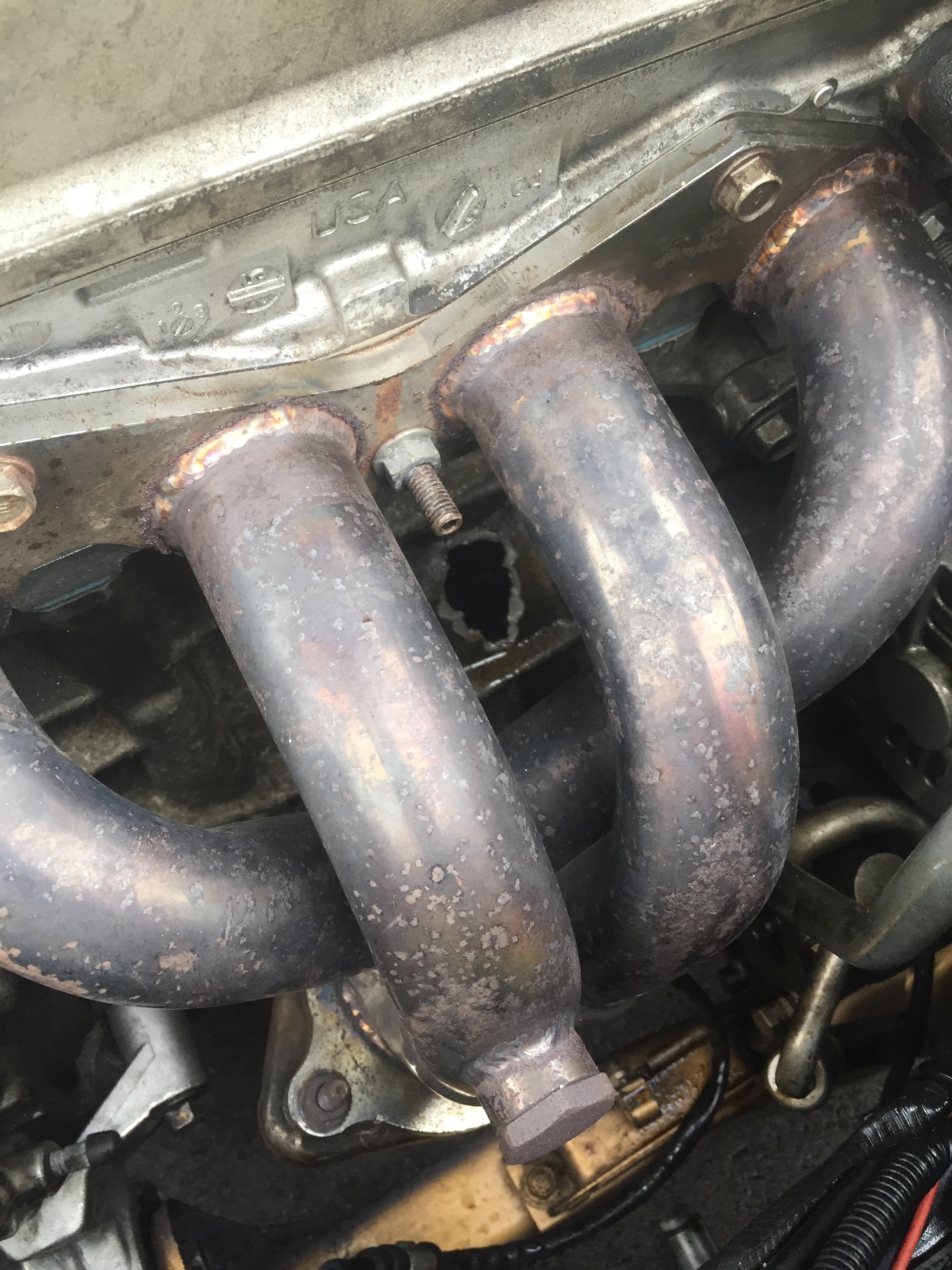

Turbo Manifold: SPA Turbo Cast Iron Manifold 38mm WG top- mount
Downpipe: CXRacing Driverside 4 Bolt downpipe 2.5"
Dumptube: 40mm Ebay Dumptube SS
Wastegate: Used Turbonetics F38 from eBay with 5psi spring
BOV: Used Greddy Type FV BOV from eBay, genuine
Intercooler: Ebay (black piping) I like stealth.
Muffler: Vibrant Street Performance Muffler Black
Resonators: Two Vibrant UltraQuiet Resonators 2.5"
Fuel: Stock fuel pump, 310cc RSX injectors

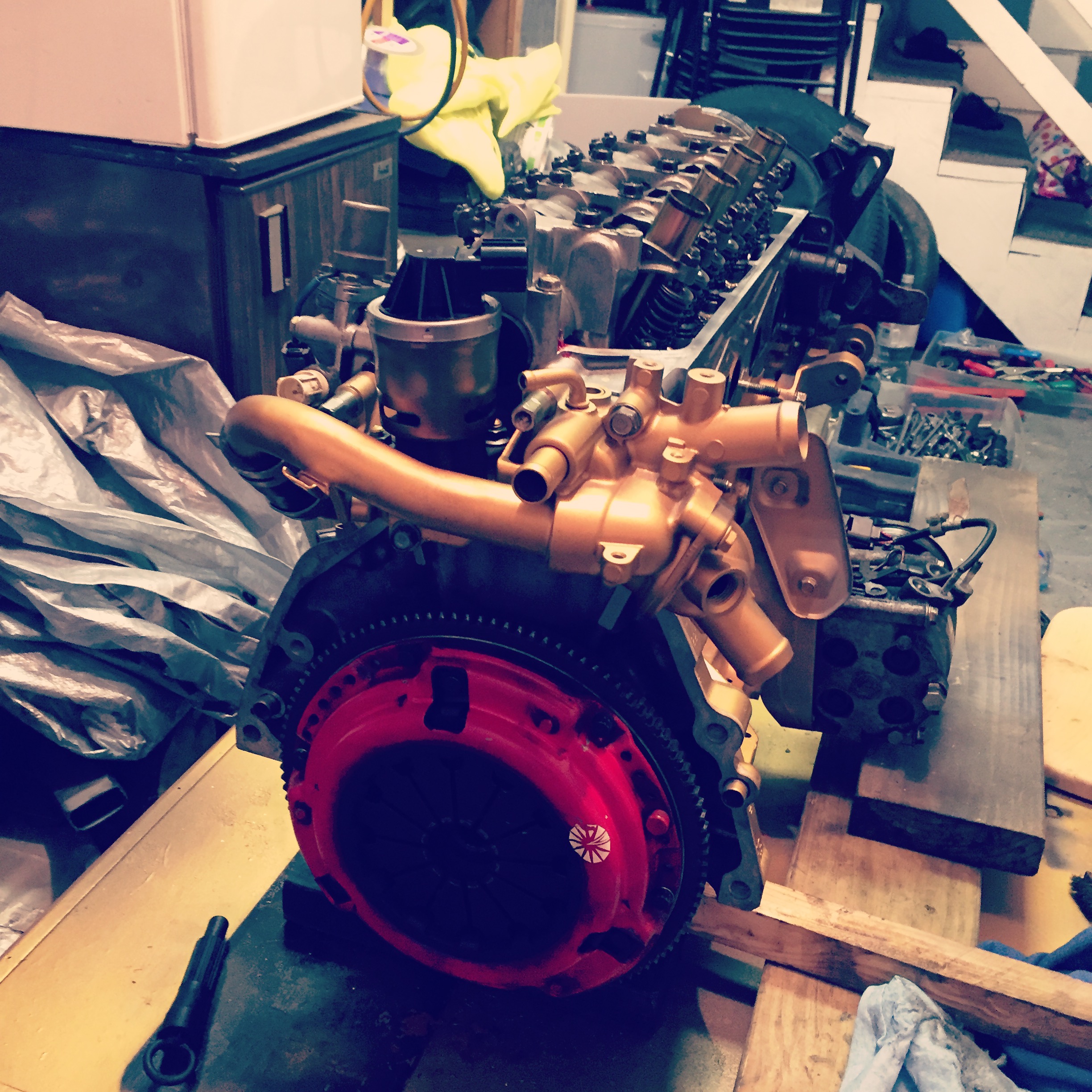

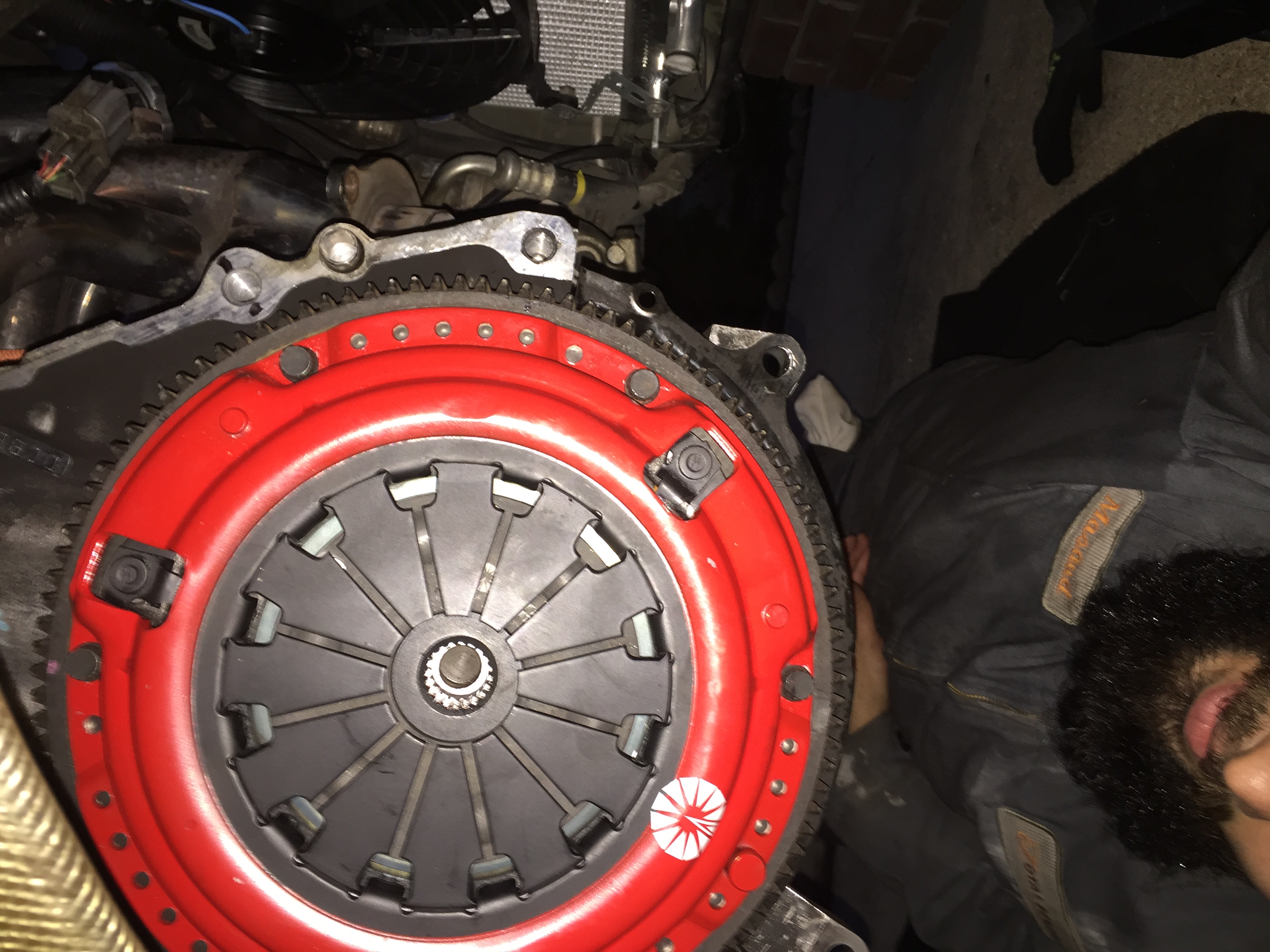

Clutch: Action Clutch Stage 1 Organic
Head: AEM cam gear, ARP head studs, new headgasket, timing belt, tensioner, water pump, valve cover gasket,
Suspension: ISC Suspension Coilovers, SPC front camber bolts, SPC rear camber arms -2.5 camber all around, maxed out rears, 1/2in from maxed out front
Brakes: EBC USR Slotted Rotors, EBC GreenStuff 2000 Brake Pads

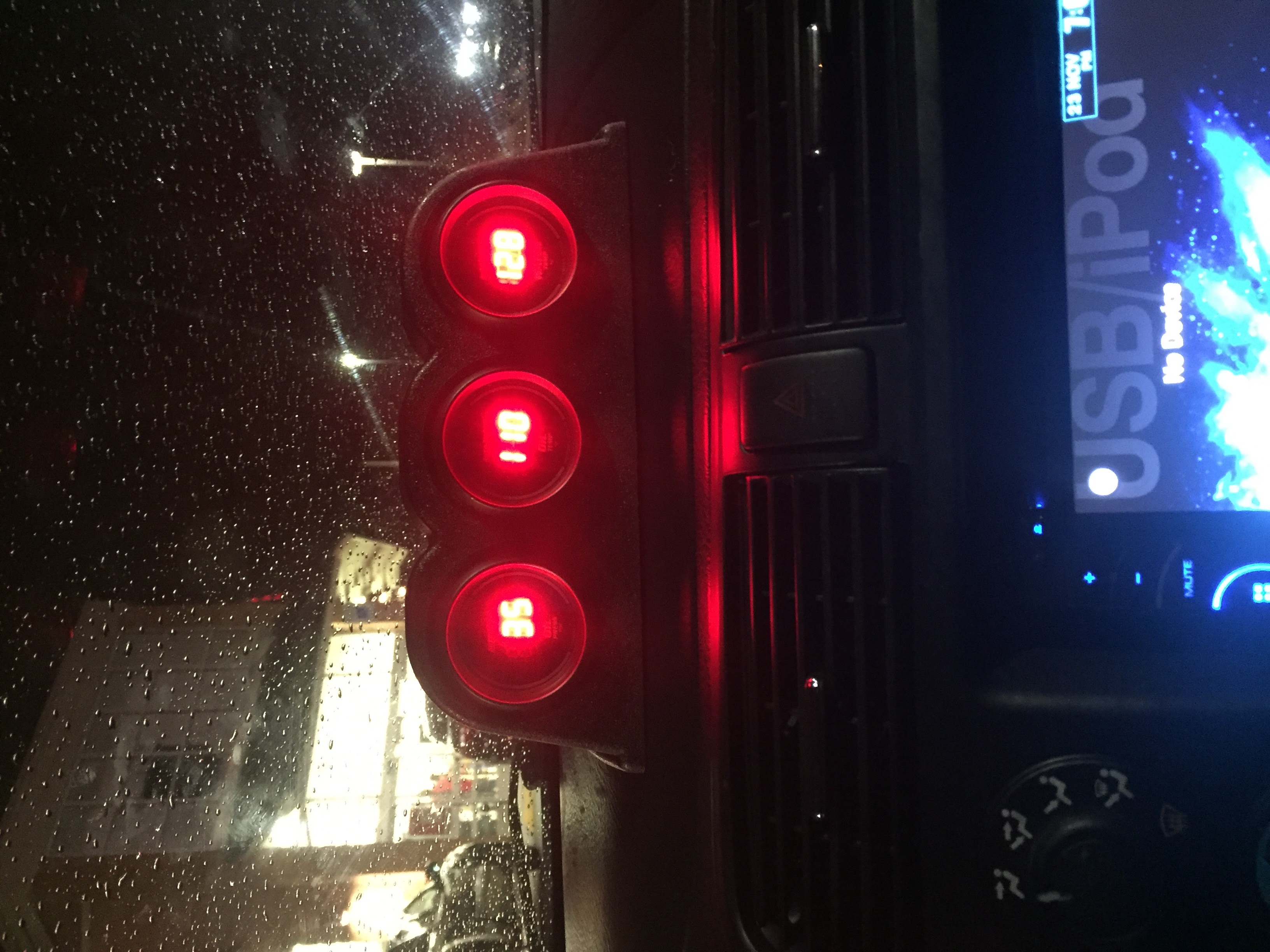

Gauges: AEM UEGO A/F, Autometer Mechanical Boost Gauge, Autometer Digital
Oil Pressure Gauge, Autometer Digital Oil Temperature Gauge, Autometer
Digital Water Temp Gauge

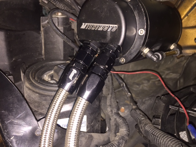

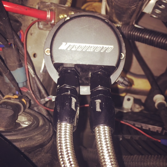

Oil system: Mishimoto Oil Catch Can
Cooling system: Koyo High Performance Radiator, GodSpeed slim racing fans 10"x2
Battery: Relocated to trunk homemade kit
Tires: Nexen 195/45/16
Wheels: XXR 536 16x8 +20
The A/F gauge and the boost are not wired to power. My oil pressure, oil temp, and water temp gauges are all installed and working.
Oil pan is tapped and prepared for the 10AN return.
I have all the parts to my turbo kit.
Pretty much the only thing left to do is get the turbo kit installed, tow it to a tuner, and get it tuned. Before I do that, I would like to take a couple of months to do final research and get everything finalized. I'll get it installed and tuned in the summer.

You gonna run an oil catch can in your PCV line or are you just gonna convert it to AN/stainless braided lines?

I forgot to mention I'm currently running a Mishimoto oil catch can. It's pretty clean looking in the engine bay. Considering I paid $90 bucks for it, I might as well get rid of the shitty rubber lines and put black AN lines on it.

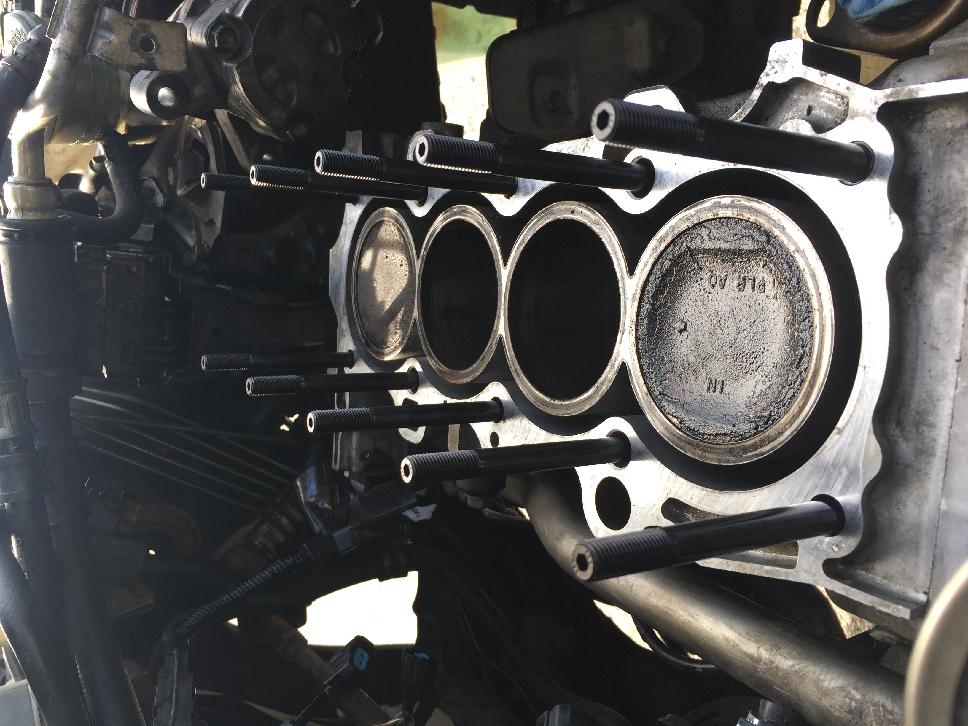

Need a used short block. Engine threw a rod on me yesterday. Low oil. Knew I shoulda have fixed that leak. Looking to get her up and running by next month again. DAMN! Just when I had bought some cool aluminum shifter bushings to test them out. Haha

I have one laying around.. but all the internals are all rusted to **** (and very likely seized in place) and it'd cost hella to ship. lol
How it always happens though. You get some shiny new stuff, and something big goes wrong

BTW when you threw the rod did the piston by chance hit the valves? Hopefully you didn't bend any valves.
I don't know. I am taking the head off to inspect it. I found a couple of good long-block deals, so I might end up going that route if the head is damaged.

If only I had not ignored the darn oil leak. I had re-installed the pan with RTV but the return bung blocked a bolt hole so I had sealed the hole with RTV sealant but it didn't work well. I think that is where the leak came from and eventually led to me having a thrown rod. Ran on low oil for two weeks. Not sure if the head is even in good condition.
But like I said once I get the head off, and inspect it I'll make a decision on getting a new long-block or going with a short block.
By the way is re-using a headgasket a good idea, considering it is only 1 years old?

New engine in. Runs fine. New shifter bushings solid.
just needs a thermostat.
FIY: Moved over my a2 vtec solenoid and oil pressure switch over to the d17a. Used the old AC compressor, (Japanese one has single wire.) Kept old power steering and alternator.
I have a steel oil pan now. It doesn't have the two stiffner brackets. I got the bungs brass welded on there. MIG welding was going to blow a hole in the steel according to my welder.
She works just fine.
Does anyone recommend running 93 octane? The compression rationis 10.5:1

Updated photos.
-FYI used VHT engine enamel to paint the engine. Sand 220grit, degrease with Gunk/wire brush/water, Prime, Paint, Clear.

It's that threaded port shown in the image I just linked to on google.
I have to drain the old fuel and put in some 93. It has like 10 gallons left in the tank!
note to anyone doing a y8 swap for their intake. For the hoses going to the TB,
Never buy Advance Auto Parts coolant hose. They are weak and can't stand the heat! Get some aftermarket high performance coolant hose.
Things left to do:
Replace two coolant lines
New thermostat
Burp
Fuel swap
Valve lash
Freon
Alignment
I can't wait to see how she pulls. Btw I stayed with the OEM cam. I can pop in a new cam in one days work. Ive become pretty good at disassembling the engine head even with it in the car. Money was short.
