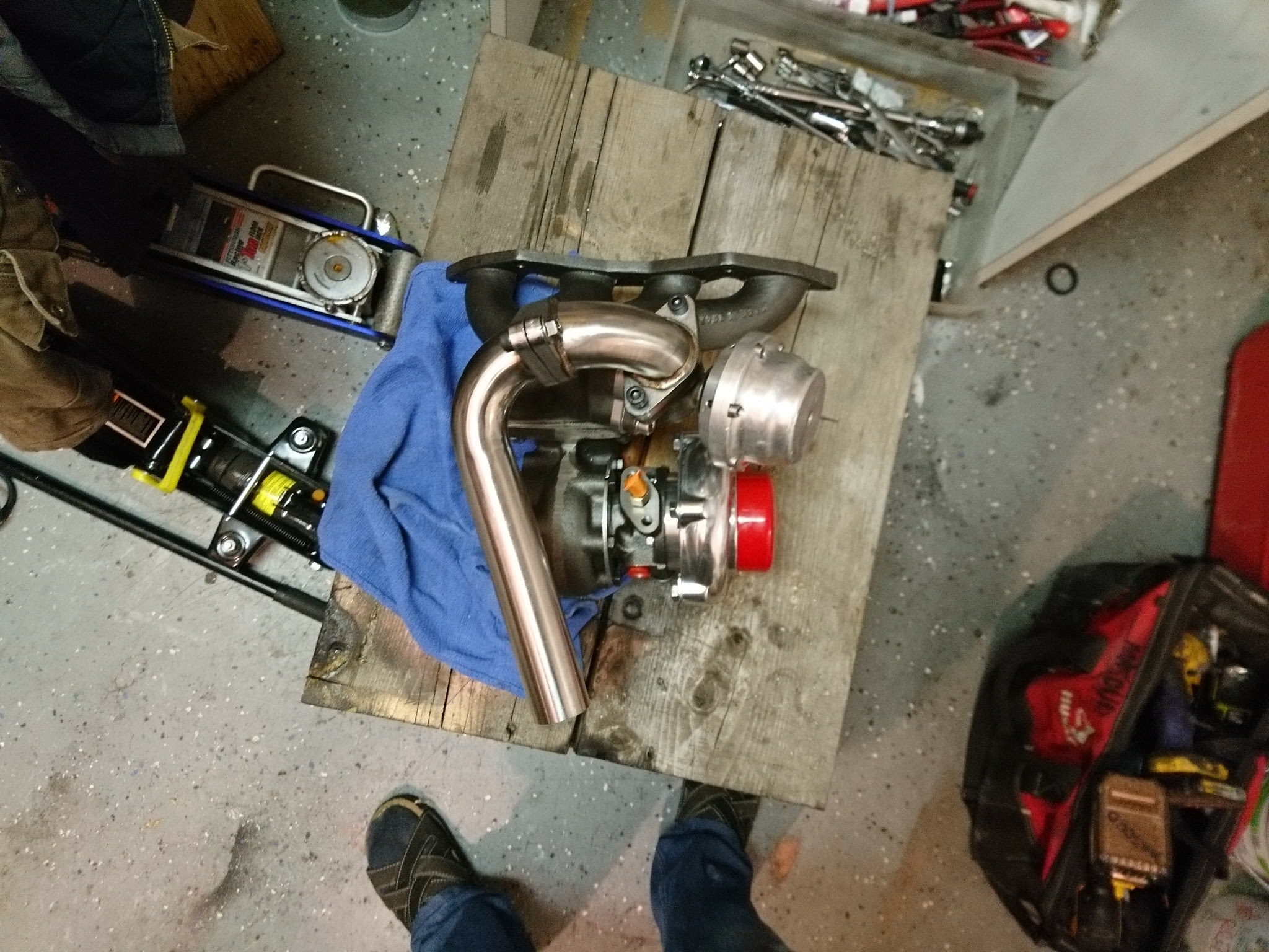

I got the manifold mounted to the turbo. I got the return flange put on. I want to test fit the mani to the car to see if my ebay dp clears the subframe

  #77
Erf_Em2's Avatar
Joined: Nov 2013
Posts: 192
Likes: 9
Rep Power: 155
Erf_Em2 is a glorious beacon of lightErf_Em2 is a glorious beacon of lightErf_Em2 is a glorious beacon of lightErf_Em2 is a glorious beacon of lightErf_Em2 is a glorious beacon of light
Re: Erf's Low Boost Build (Stock Internals)
one potential issue: downpipe clearance

yup...but that looks pretty!!!
