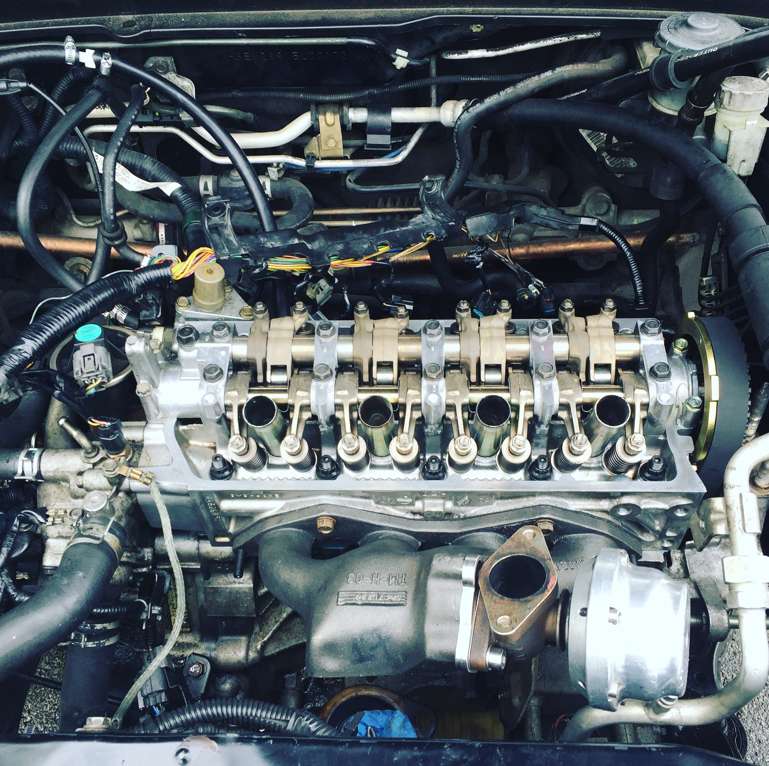

*Update*
The PCV valve was clogged, changed that, I had to replace the oil pan gasket, again because I overtorqued and broke the seal last one I had. There was a double gasket under my oil filter leading to another leak. Fixed all oil leaks. NRG Steering wheel added. Man... having an oil pressure gauge is cheap insurance, you can have low oil and not even know it.
Car runs great, just needs new tires. I hate my current wheels, plan on going with some Nittos and 15x7 RPF1s and ditching the stance setup after boost is on.
Estimated time until I boost the thing finally: 6 months.
Right now, I am busy with school, been focused on work too.
Check the update photos I attached.

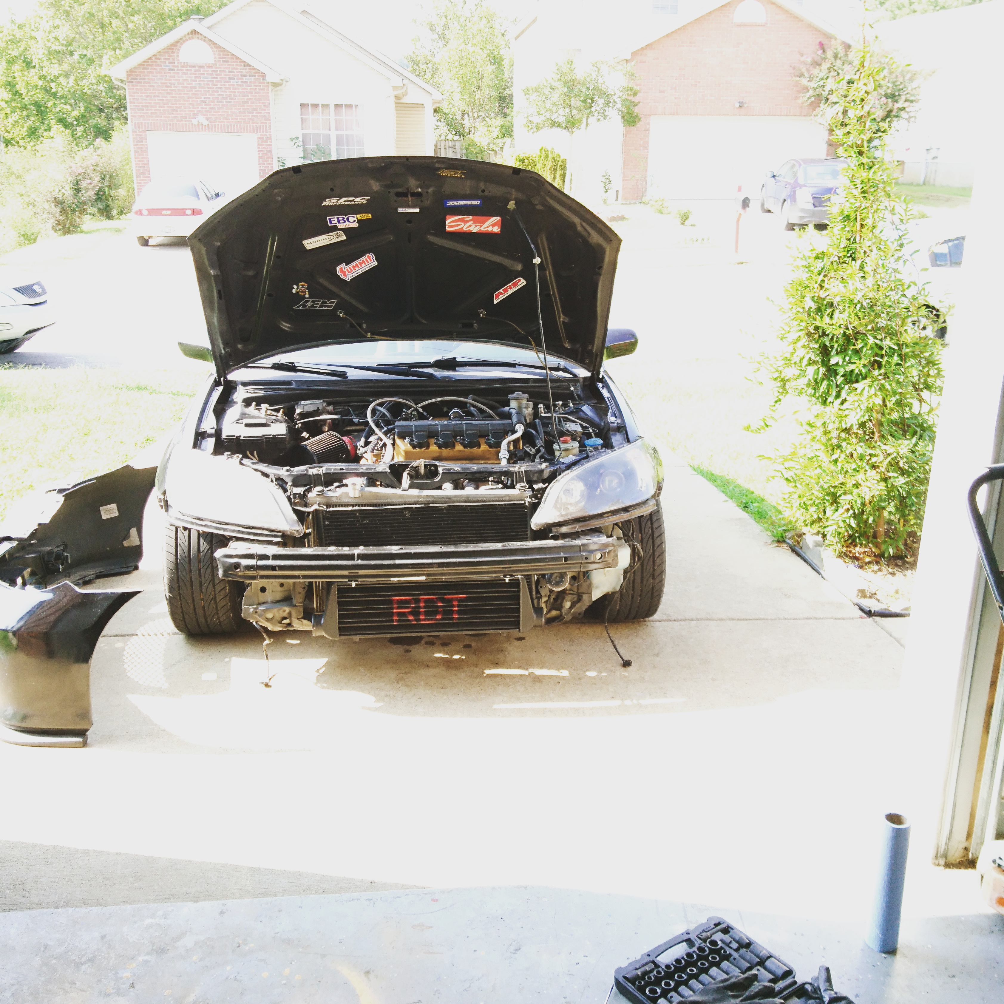

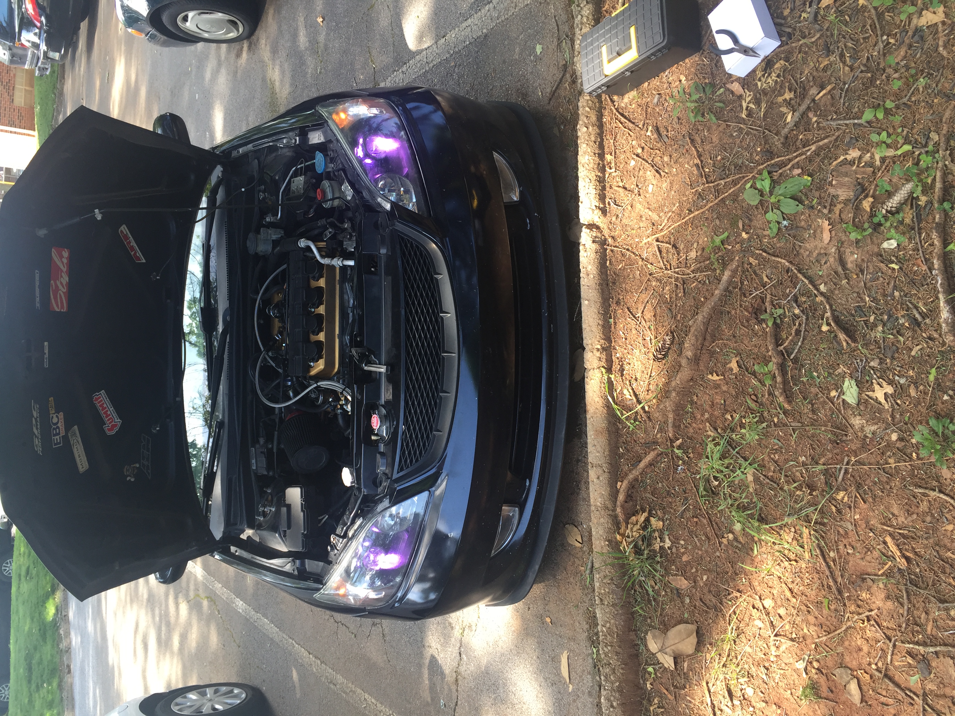

mounted FMIC,
compression test was good, no variations in pressure
met my tuner in nashville, discussed costs,
What would I need to do to get Acura RDX 410cc injectors to work with the D17 engine?Is it the wiring clips that have to be changed?
1)Tuner said for $500 he would tune
2)Tuner has extensive Honda experience, said 310cc should work just fine for reaching my power goal of 170whp. He feels confident that I can even run a 7psi spring on my small peashooter without upgrading fuel pump or above 310cc
3) Tuner referred me to a local guy to fab exhaust
Plan: Install turbo kit, drive carefully open downpipe to tuner, get a tune, drive to local guy, get exhaust fabbed,and ill be done

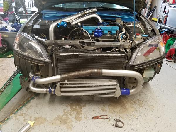

Re: Erf's Low Boost Build (Stock Internals)
i can hit 7psi before the car stutters on the stock fuel injectors and stock fuel pump.
BTW have fun routing the intercooler piping...

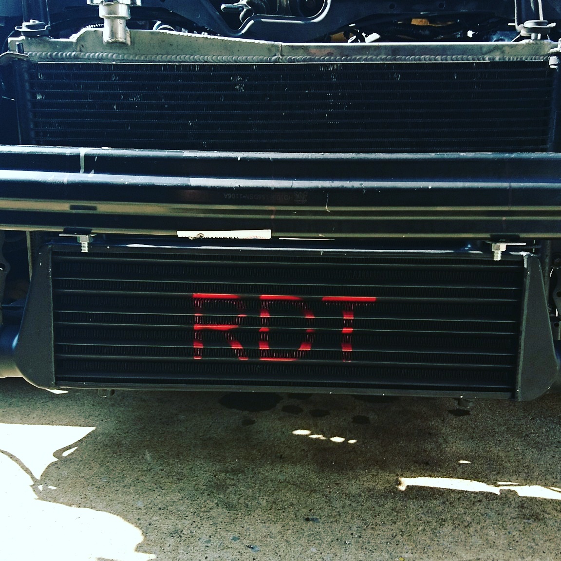

Here is how i did mine...
notice the front bumper bar is not in the picture
yea, i should be fine then on 310cc injectors. not really worried. thanks to the communitys experience I dont have to experiment. i will go ahead and buy some bigger RDX injectors in case we get stuck tuning for more fuel delivery as i promised him, the tuner, that so we dont waste time,
God damn it. Hmmm, I think if I plan accordingly 2 hours tops is all it will take to route the intercooler piping. Its a no brainer that both inlet/outlet pipes HAVE to come in through passenger side. But there might be options for the driver side pipe. I might be able to cut away some bumper trim, then route that exit pipe UNDER the intercooler instead of above.
One question, is there a difference in performance in which side of the intercooler gets compressed air and which side feeds the intake? So if the Compressed air leaves the turbo, joins the FMIC by the passenger wheel well, then the longer discharge pipe goes to the intake from driver sider, would that affect anything? Would it be better to route the compressor pipe to the far side of the intercooler by the driver's side and then a shorter pipe from the FMIC passenger side to the intake? Just curious if anyone knows.
These types of intercoolers normally flow the same in either direction. My question is why not use the same-side intercooler that the rev9/godspeed kits come with? seems like a no brainer for these cars.
Because my cheap *** bought a "complete" turbo kit for 300 bucks off of craig's list.
If i had a choice, i would go with the same side route.

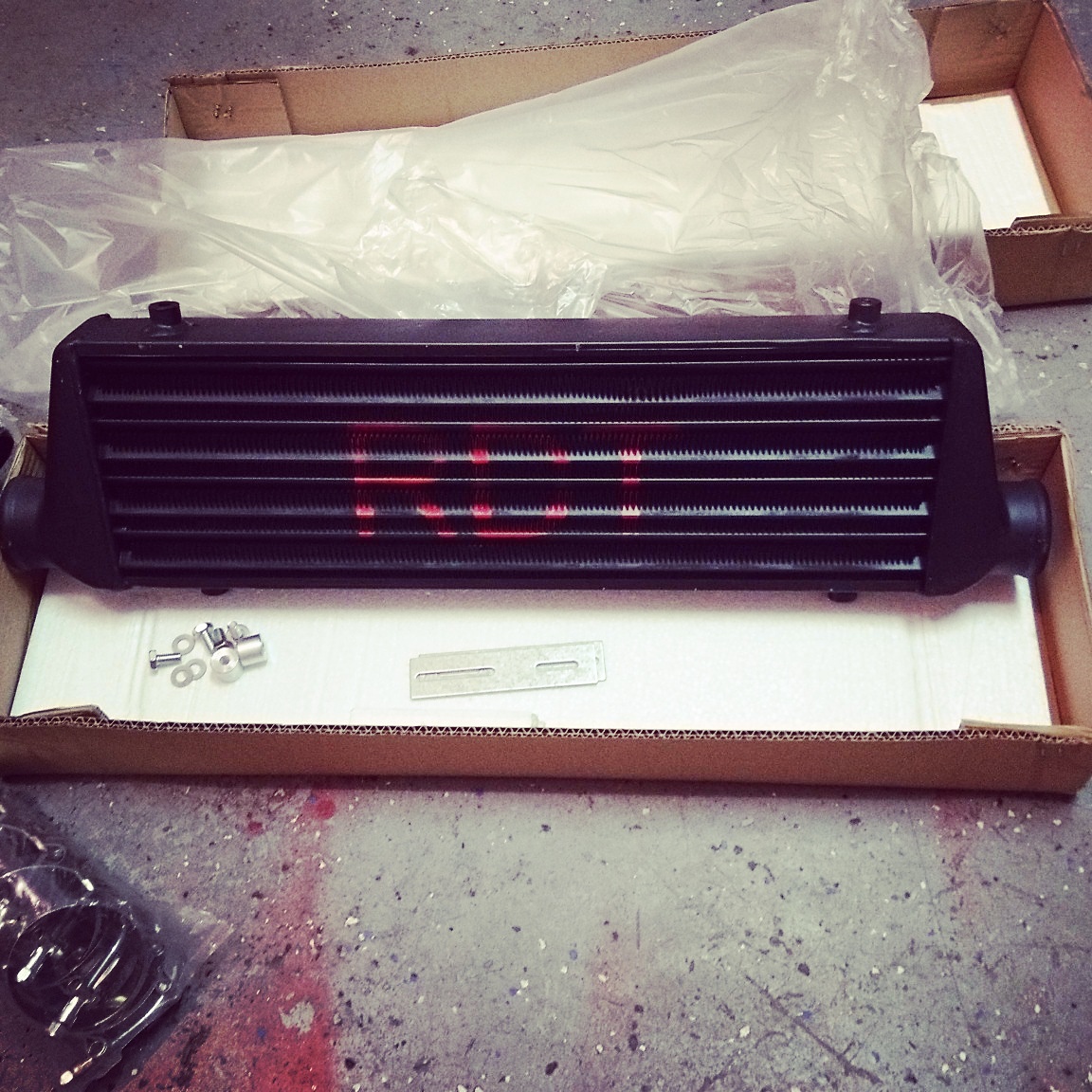

I really wanted a black intercooler haha.
