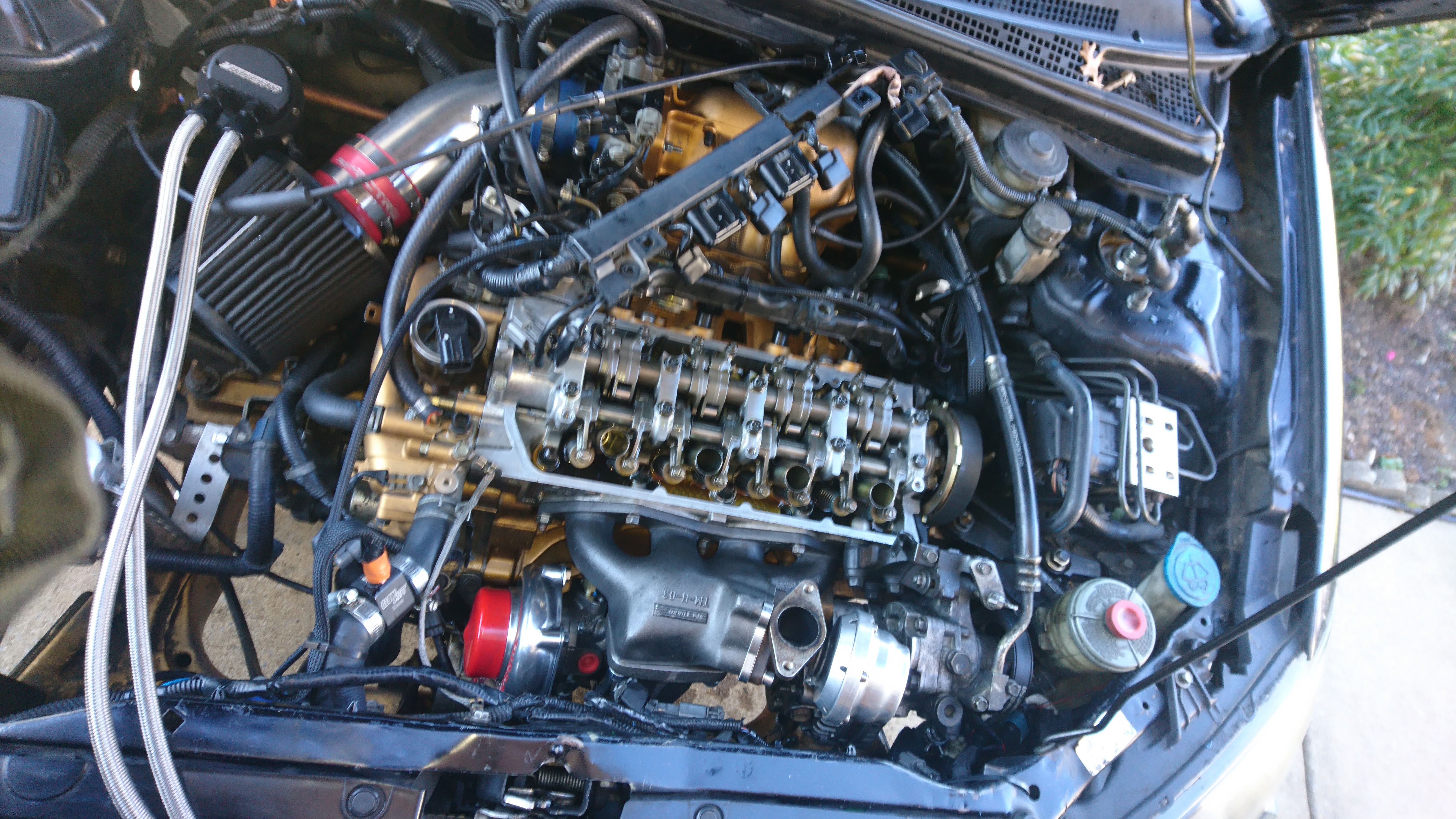

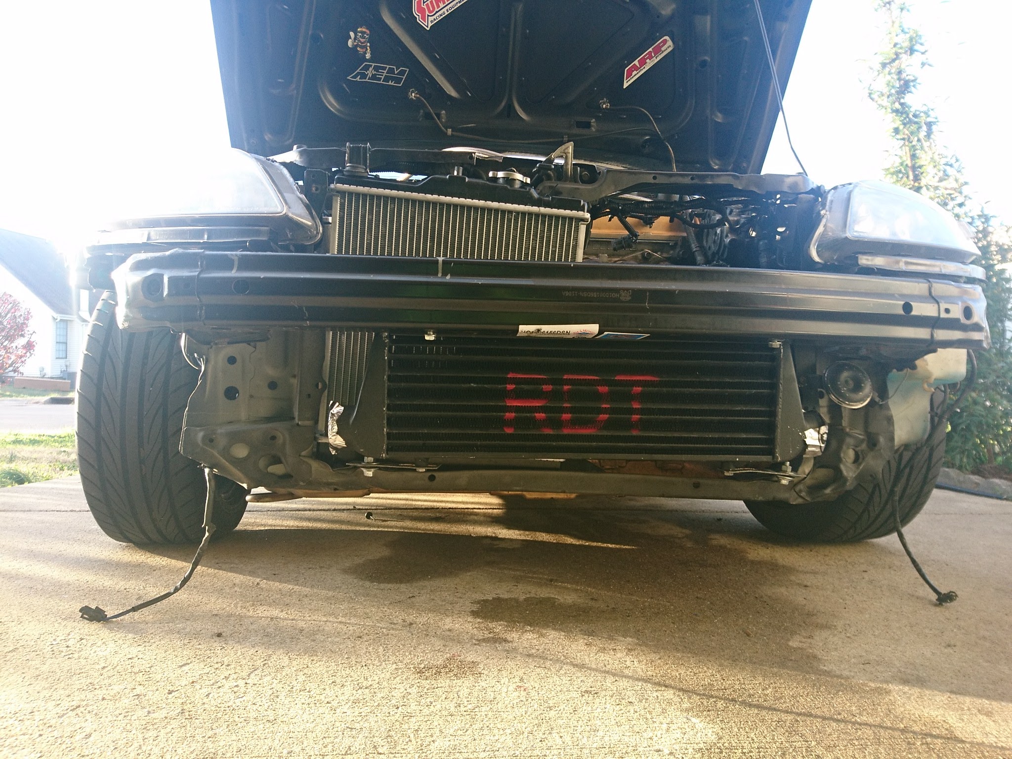

Alright boys quick update from this weekend
Got the car up and running, drove to the 865 no problem.
-Bulkhead fittings for valve cover were a success, except I had to use O rings to seal the inside instead of supplied washers due to my bore being a little bigger than the actual fitting. Nothing a good o ring and proper tighten cant seal
-Removed 75% of A/C system
-Re-mounted intercooler where the condenser was. She fits like OEM. The bumper fits perfect and no clearance issues with plenty room for IC pipes.
-Test fit the manifold and turbo ran into clearance issues/cut out middle radiator metal seperating left fan from right fan, no use so might as well
no leaks from VC either after 200+ miles.
-My cxracing downpipe wont clear front motor mount
-My turbo manifold fits, but my turbo hits the AC compressor, so had to re-think spacing
bye bye A/C
To all turbo junkies: SPA turbo manifold is NOT AC compatible. At least the version I got. they make a smaller one for T25 setups or you can go with Rev9power manifold
To do
-remove A/C comp/comp mount/ac belt
-Alternator only belt to be installed
-come up with downpipe solution
Let exhaust man fab the rest
Downpipe ideas:
discharge--->adapter to vband---> vband 14in straightpipe---->vband to four bolt flange adapter---->downpipe I currently have
re-clock turbo to where downpipe goes downwards from driver side not passenger side, convert discharge to vband, get a 90 vband and go down, another 90 to go under the car vband as well

Glad you made some progress and glad the AN bulkhead fittings did the job. I realized after having some fittings welded on before that there is usually a "bolt-on" solution out there.
As far as the turbocharger position, I know Rev9 has theirs clocked with the turbine on the driver's side and compressor on passenger's side. doing that, they're able to snake the downpipe down along the back side of the AC compressor, from what I can tell. You mention their manifold is different than yours though so I'm not sure if that position works well for you.

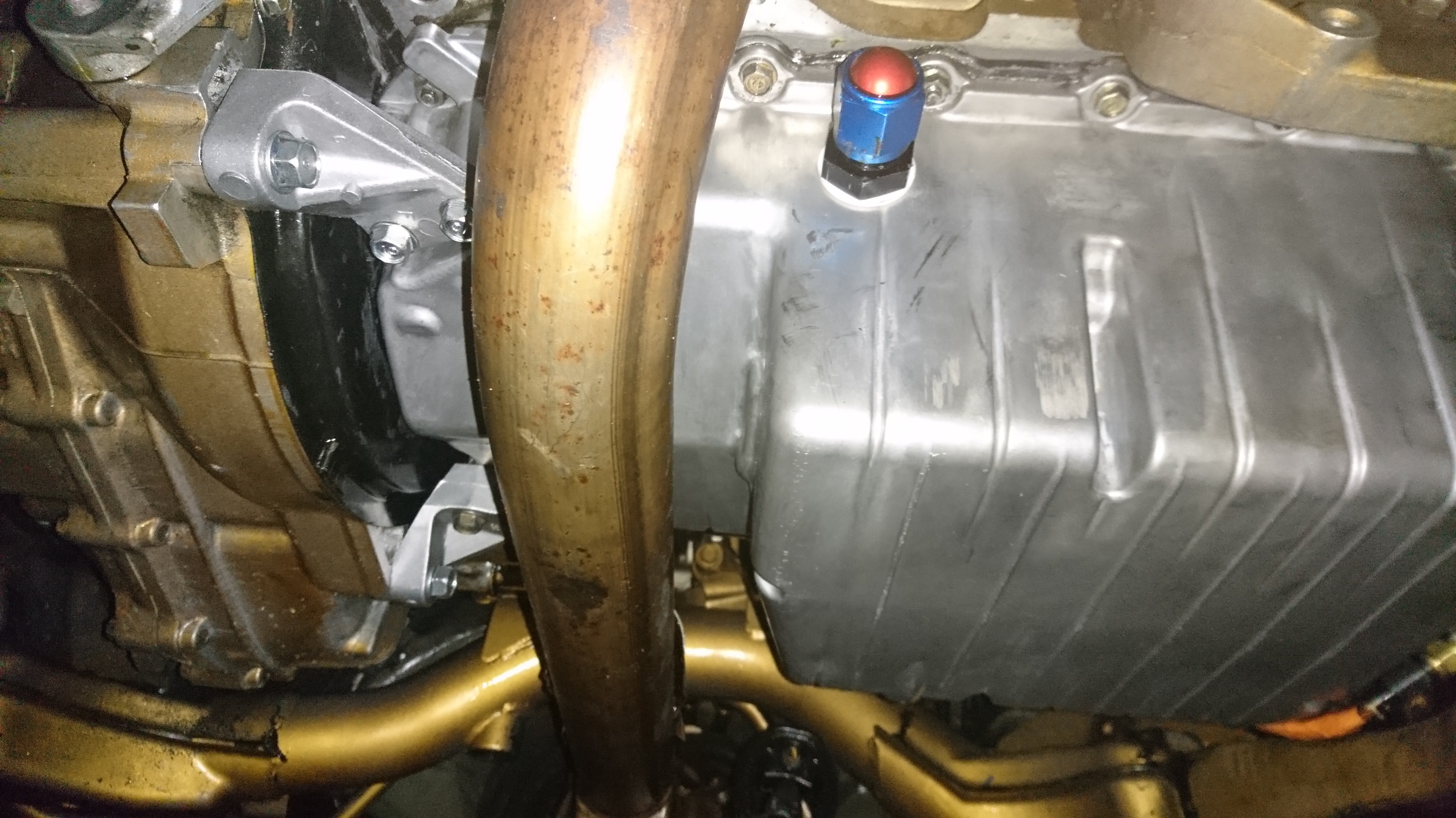

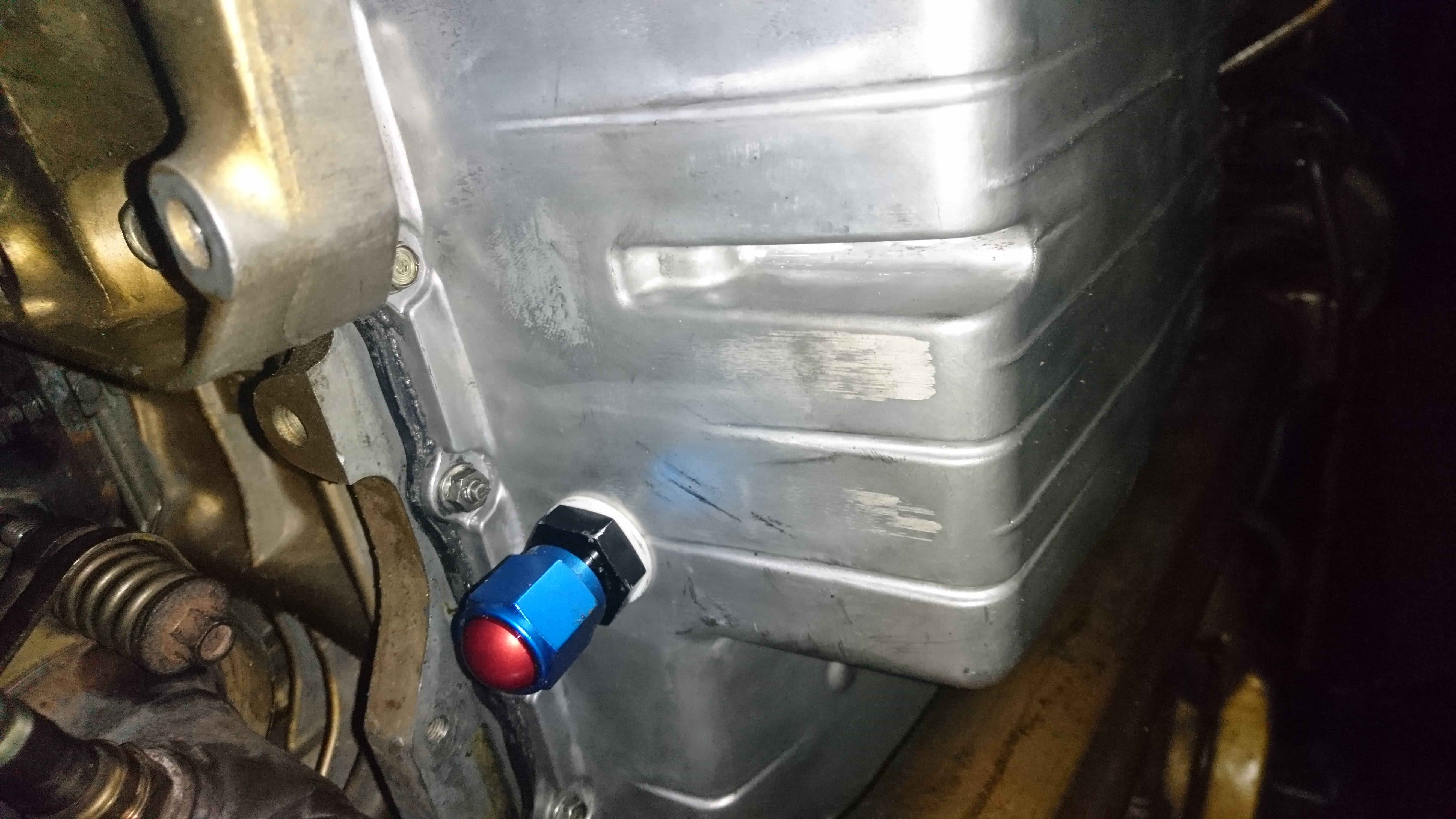

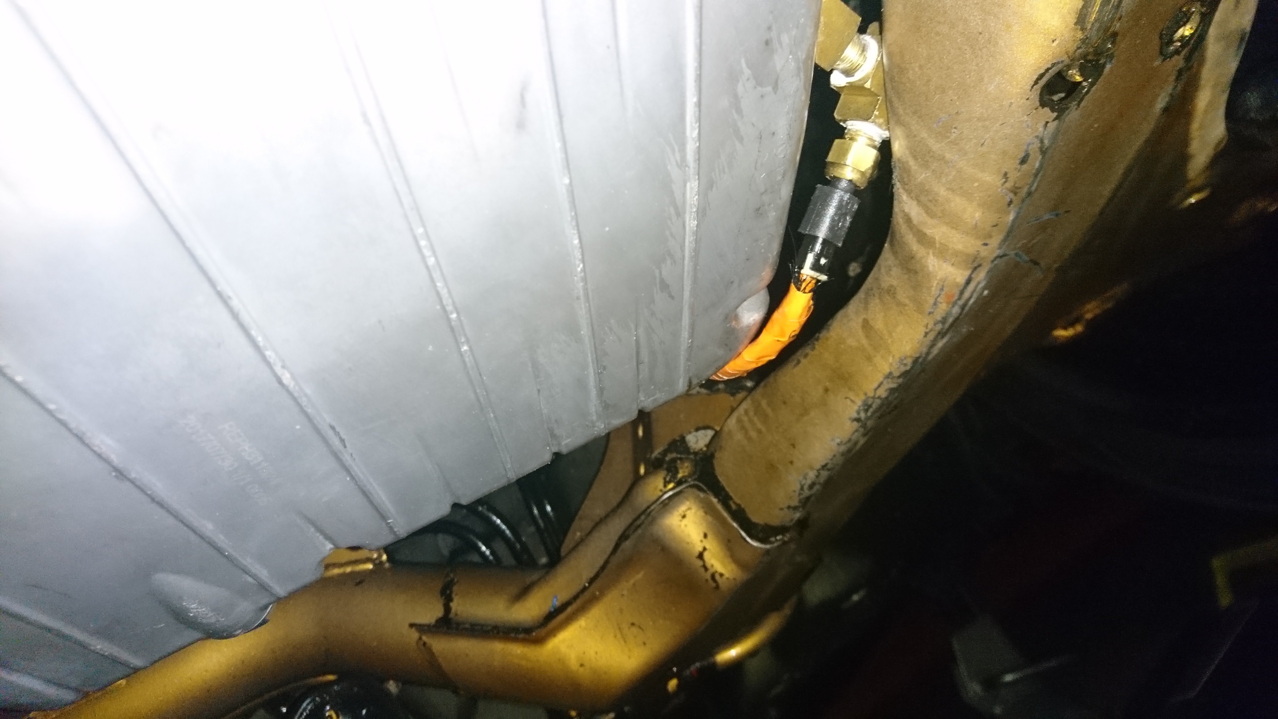

-Changed oil pan to OEM aluminum
-Removed A/C compressor
-Still had fitment issues
-Fixed turbo manifold fitment issue by clocking turbo to where downpipe goes down the driver side (traditional EM2 setup)
- Turbo manifold and turbo clears perfectly with room for a 3in downpipe
-My CX racing downpipe is 3in not 2.5. I just barely have enough clearance for the OD to clear the turbo and the A/C compressor bracket, so I should be goood.
-bulkhead fittings on the new oil pan
Plans:
Cut my downpipe shorter to make it a bend and a straight section
Here is the one I bought over a year ago (designed for passenger)
https://www.cxracing.com/downpipe-tu.../DP-CIVIC-D-4B
I also decided to let the gauges display partial digits. No supplier had the boards. So I just left it.
What I learned this weekend:
if you plan on removing A/C compressor, just remove the compressor . IF you remove the mount for it as well, you will have no place to mount the alternator as the mounting bracket of the alternator has a locking bolt that attaches to the right side of the A/C compressor mount. Unless you like extra work and want to relocate your alternator as well. Ive only seen one person do this and he is luistech100 on YouTube. Me not having time or skill to do that, I decided not to go that route. Left the mount attached to the engine so I could still use my stock alternator mounting method.
I learned this after removing all four stupid bolts of the mount, then when it came to mount the alternator realized I had to put it back on.
EM2s best case is to route the downpipe from driver side. And that is all turbo EM2 owners go driver side downpipe. *lesson learned* Well.. Things are looking brighter by the day.

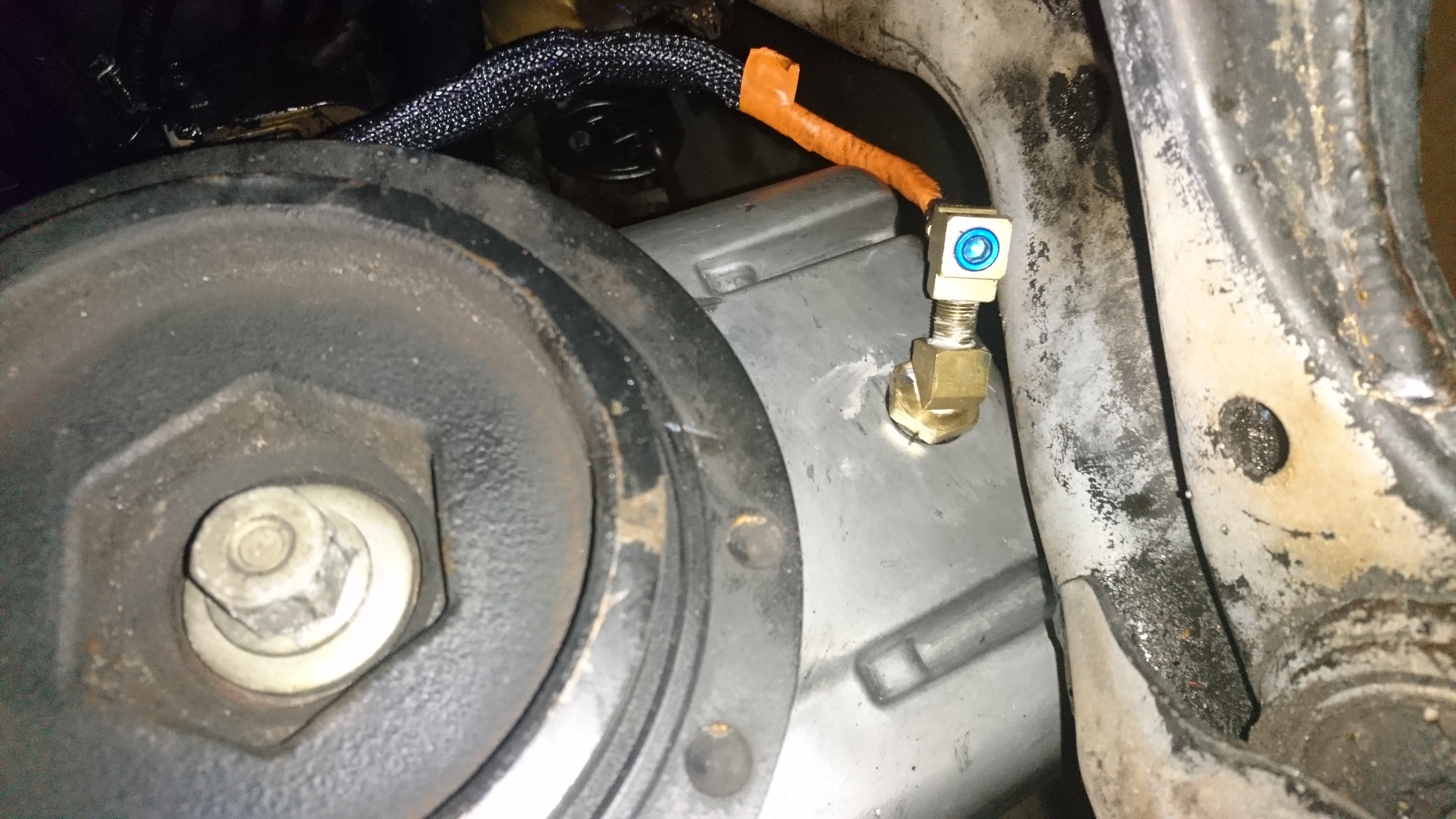

From last weekend
First thing driving to Nashville I made it home and guess what? Antifreeze leak. Oh oh. Next morning guesss what? My very expensive $230 Koyo Racing Rad had holes in it. Why you ask? My A/C fan blades had come off the fan motor and cut the radiator fins up and left about 10-12 small holes. With me needing to fix the car ASAP, I drove to AutoZone, paid 80 bucks for a 1998 Civic Radiator. It is half-sized. I mounted it up, had to modify my bumper grille, the metal support, and filled her up. She stays a bit cooler now. If anyone wants to buy the one I got it is a Spectra Perfomance OEM radiator for the 1998 Civic. It works well. I should have just went with an eBay radiator from the get-go and save money. They are just re-branded anyways.
Test fit the manifold and turbo on the engine. Clears, just needs some clocking.
After trying to mount the downpipe, I noticed the flange of the four bolt downpipe needs to be rotated, and the section that comes straight down needs 3-5" extra to clear the oil pan. Once I can get the downpipe issue fixed, she is pretty much ready for install and tune.
