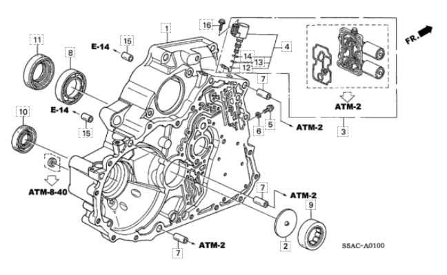

I'm having trouble finding what the seal is called. Some just say 'oil seal' or ' transmission output seal' and others call it a transaxle seal??? I'm replacing driveside axle so need the name or part # of whatever seal is needed where axle goes into auto transmission on 1.7L engine. Thanks!

Find an online Honda parts dealer (like HondaPartsNow.com) and input your vehicle info. Axle seal is going to be somewhere in the transmission section so you go start looking at diagrams until you find it. In this case, it is in the "AT Torque Converter Case" section. Reference 10 below, part number 91205-PL3-A01. It can be a little difficult to find the right section but the more you do it, the easier it gets.

the other seal is in transmission case, part 25

Thanks for the help! I usually can find parts this way but this particular one gave me trouble. Because from the diagram I still couldn't be sure what seal I needed and it's referred to as different names like 'oil seal, 'tansaxle seal', 'outputshaft seal' etc. Just found one on ebay for 10 shipped so order is in!
