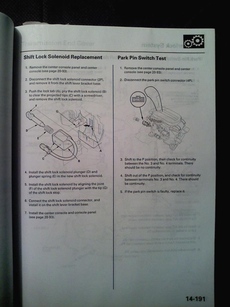

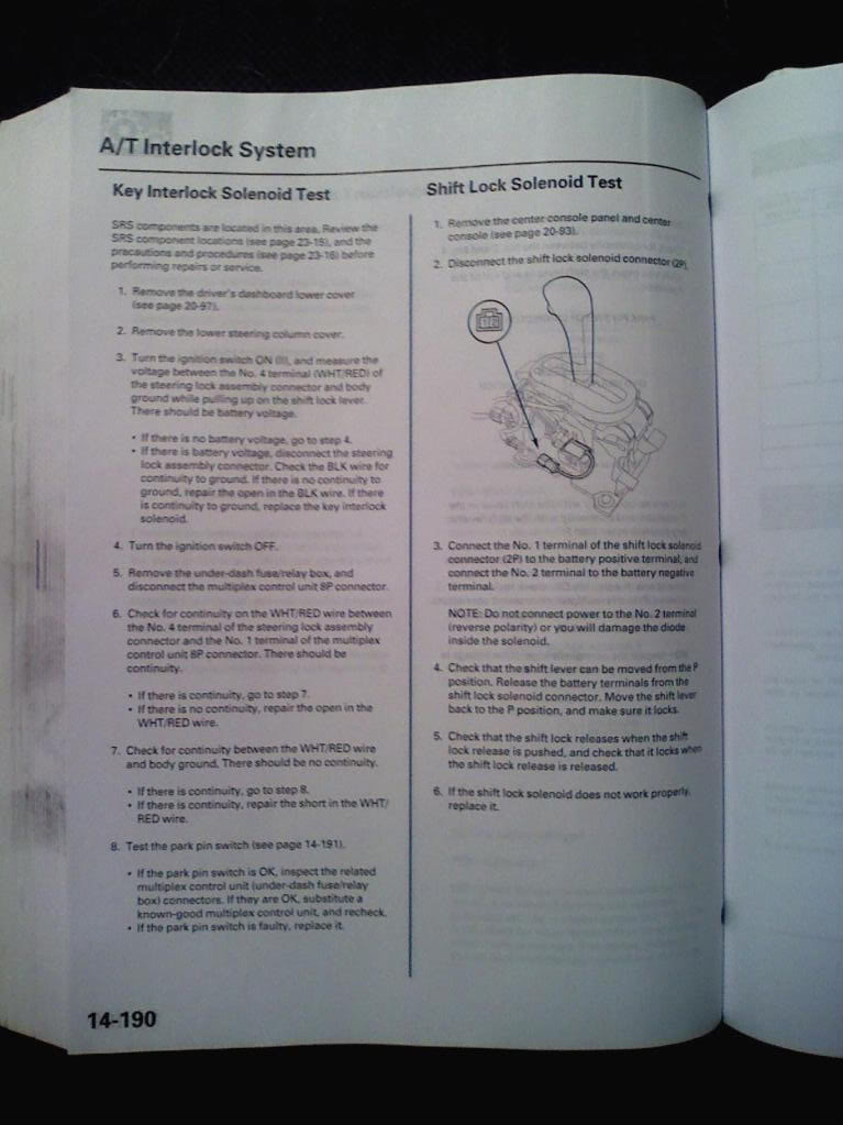

Sorry about the fuzzy pics, phone cam:

Is that a dealer manual? my alldata account shows identical images and the words are word for word. Thanks for that though, I was going to test those this weekend.

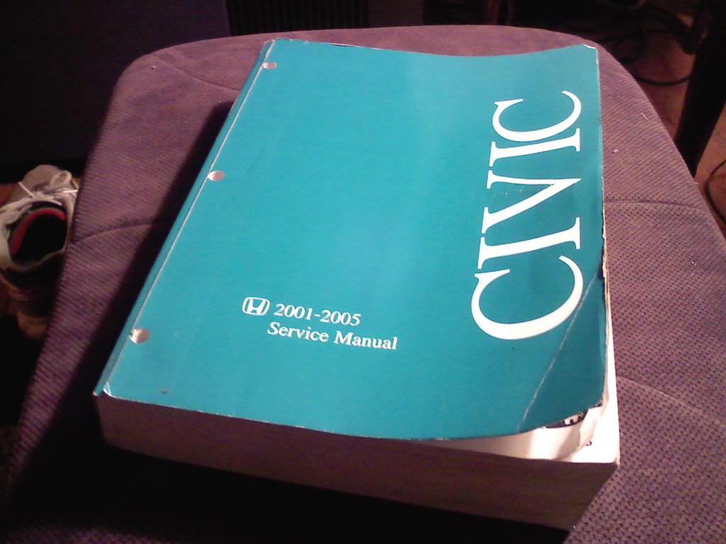

Old Dec 17, 2010
Re: Shift out of Park issue
i mustve got the first edition lol. mine says 01-04 civic
