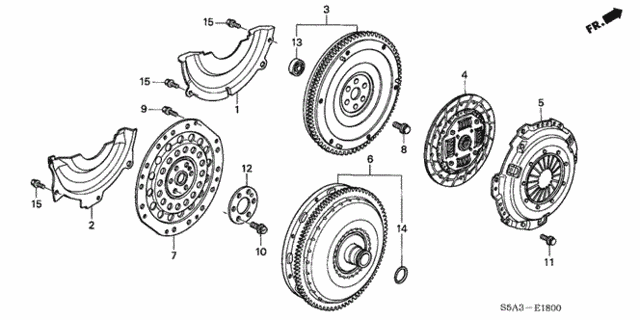

https://www.bkhondaparts.com/v-2003-...rque-converter

I don't get what I'm looking at. Could you possibly explain it. Also what could be loose or broken in there that I would need to take off the trans to find out what it is.

sorry, forgot to say.
Upper one is the manual, so disregard
bottom assembly is the auto torque converter. Same as the clutch in the manual trans, connecting engine to trans.
I was answering about the disk behind the flywheel.
we have not even found out if it is in the flywheel case or in the trans itself, so can't say what it is.
there's also the possibility that it is not there either, someplace else... That's the life of mechanics...
