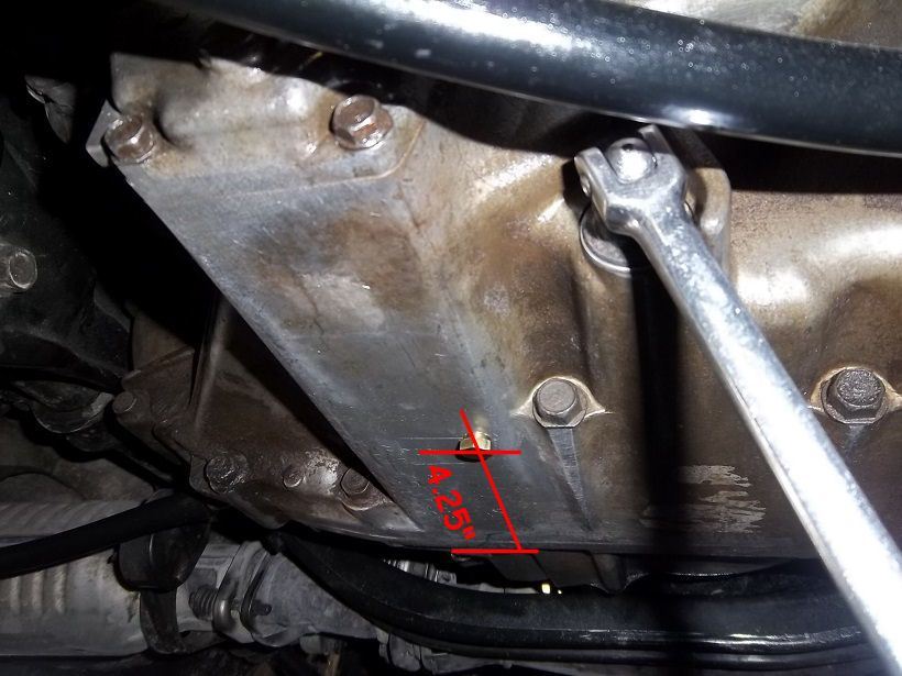

That post is about a different transmission, in an accord, with a different ATF strainer but in another post https://honda-tech.com/forums/honda-.../#post52356337 a guy says he did it successfully on a 2005 7th gen, exactly what I'm working on and he linked a video of him drilling the hole too.
I'm going to give it a shot and I'll post back how it works out.
I saved one of the images from the original post and am adding it here so it's in more then one place.
This is an accord tranny but the hole location on a 7th gen Civic is apparently the same.
The hole is 4.25 inches from the case seam and as close as you can get to the curved part while still staying on the flat surface.

So, it worked. The location of the hole in the picture I shared is not exactly correct though. Since the fluid never stopped dripping out I wasn't able to get a good look in there to see which way the hole should be moved. You get a lot of fluid that doesn't come out of the drain plug at this location so be prepared for that.
I can't be sure if sticking the business end of a can of brake cleaner in the hole and spraying it in every direction I could (I used up 1 new 18oz can and PS This results in the brake cleaner and dirty fluid running back out and down your arm) or, blowing out the system with compressed air or both, is responsible for curing it but it works fine for now.
I disconnected the cooling line, at the top middle of the trans. I held the air nozzle to the fitting on the hose with only my hand and blew all the fluid out of the cooler. Then I put together an adapter and hooked my air hose (with the pressure set to 0) directly to the trans where that hose hooked up. I turned up the pressure to about 10 PSI and left that on there for about 15 minutes. This produced a small but steady stream of fluid coming out of the hole I drilled. (If you disconnect this while there's still pressure, it will spit fluid out all over so let the pressure bleed off first)
After that I did the triple fill and drain using some cheap store brand 'compatible' trans fluid and then filled it with Honda ATF.
But, here's the deal. That filter should never get plugged. Unless you pour dirt in the filler hole, the only place your going to get debris is from the clutches. So if it plugs, you need to rebuild the tranny and there's no way around that. Unplugging the filter this way is just a temporary fix.
As for ours, "Merced Aamco" supposedly rebuilt it just 25k miles ago and the filter had never plugged before they did. I'm pretty sure they just threw fiber disks on the old steel ones and they are wearing insanely fast and this is what plugged the filter. The fluid that came out was pretty dark.
