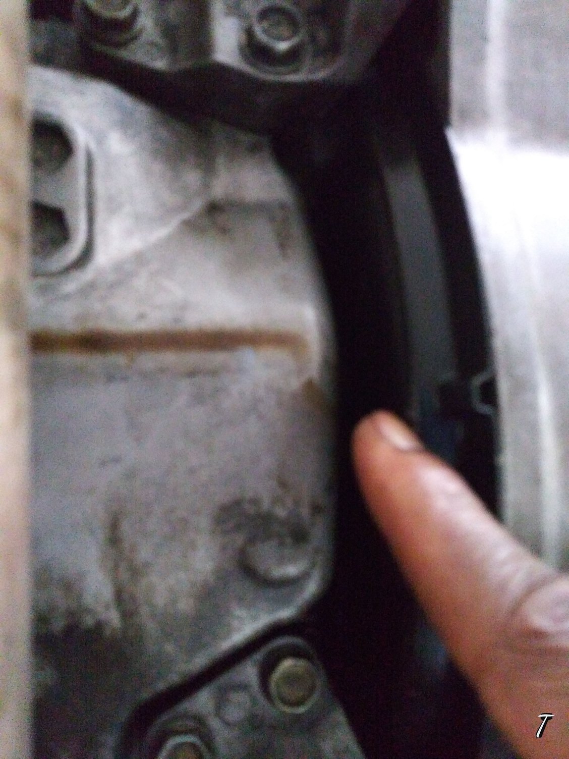

I have this oil settle on the bottom on my oil pan to the transmission side . im wondering if its comming from down from between the transmission and the oil pan. Here is a pic.

When tracking oil leaks always start from the top down. Possibilities are valve cover gasket, cam seal plug (cap), Vtec solenoid gasket (if applicable) and rear main seal. While engine is cold use an engine degreaser, rags, and clean the area from top down as best as possible. Can use baby powder or athletes foot spray to help isolate the leak.

I was thinking its the seal thats located between the engine and the flywheel.

Your pic is really hard to make out, if it were the rear main seal I would expect to see oil to the right of your finger I would think. Follow the instructions HR posted first.

The one between the flywheel like i mentioned?

Since you cant see the pic clearly.i will try take another one tomorrow and post it ..

If it turns out to be the rear main seal that's leaking the engine and transmission will need to be separated to get to the seal. The part is cheap but it's labor intensive. Use Honda genuine seal only.
