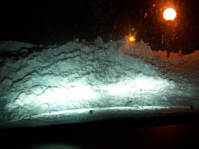

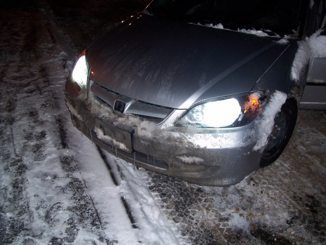

Alright I took some pix of my PnP kit.. I also have a video of turning them on.. maybe I'll figure out a way to put them on youtube or something..

Looks pretty good to me but that colour with snow = impossible to see the road. I remember when I had some 8000K lights it was terrible in the winter to see. Now I put some 4300k silver stars much better but I'll get some HID's whenever they blow. Buying bulbs all the time get annoying.

^get one on Ebay.. they have good relays on there, just make sure it draws power directly from the battery, and it's for H4 or 9006 whichever year civic you have..
Thanks man they're actually 6000K, and IMO they do great in the snow, they really make the snow GLOW actually, and I can see it very well.. and yeah I hear ya on halogen bulbs.. I hope my kit goes for a long time
