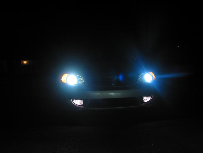

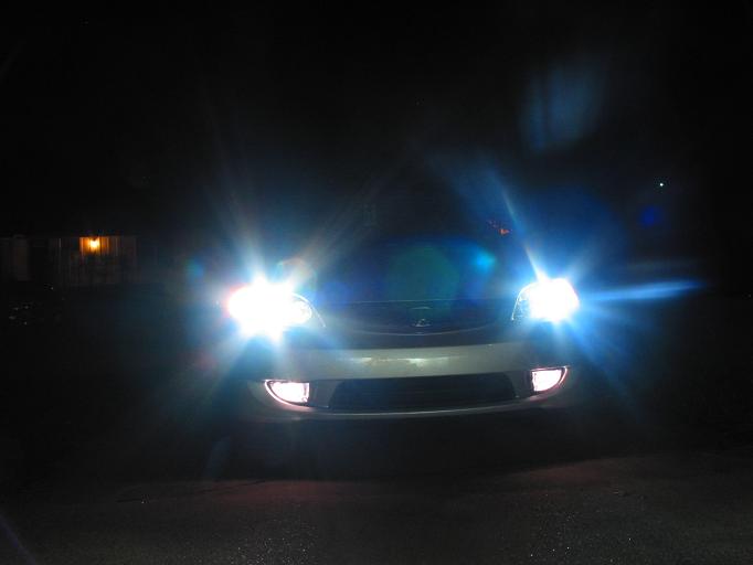

Just since we're talkin' bout HID's... I have 8000K on Projector's. I love them... should definately go with Projectors and HID combo! What do ya'll think?
ID:	73296   Click image for larger version
ID:	73297   Click image for larger version

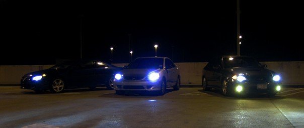

anyway, here is a pic of hid kit 4300K color in stock 01-03 headlamp. it doesnt look too bad, but there is not as much light as you would have from using a real hid projector.
stock housing with H4 sylvania xtravision clear halogen bulbs running at 15v (my current setup).
for comparison, here is an s2000 projector retrofit running 6000k hids (about 2000 lumen dimmer than the normal 4300K bulbs).
i am looking for some more pics to show you but this will work for now.
