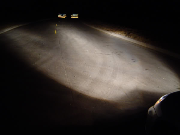

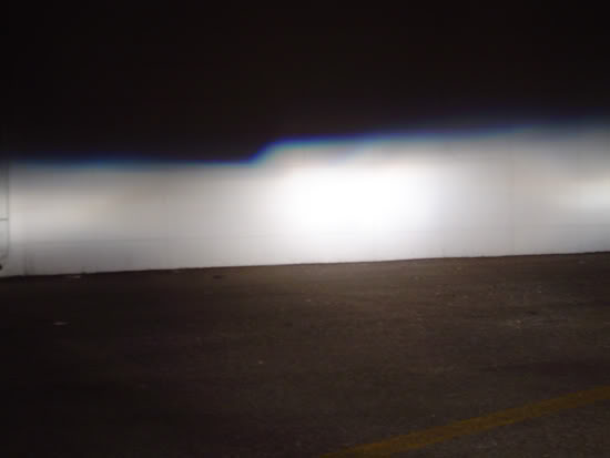

Re: headlight help
they bolt right in. i used to have tyc and sonar. you must remove them from the car tho to be able to turn the bolt and adjust them. i got mine aimed pretty well... these are the older v1 projectors with the blue cutoff. newer ones dont have color.
NICE! Thanks for all that. I'm gonna use your photo as an aiming guide. How far back from the wall are you? That's gonna be my project this weekend after I figure out from where I'm leaking power steering fluid. I think the hose got stupid. Woke up this morning with fluid all over the garage floor and the reservoir WAY low...
Old Jun 12, 2009
Re: headlight help
park 25 ft away from the wall on flat ground. then aim each side by using the left side of the cutoff. first measure the distance from the ground up to the projector part of the headlight. then measure that same distance at the wall and mark it. your left side of each beam should be 2-3 inches below the mark you made on the wall.

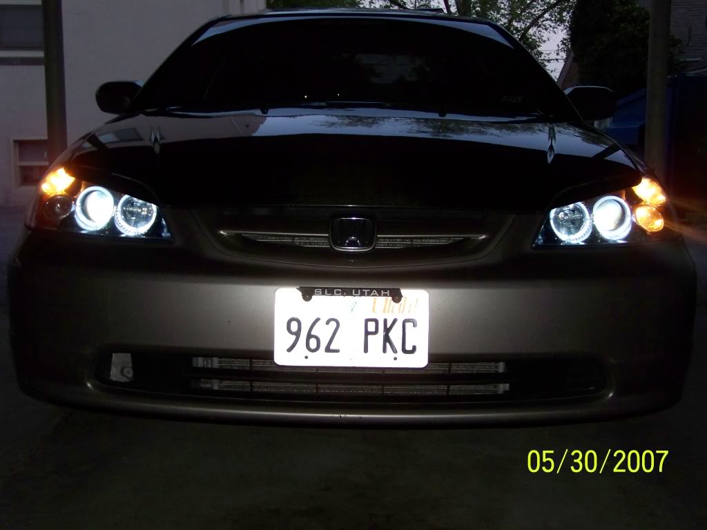

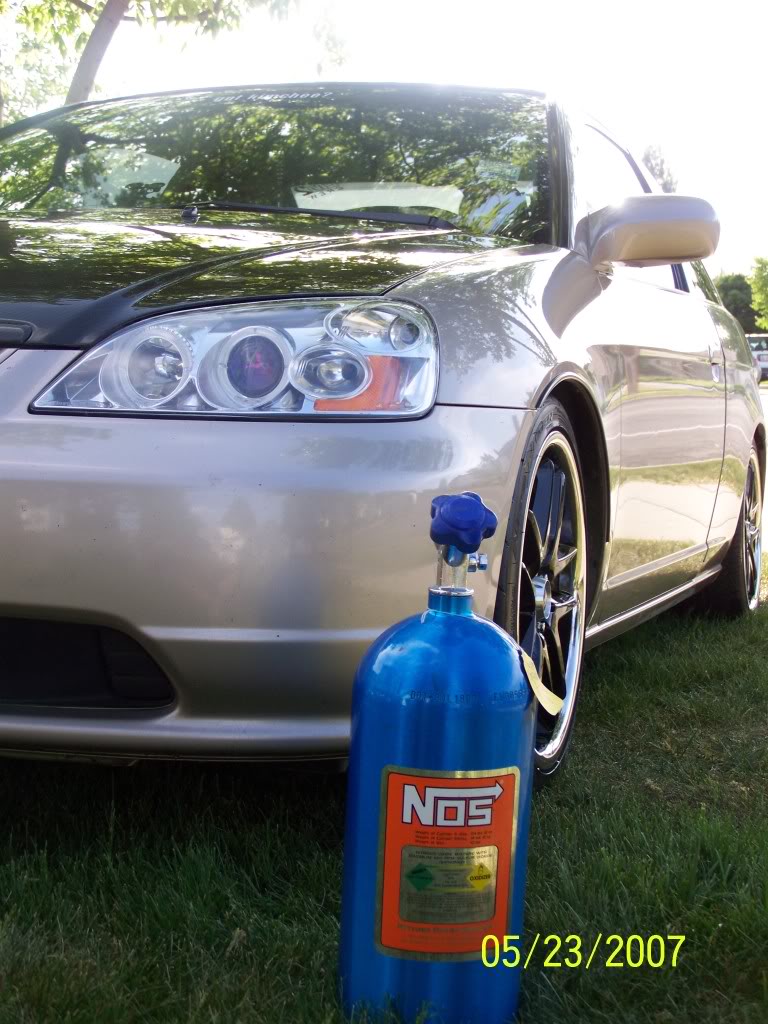

Re: headlight help
Yeah ive never had issues with my ebay projectors, but I did silicone them before install. Im not running hid's so I dont know about the melting thing. Here are sum pics.
