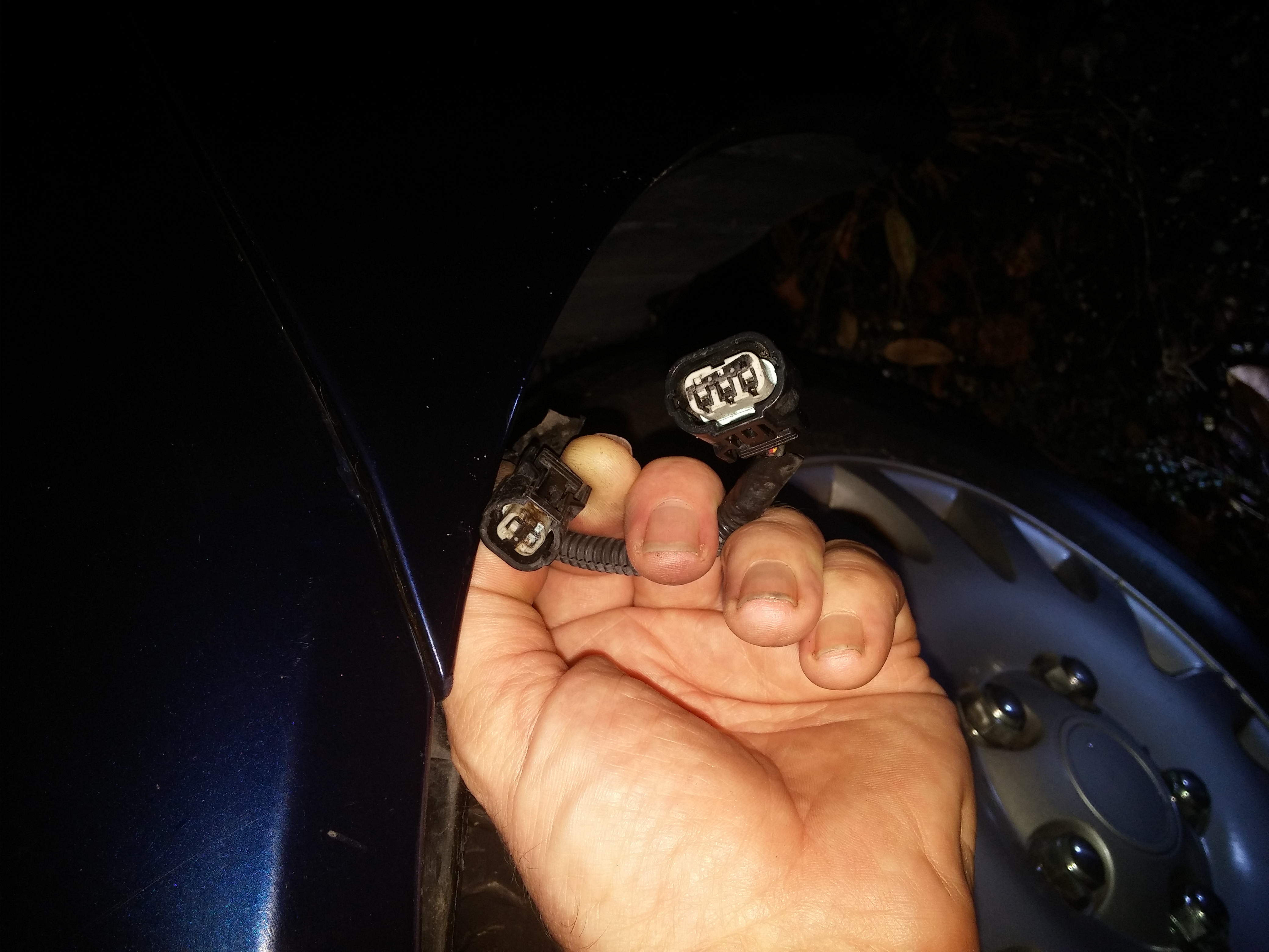

but, I have a fast flash right signal, its the front thats out, I get a pair of 7443's at wally and discover that you have to pull the fender liner out to get to it........wtf? (great jack points on the car, guess there is give and take)
So I find nothing in the headlight shell sockets, and these 2 harness plugs laying in the general area. neither of which accept a 7443. SO, hopefully I find I can post a pic with this, and someone can point out the obvious

Pic is just wire connectors....they probably need to connect to bulb sockets in the headlight housing.

I take it then that on a honda the wire harness does not terminate directly to the lamp socket, but instead to a connector which plugs into the lamp socket.
interesting. I would have checked the working side to see what the correct layout is, but didn't want to rip another innocent fenderliner out of position to check

#6 and 7 are your bulb sockets here:

I wonder if they are laying down in a dark corner, or just plain missing.

The pulling of the fender back is a bit of a pain, but it's manageable. Another option would be to remove the front bumper and affected headlight (I have that process down to about 5 minutes for removal) and do it that way. I only use that method if I'm actually tinkering with the headlight like I tend to do. There is a part number difference just differently shaped (weird, I know). I can't quite recall at the moment, but ezone may be able to shed light on that. I just remember waaaaay back when companies started releasing aftermarket headlights, users here mentioned something about needing one or the other socket in order to have properly fitting bulb sockets. Weird thing was, though, they use the same bulb and connect to the same pigtail connector. If they're the same per ezone, disregard that tidbit.

For now, I toook a 6 inch piece of 20 ga, tinned the ends and shoved em into the connector soldered the other ends to the lamp wires, and tucked it into the shell. **** it
