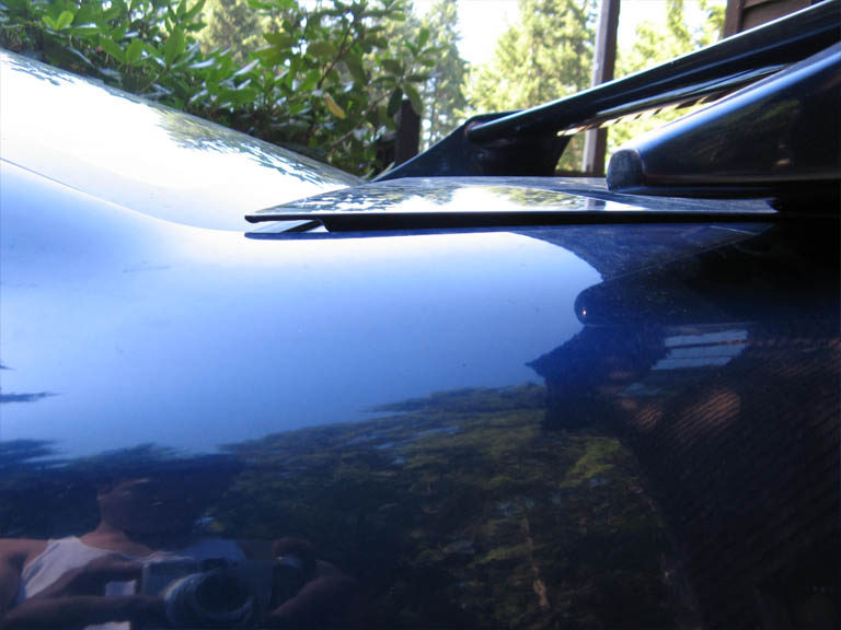

so.. I have a Kaminari KTR-II wing.. I just tried to do this install and found out that 90# shocks are too strong.. lol..
with that said, has anyone else (post gas-shock install) had problems having their trunk not sit flush when closed? Or is that just a by-product of having gas shocks that are too strong..?

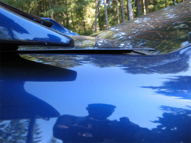

well, for one, I started mounting them in kind of a bad place.. i shoulda cut some cardboard pieces and played around a bit before drilling 20-gajillion holes all over my trunk.. I was trying to use grey's pictures for reference, saw 2 holes, drilled between the two about an inch off from one, and ended up using the wrong 2 holes...
the amount of force those shocks were putting at that particular spot was causing the front end of my trunk (closest to the rear window) to not sit flush by about a quarter inch..
i went and ordered a set of 60# shocks and when those show up, i'm gonna play around with some cardboard cutouts a bit more before re-drilling..
just means this is gonna be a project for another day.. makes me a sad panda, seeing as how my trunk can potentially kill me due to the lack of trunk springs and a kaminari wing.. damn you inifinity for making good sounding speakers..
Old Aug 22, 2008
  #217
Rep Power: 513
Re: DIY: Trunk Shocks

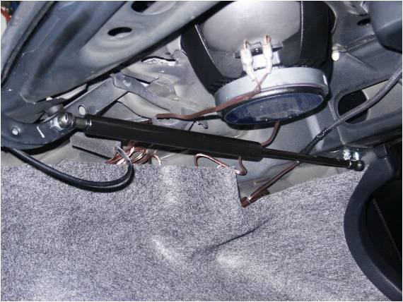

Alright.. so I got my 60# shocks in and installed.. When I turn the key or pop the trunk from the inside, it lifts the trunk up about 4 inches, and if I lift the trunk, it'll stay in the position it's in. Trunk opens all the way, closes all the way.. Cool.. here's my problem now..
I don't see how messing with the rubber bump stops will help this one..
When I go into the trunk, sunlight is visible, so.. that means rain will be able to go into my trunk and potentially mess up my sound system..
Any suggestions anyone?
p.s. yes, my car is dirty.. shaddup.. it's been sporadically raining here in goo ol' WA state.. hence my concern..

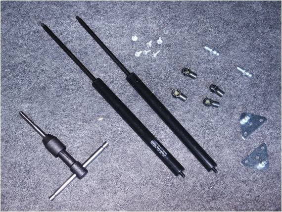

I saved this (and all of Grey's other DIYs) to a word .doc way back in the day.
Here are the pictures in order. There were seven of them. If any of the ghost mods are still around, feel free to use my hosting to put them back in Grey's original post.

haha, drilled a hole too far back and had to drill another one. I got them installed though. I left the trunk springs in originally and when I opened the trunk it shot up like a catapult with the 50 pound shocks. So I pulled out the springs, almost breaking my hands in the process, and now when I open the trunk it raises up nice and slow on its own. I like these!
EDIT - And a huuuuuuuuge thanks to Speedfoos for letting me ship 2 of these kits to him and then shipping them up to Canada for me. Stupid McMaster-Carr doesn't ship to Canada. Thanks a pile, dude.
EDIT 2 - I just realized when I put the custom trunk enclosure I built back into the trunk, my subwoofer won't fit snug up against the trunk arm on the right side because the air shock is there. FUUUUUUUUUUUU$@#%^*&*&^%$#%^&%$#@#@!!#$^*!!!!!!!!! !!!!!!!!
