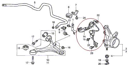

for the five lug converion do i need the abs assembly unit? i have an ex so i have abs but do i need this to get it to the rear wheels? thanks.

you need the ABS sensors off the RSX if your doin a 5 lug....read the FAQ...

If you have a EX your ABS module will work, circled is the sensor i'm talking about.

if ur talking about the ITR 5 lug, it will work with the civic abs sensors, u just need to bend them a lil......... not sure about the rsx as the ITR has 300mm rotors..... rsx is smaller

I tryed my Civic ABS sensors in with my car, didn't work. The whole the sensor goes in is smaller on the RSX.
