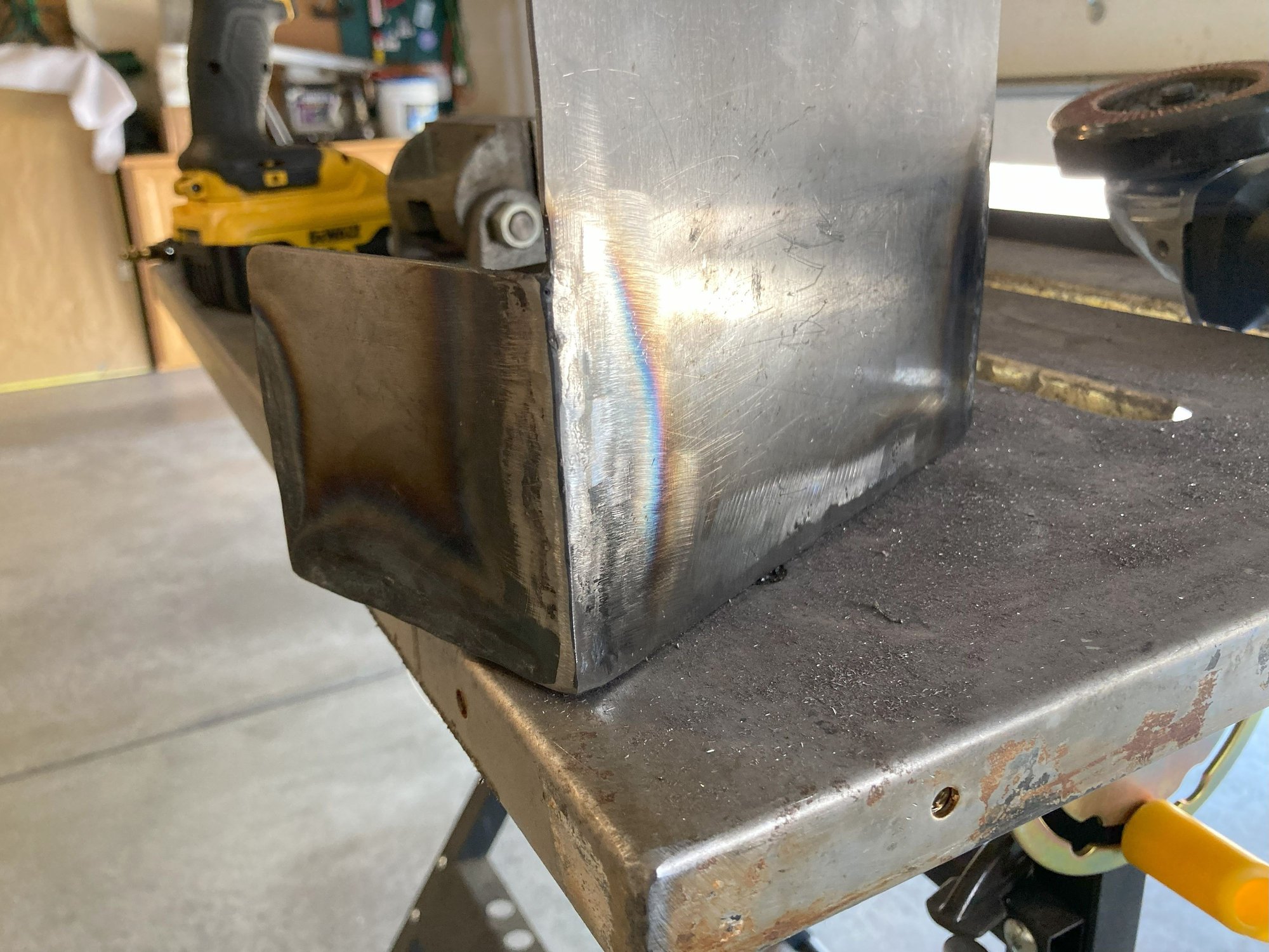

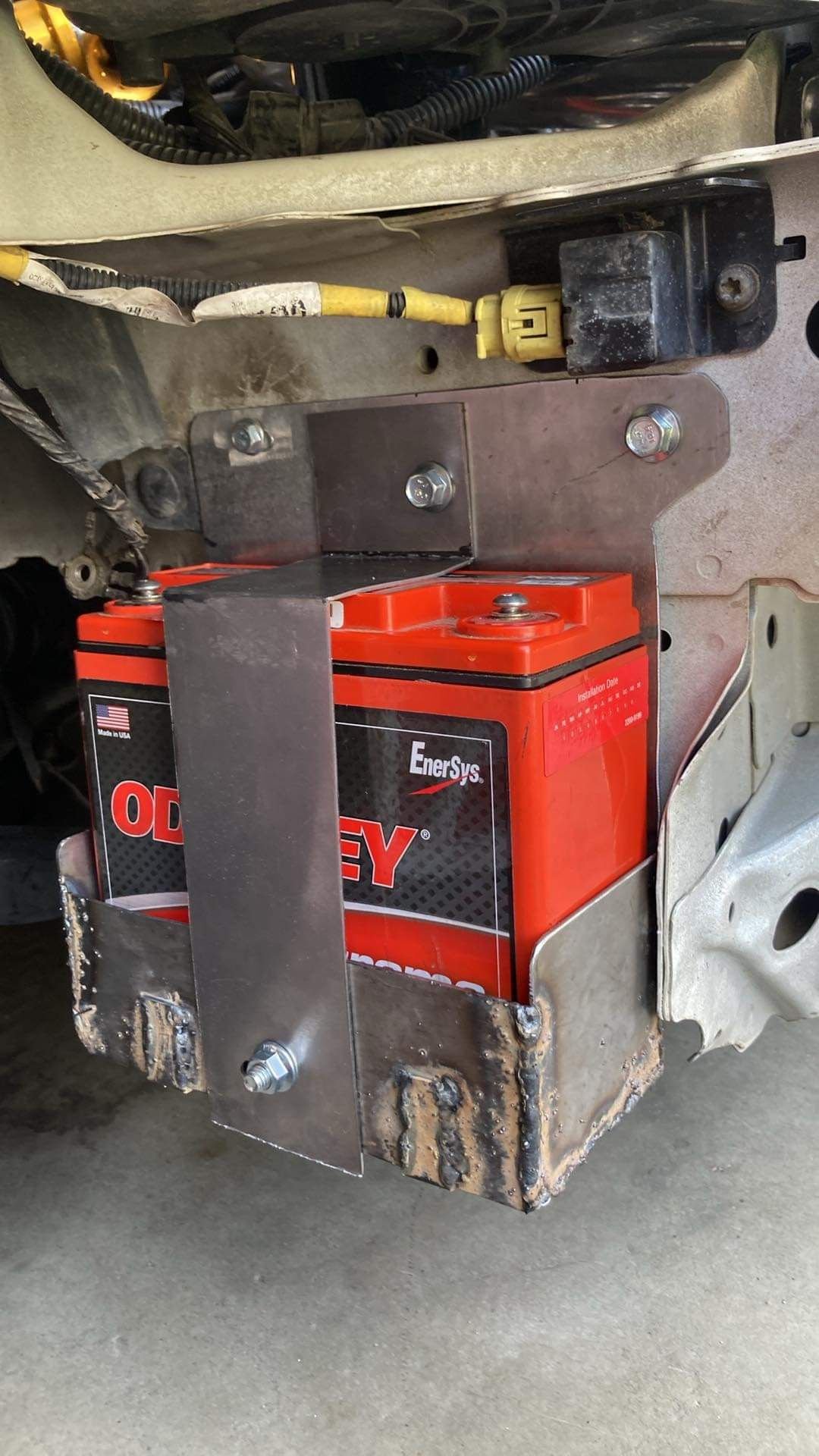

So I need to play with my weight to put more power to the ground. I started mocking up a battery relocation box (again). My plan is to put this Odyssey battery I have on the passenger side, in front of the tire against the frame. I'm hoping to get it finished this week.

Once again, a grinder and paint, makes me the welder I aint. I can't wait to get my own place, with 220 power and a real welder.

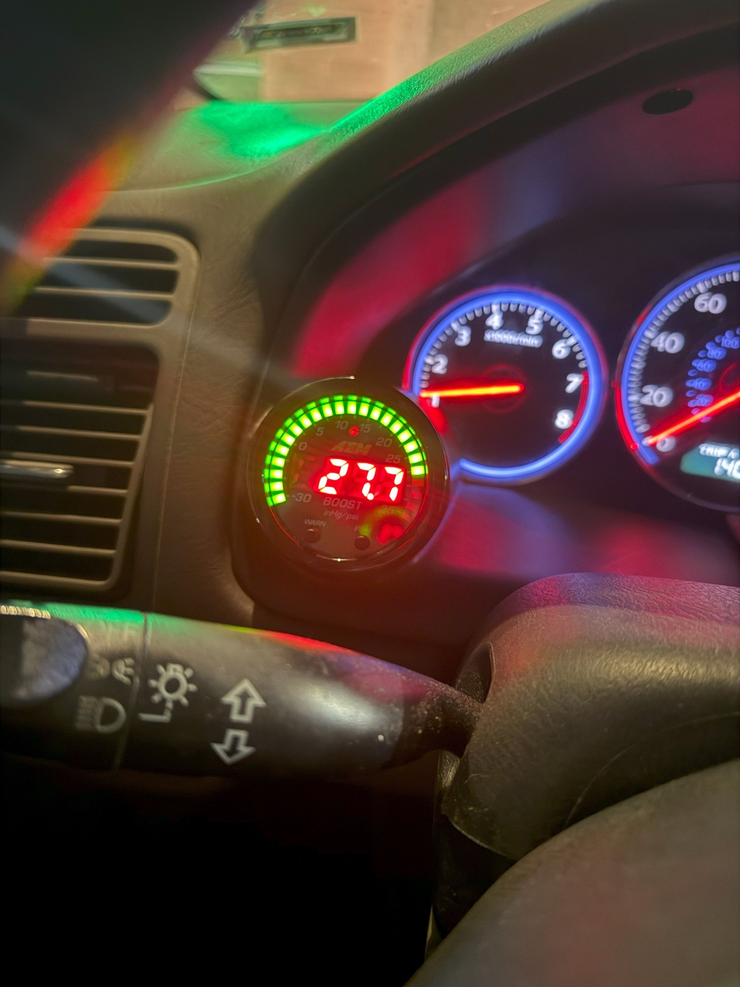

New digital AEM boost gauge installed. I now know how much boost I'm making since it has a peak recall function.
You could say we're making some power. lol

I checked the logs from my 28 pound pull and the IAT(post turbo pre intake manifold) got all the way up to 162F which was about 80-90 degrees over ambient. It's a little hotter than my liking, so I want to bring down these charge temps to boost efficiency. Ideas that I'm currently evaluating;
