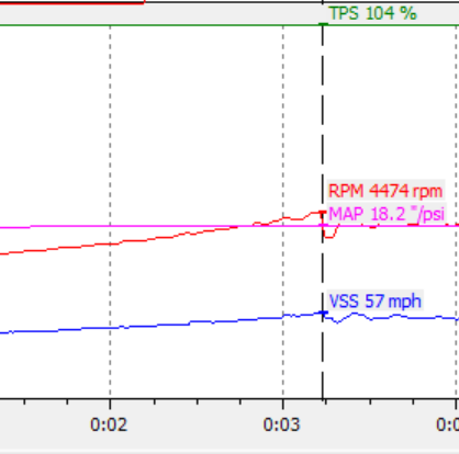

I hit 18 lbs of boost on a pull last night. Not sure how when this is wastegate pressure but I have the fuel so why not? But for real i'm going to pickup a real wastegate when I have the funds.

Is that 18.2 psi from full vacuum? 18.2 - 14.7 (atmospheric pressure at sea level) meaning ~3.5 psi of boost. K manager logger always reads boost from full vacuum for me and I have never been able to change it. Here is a snip from a random log I have. 21.18 psi shown, 14.06 psi atmospheric pressure at my elevation, meaning ~7.1 psi of boost. My tune gives a max of 8 psi at the top of second gear to try to minimize wheel spin.

Good question. I have my map reading in absolute, denoted by the "/ preceding the notation. So my map reading subtracts 1 bar from the calculation when in reality my local atmospheric pressure is closer to 12 psi since I'm right around 5280, so technically that map reading should be higher. But I digress. Ill have to dig into my settings to see what I did to change it.
I only boosted that high because I plumbed my WG side of the boost controller backwards. Good thing I hit boost cut before it ran to 30 PSI 😂

Absolute would mean full vacuum is 0, you would have to do the subtraction yourself according to the Kmanager setting. The laptop I use for logging must also be set to absolute but I cannot confirm at the moment. Either way, looking forward to seeing more on your project!

Got the boost controller lines swapped around, and low and behold I have a 8 pound spring. lol.
But my tuner did confirm my 18.2 lbs of boost reading. 🤡 He also confirmed that I semi know what I'm doing in terms of tuning. (lol)

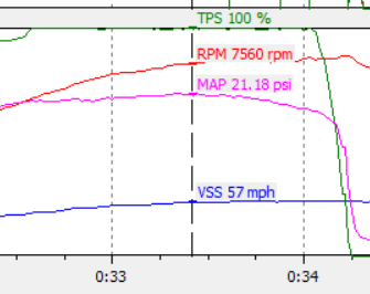

Ok so quick update, I made it to the local track for the last test and tune before they tear the track down. Unfortunately I only got one pass before the rain rolled in and they called it. But that’s the bad news. Good news is on 5.5 pounds of boost and no adjustments to timing tables I ran the quarter shy of 3 seconds faster than when the car was N/A. Not “fast” by any means, but it’s a starting point. I’m left lane on both.
