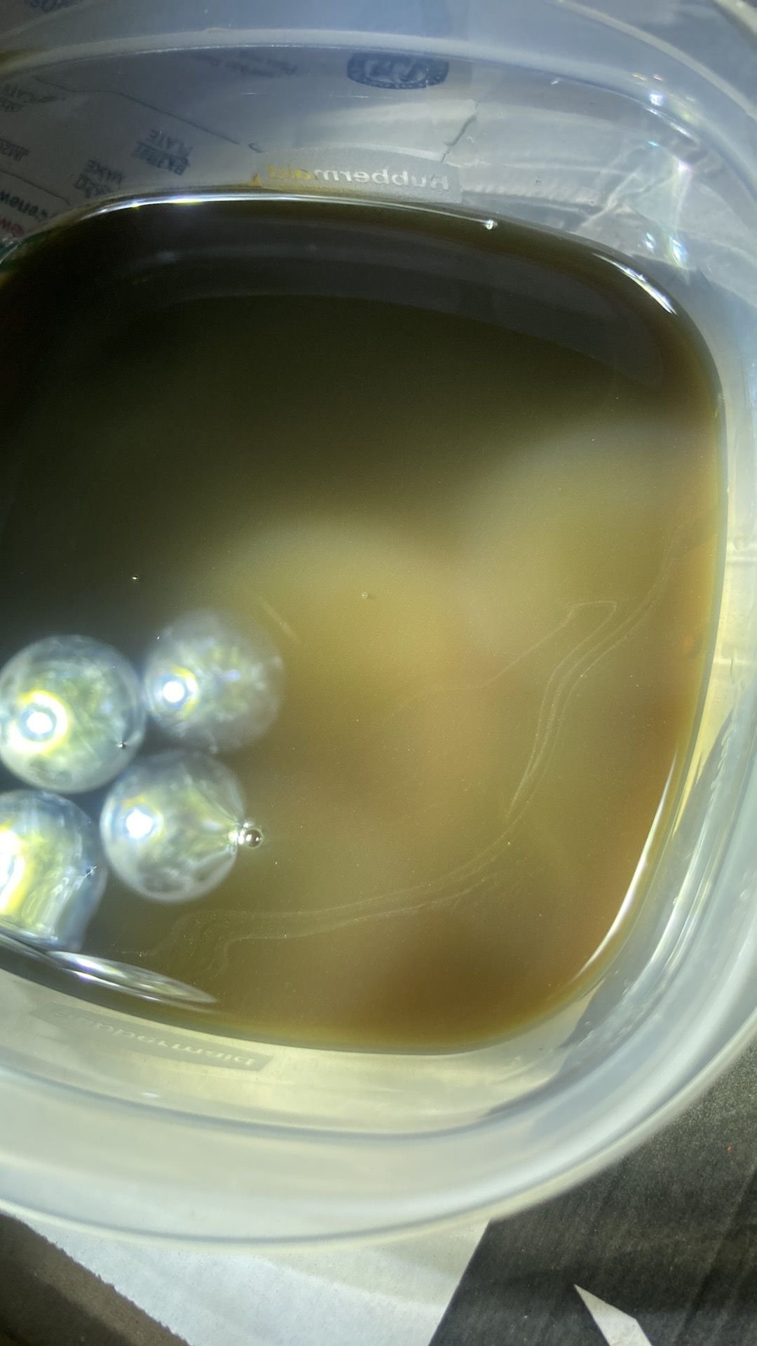

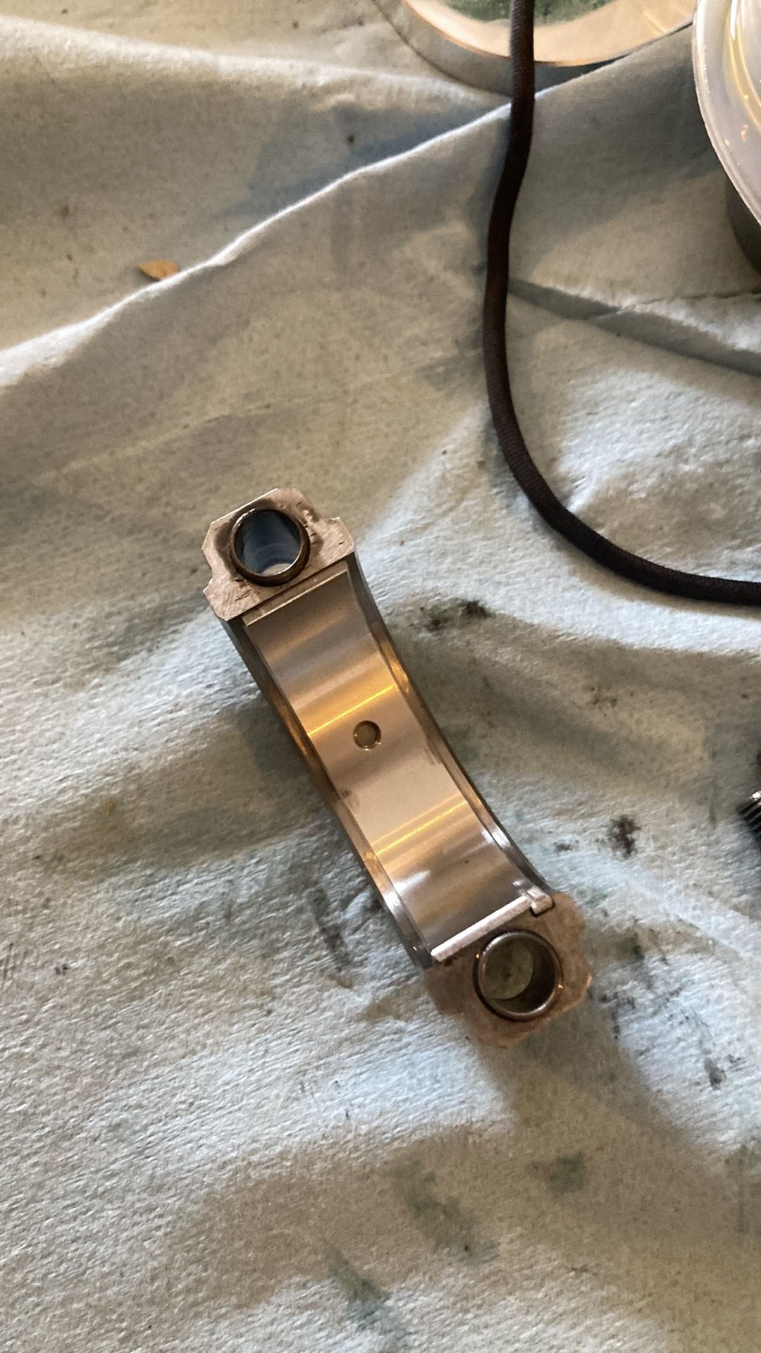

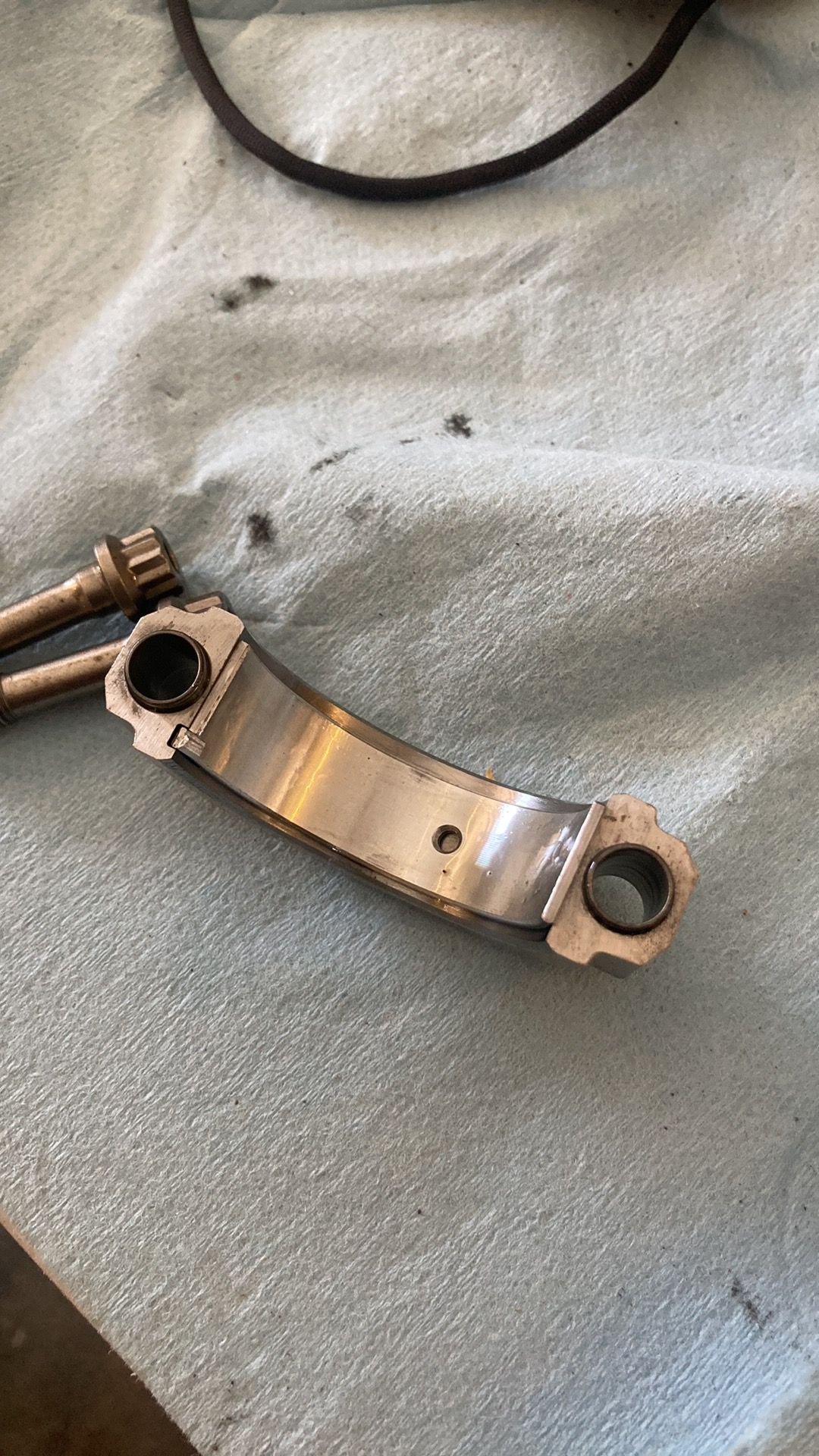

Not great, not terrible news. Got some Metallic flecks in the oil but no chunks in the pan.
Rod bearings are all fine. I'm going to pull the girdle tonight or tomorrow and check the mains. I might rest this evening since I already got the pan off.
Then ill peak inside the pickup tube and see if the oil pump is intact.

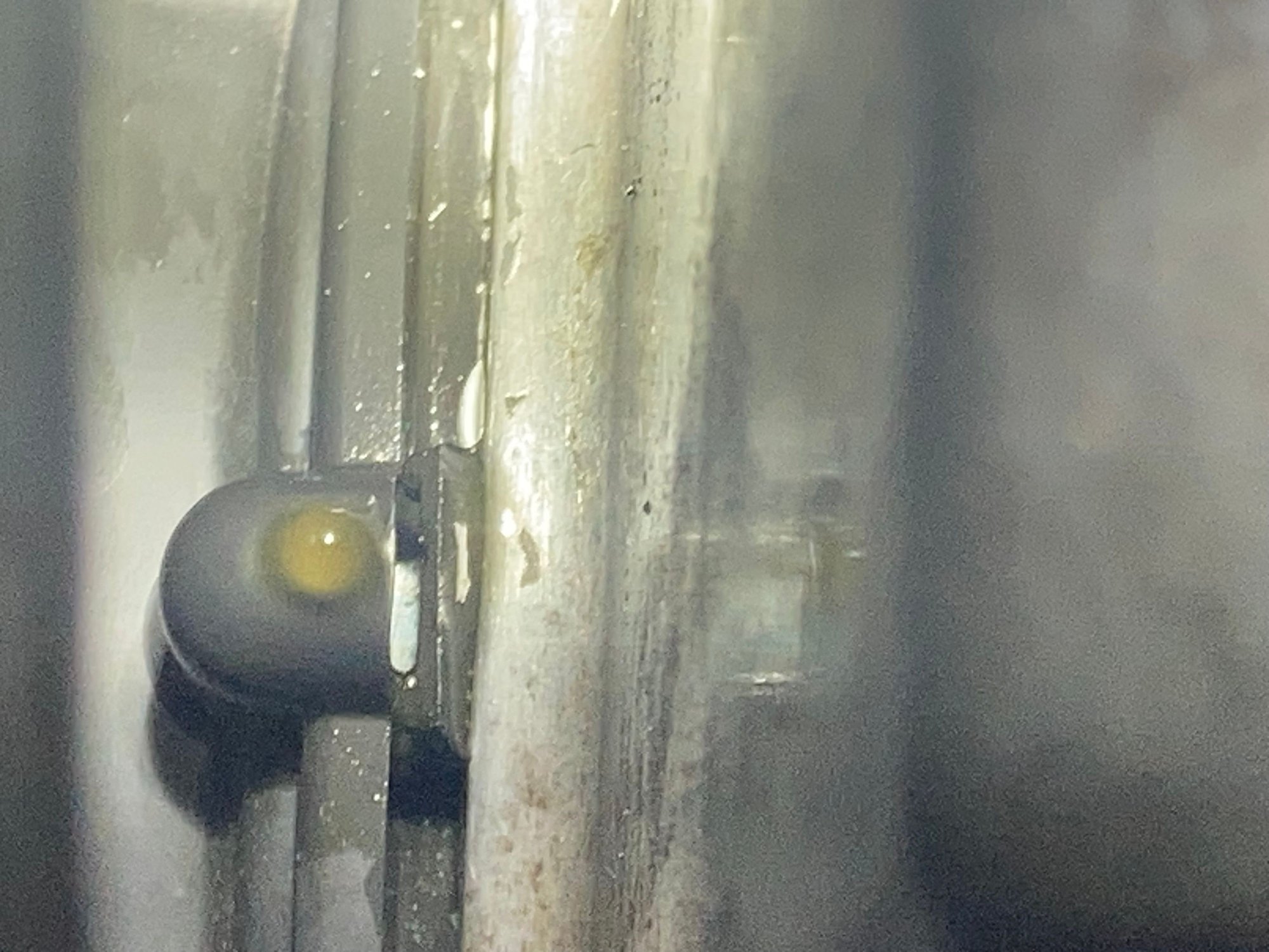

Quick update. Bottom end was inconclusive. Both rod and main bearings look A-OK. Oil pump is not in a million pieces, and my pickup tube isn't cracked.
However I found a loose motor mount bolt, and a leak from the oil filter sandwich plate. The same sandwich plate that houses my aem oil pressure sensor.
Either way I ordered a couple OEM Honda Oil filters that arrived yesterday. I'm going to inspect the sandwich plate gasket and re torque it, then using an oem filter do another change using the Liquimolly Euro 5w-30 i've been using for break-in.
I'm starting to wonder if I had a couple different symptoms that mimicked something worse. Car will be back to running the 1st half of the week. Ill report back then.
