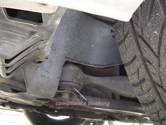

you can see the lca bushings when the car is on the ground too. just stick your head in back of the wheel. mine are beefy ES bushings not the weak oems. thats why they look so big. yours will be almost hollow and you can tell if its broken by checking the legs connecting the center to the sides.

Re: Loud Popping Noise?
seems okay from the pics from whats visible. try and poke around to feel the rubber, see if you can notice any cracks or pieces falling off.
