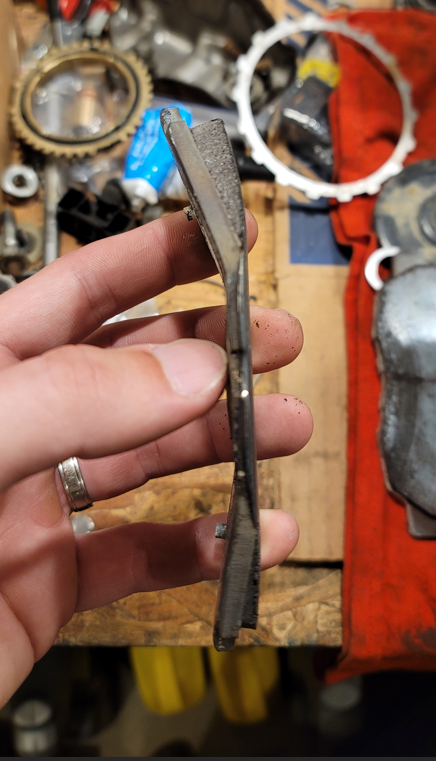

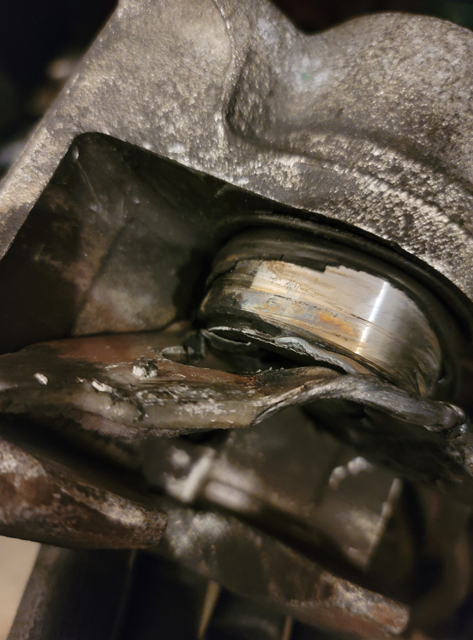

Next track day I switched to Hawk Blue 9012 pads. This seemed to be a jump over the EBC Bluestuff pads. In this configuration, they can almost last a full session. Some very slight fading would occur towards the end of a session but nothing too bad. However, pad life wasn't great and I also experienced some pad deformation. Looks like the pads got so hot they expanded and were pinched in the caliper bracket. When the piston pushed in the middle of the pad it started bending. The inside pad that contacts the piston welded itself to it. I had some abnormal brake noises but no real braking issues like this. This was finally the straw that broke the camels back, I'd had enough.

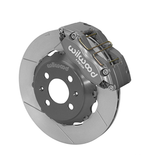

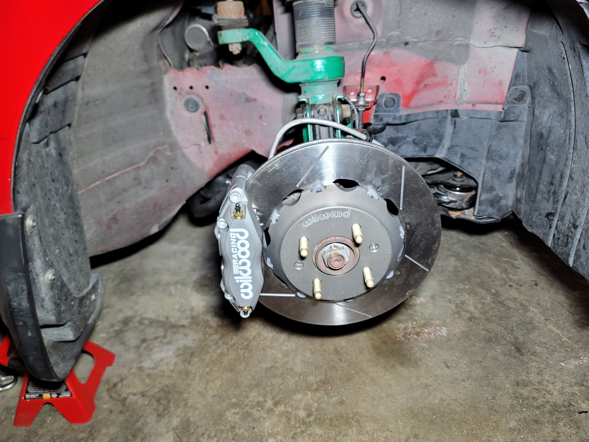

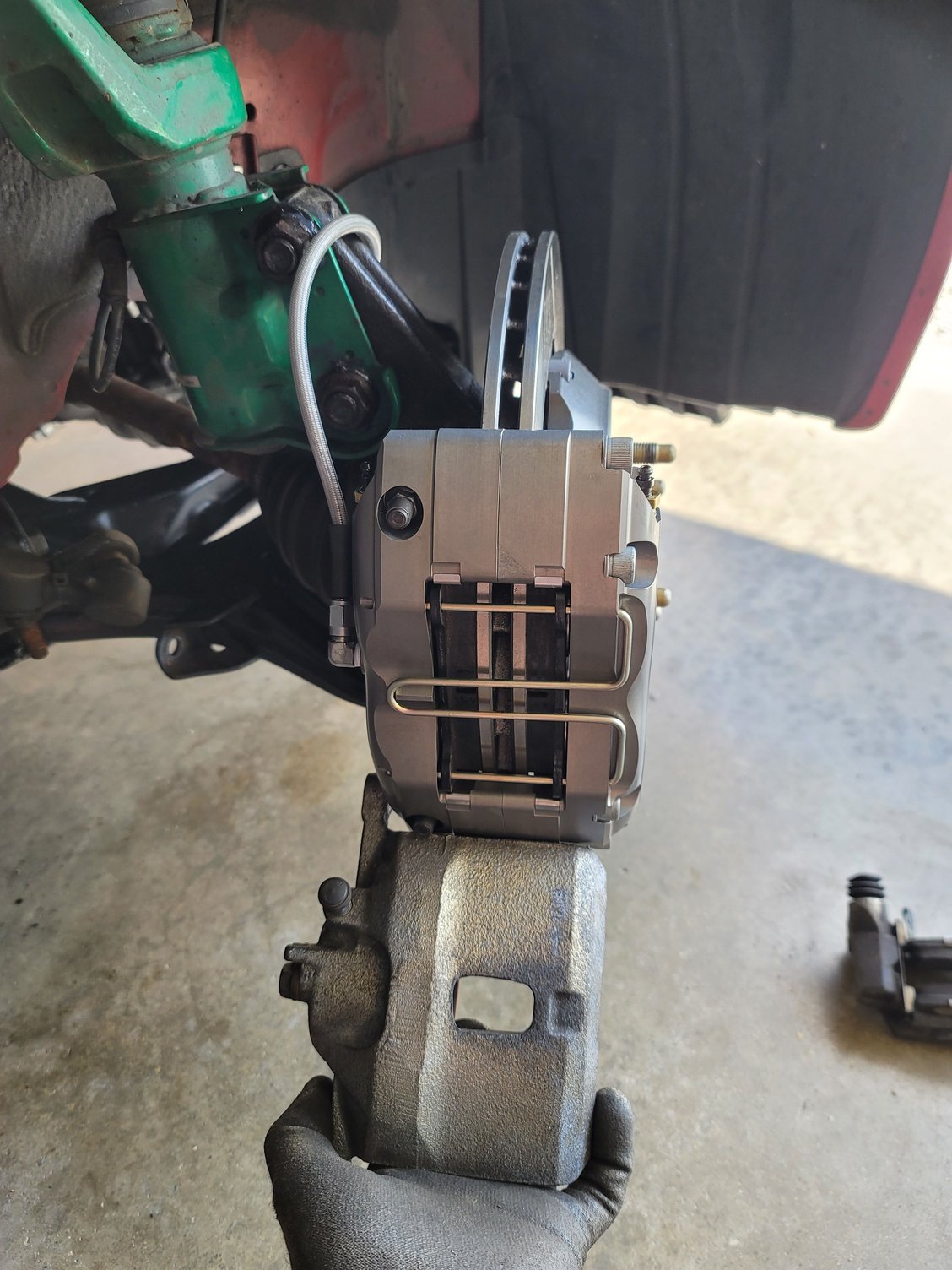

Over the winter I finally started looking for upgraded brake kits. Purchased a Wilwood Race set, part number 140-14940. These were eye-wateringly expensive at about $1850 with the hose kit and an additional set of street pads. This uses a ~300 mm diameter curved vane slotted rotor, stock is 262 mm. Calipers are radially mounted, 4 pot with their Thermlock pistons to help with temps. Comes with BP-35 racing pads but I will swap to BP-10 for street/autocross use. Still in process of installing but will update later on.

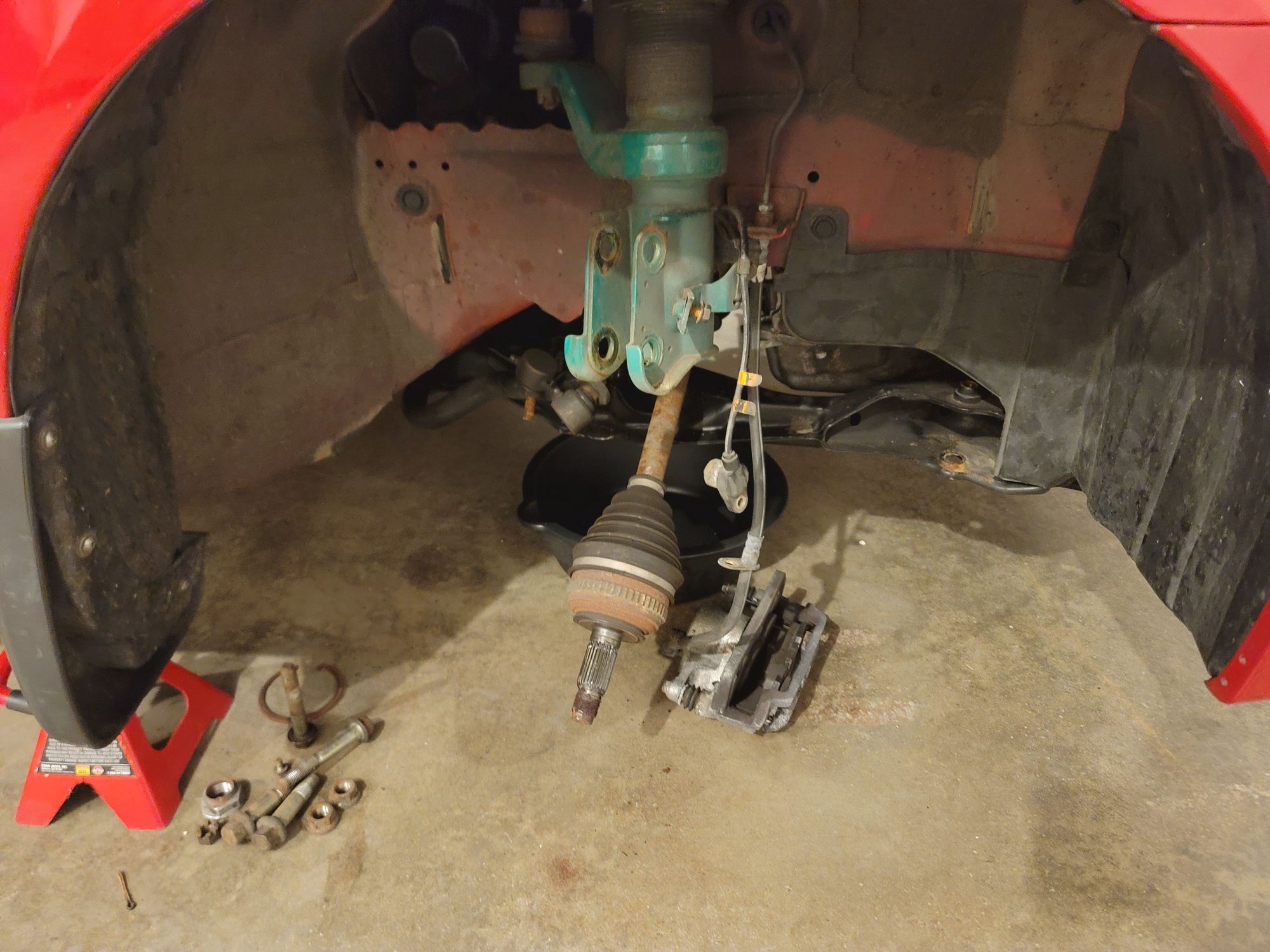

At a track day a couple years ago I had a wheel stud on the driver's side break while swapping tires before driving home. Only way to replace studs is to pull the hub. I went ahead and replaced the wheel bearing as well. Studs upgraded to ARP. Well, new two piece rotors are offset inboard further than stock rotors. They interfere with the dust shields. Only way to remove the shield (without cutting) is to pull the hub. Since I previously only did the driver's side, I decided to pull the passenger's hub. This way I can replace the wheel bearing, upgrade to ARP studs, and properly remove the dust shield. I consider it a miracle that I managed to get the snap ring and wheel bearing out of the passenger's hub. I've never changed it and the body has ~320k miles. It took everything my 20 ton hydraulic press had to get the old wheel bearing out. Driver side dust shield will likely just be cut unless I'm feeling extra motivated.

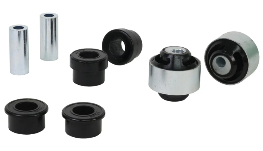

While I'm working on suspension I also decided to upgrade the control arms bushings to a set from Whiteline. The forward bushings have an offset hole to add ~0.5 degrees of caster. This is supposed to help with high speed stability. Plus the bushings should be much stiffer than stock which will hopefully help with some torque steer. If not, they were only $120. I wanted to get roll correcting ball joints as well but was surprised they were over $200. I can always do those later. Hopefully tonight I will get the new wheel bearing in, studs and hub pressed in, and control arm bushings installed for the passenger's side. Then I can actually get to the brakes before moving to the driver's side.

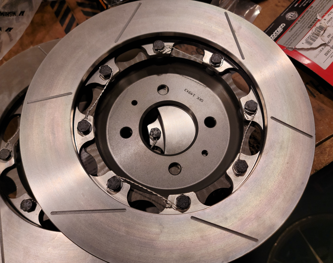

Didn't get much work done last night. Got the rotors bolted together. Red loctite then torqued to 220 in lb. Safety wire installed per instructions. First time ever using the stuff.

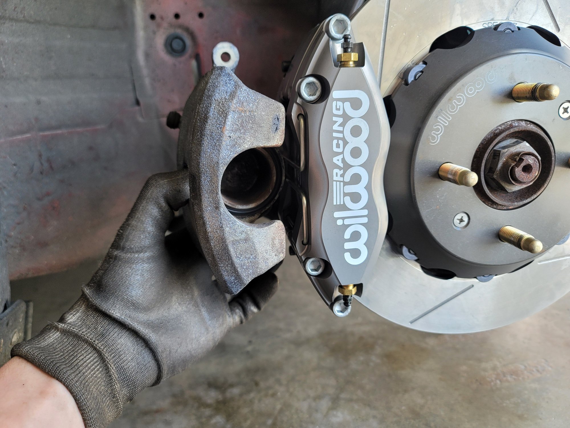

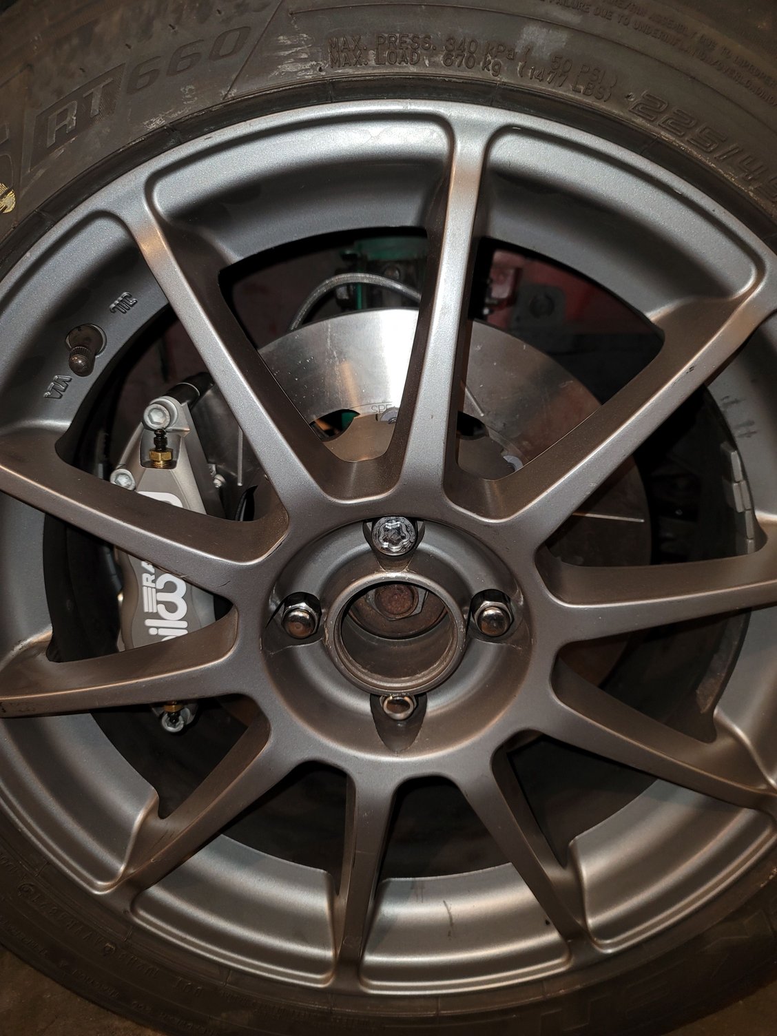

Finally finished up the install on Saturday and went to an autocross event on Sunday. Brakes feel great. Pedal feels much more responsive than before. I installed Wilwood's basic street pad for now (BP-10). The kit came with a set of racing pads (BP-35) that I will swap to for track days. Here are a few more pictures.

First track day in the bag. I am happy to report these brakes had zero issues. This is a smaller track, I had boost limited to 6 psi probably in the neighborhood of 310-320 whp, only reaching ~100 mph on the back straight. However, this is the same track I ran last fall with the old brakes and I had issues.
These Wilwood's with the BP-35 track pads bite hard. With a small amount of brake pedal input it sure throws your forward. Brakes felt phenomenal throughout every session. I shaved 1-2 seconds off my lap time just with these brakes. I will be going to another track in about a month that has a much longer straight. We will see how they perform there.
