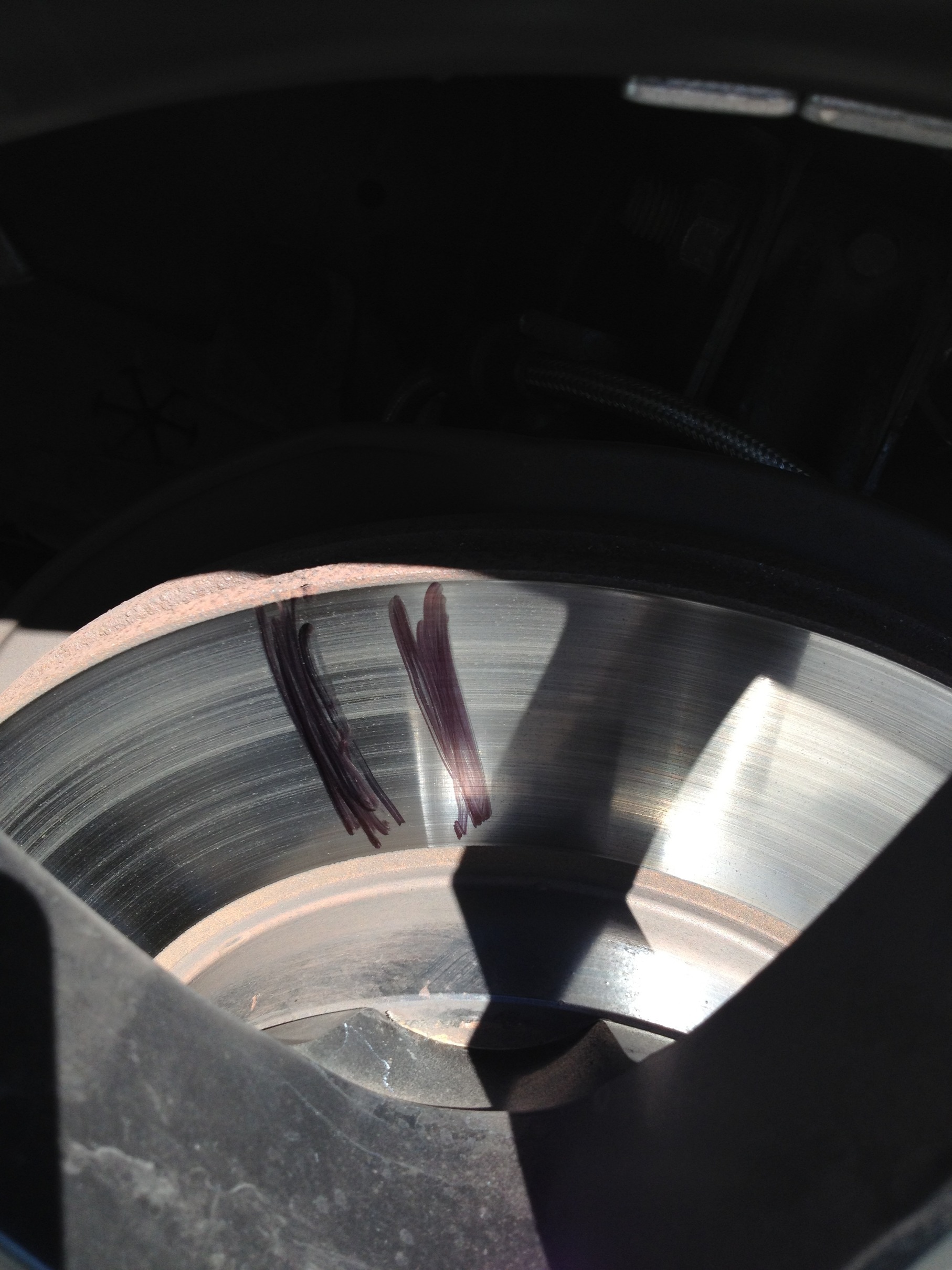

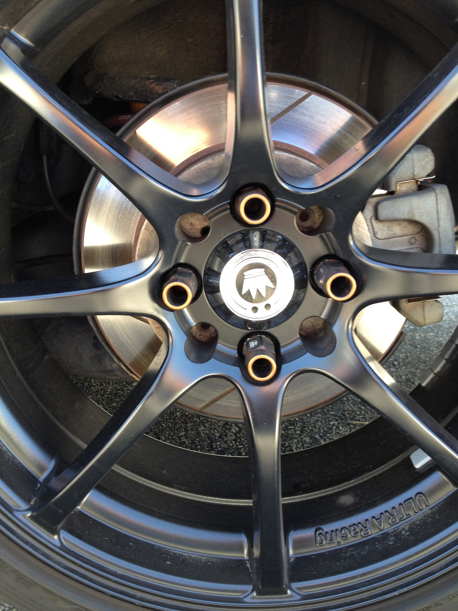

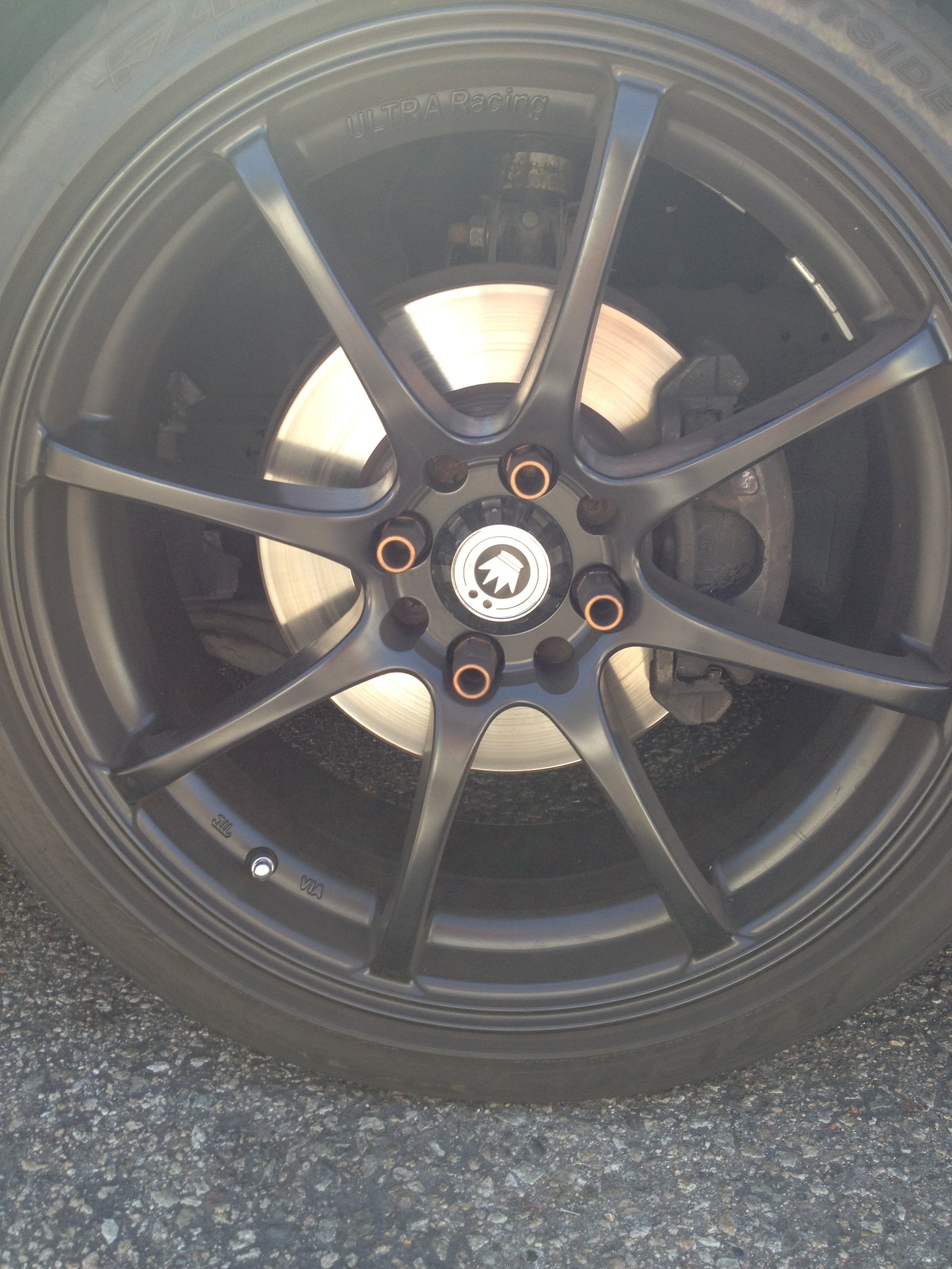

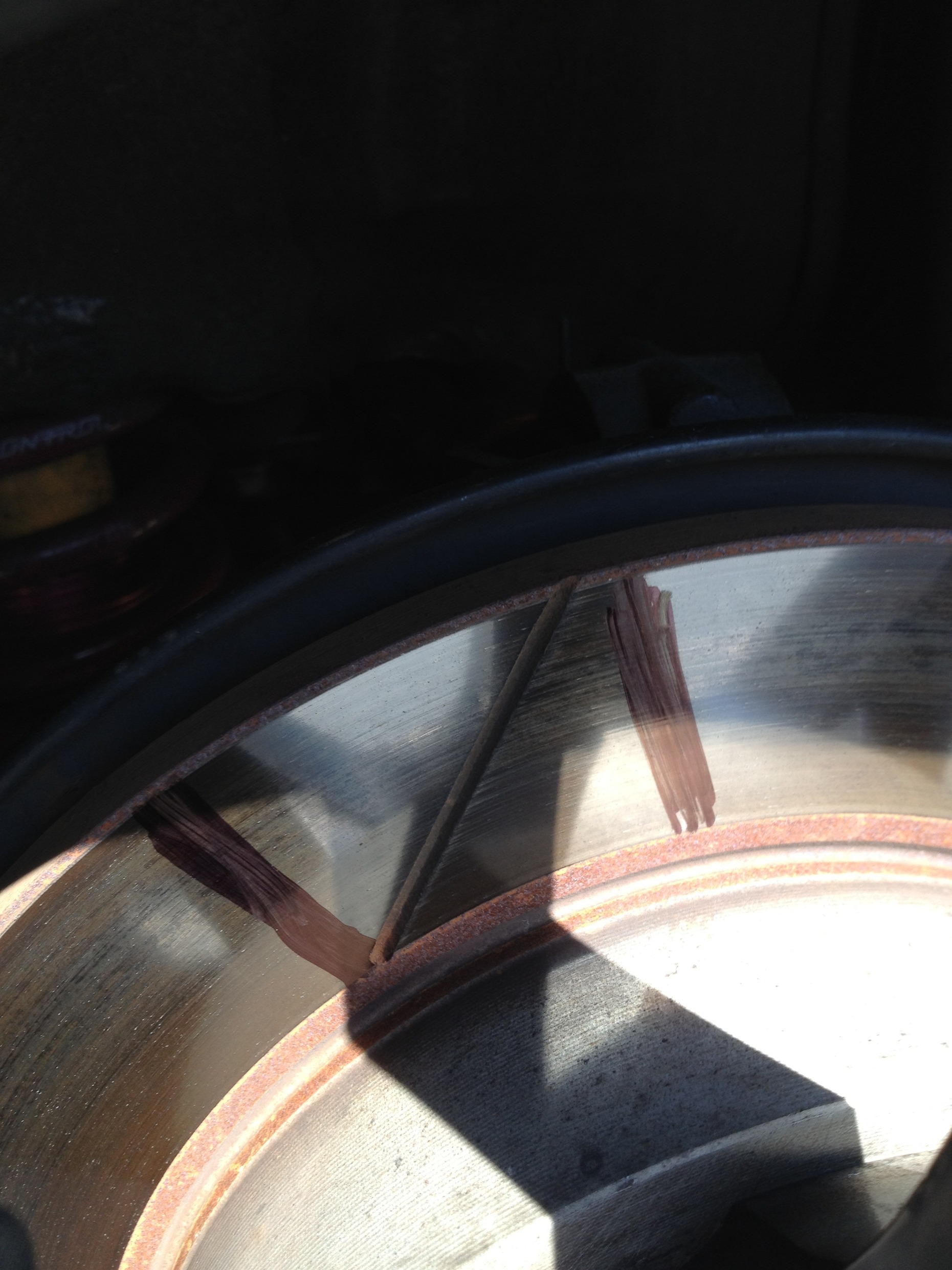

Here is the test that was requested. I did 3 "stops" (more like slow down to 5 mph). All three were normal stops. First one was from 15 to 5, then 25 to 5, then 45 to complete stop.
I marked it with two thick lines of a sharpie
Front
Rear
After 3 stops...
Front
Rear
As you can see it has taken the marker marks completely off.
So as a result the problem you are experiencing is not an "increase more rear pressure" but in fact is a "need to bleed all the air out of your system"
