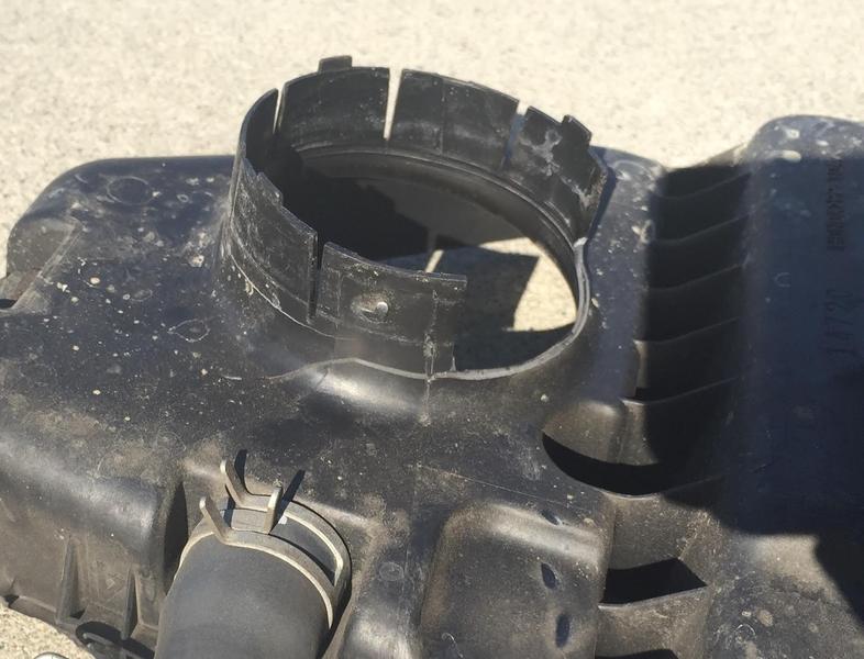

Looks like I need to add a new airbox to my list. Pulled mine off to get access to the throttle body and get ready to remove the head and saw this
I got a spare one if you need it, it's looks like you just the need part that holds the filter on the thottlw body
Generous of you, thank you! Yes, it is the lower part of the airbox that holds the air filter and connects to the throttle body.

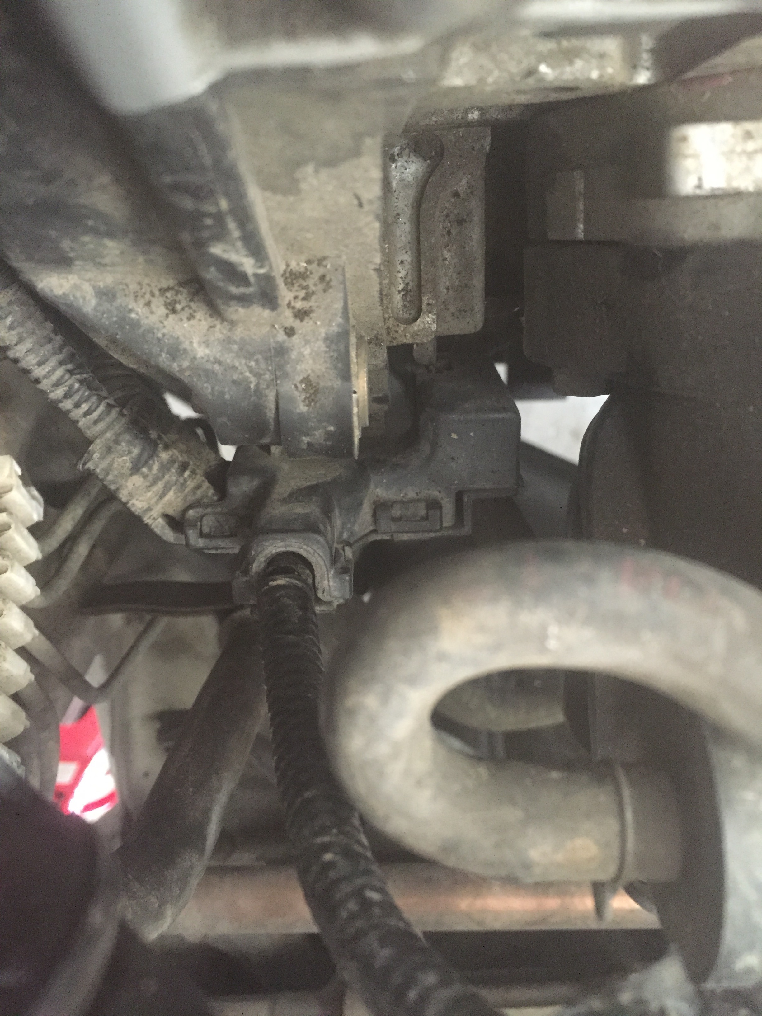

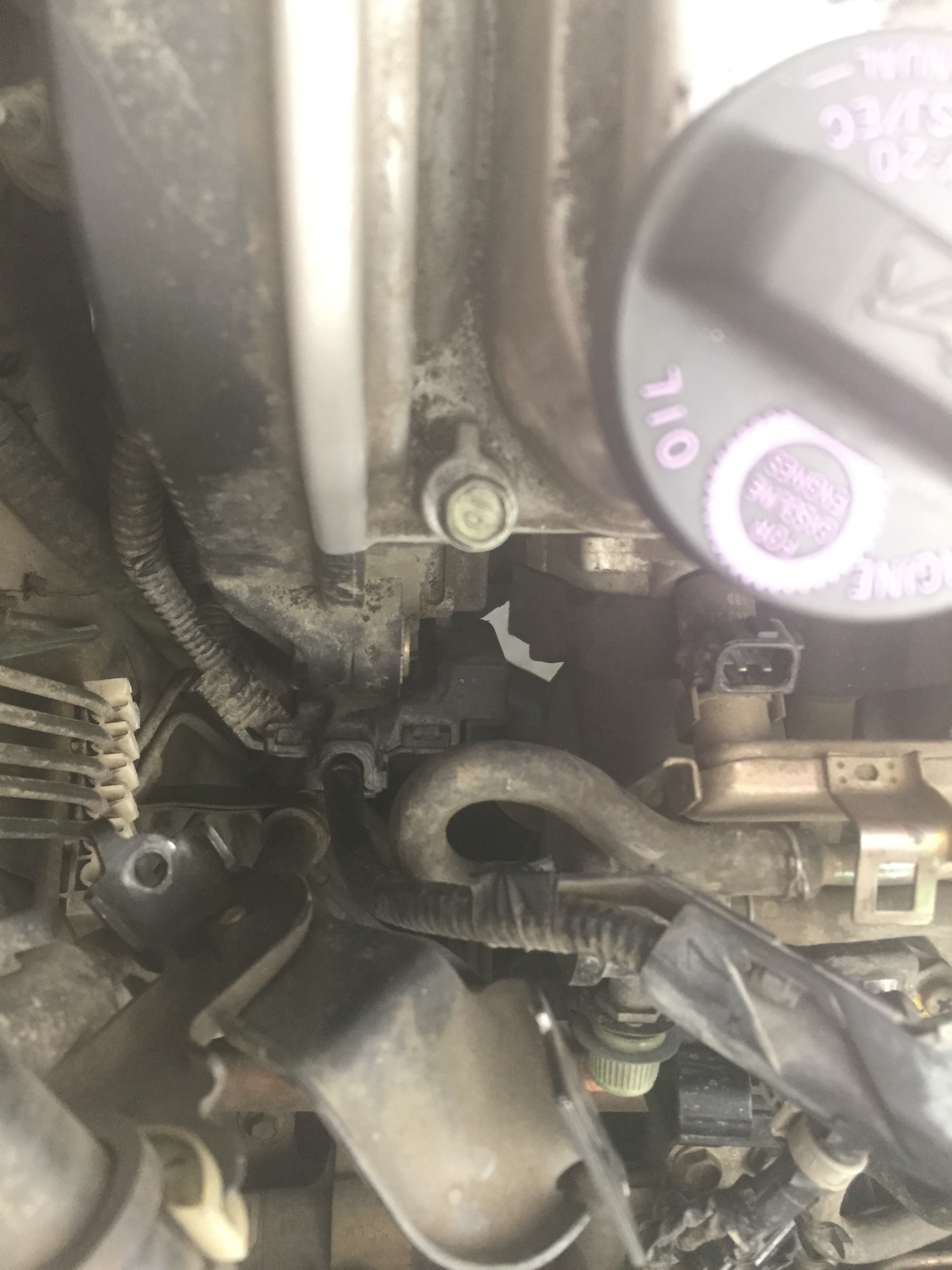

Help, got stuck!.
I've been making slow but good progress. Got the throttle body, exhaust manifold and the thermostat housing (not sure what you call this part) removed.
I'm stuck trying to get the wiring harness out of the way. The wiring harness that connects to the ignition coils and fuel injectors. On the drivers side behind the valve cover, the wiring harness connects to some junction and I can't figure out how to free it. The wiring harness gets in the way of easy access to the intake manifold, so it feels like it needs to be removed, or moved out of the way, and this is the last piece that is keeping me from doing so. Anyone got any advice?
I've attached a couple of pics, one from a ways away so you can see the position, and one a little closer.
ID:	87776   Click image for larger version
Old Jun 6, 2015
Re: Major overhaul after 250K miles...
IIRC there's a tab that needs pushed (or pulled) to let it release from its mount, similar to several other connectors that attach to metal tabs.
I unbolt the intake and pull the head out by itself though.

Still looking for ideas on how to remove this wiring harness. Anyone know?
Leave that harness block attached to the engine, and disconnect and remove all the rest of the wiring from the parts you will remove (intake manifold and whatever is attached to it).
Have you got the wiring stuff away from the valve cover, valve cover is completely unobstructed? The rubber gasket may just be stuck to the head. You may need to do some prying to get it to raise up.
Thanks Ezone! Took your advice. Got the intake manifold off (PITA getting to some of those bolts). And borrowed a rubber mallet to loosen the valve cover and get it off.

anything left to do before I pull off the head? BlueEM2's write up mentioned replacing the camshaft seal and needing to remove the camshaft gear and the back cover. Should this be done before removing the head?
Took a look at my intake manifold and it is pretty gummed up. Any advice for thouroughly cleaning it?
I have the tools to do it either way.
I clean the carbon out of the ports and EGR passages in the injector plate. I don't normally see a need to mess with the actual intake manifold, but you can do whatever you want.
Also, my usual goal is to get the customers car back on the road in a timely manner, not do a total restoration LOL.
HTH

Took a closer look at things and the intake manifold doesn't look bad, its the part that it connects to (probably the injector plate you mentioned) that is metal that actually mates to the head that is all gummed up. Been using some throttle body cleaner on it.
In this case, I have time, and want to get everything done right and in one shot if I can.
Old Jun 17, 2015
Scrape it out first while it's dry. (Might be too late now.)
TB cleaner just makes everything gooey. LOL

Thanks ezone. Scraped it out. Looking better now.
