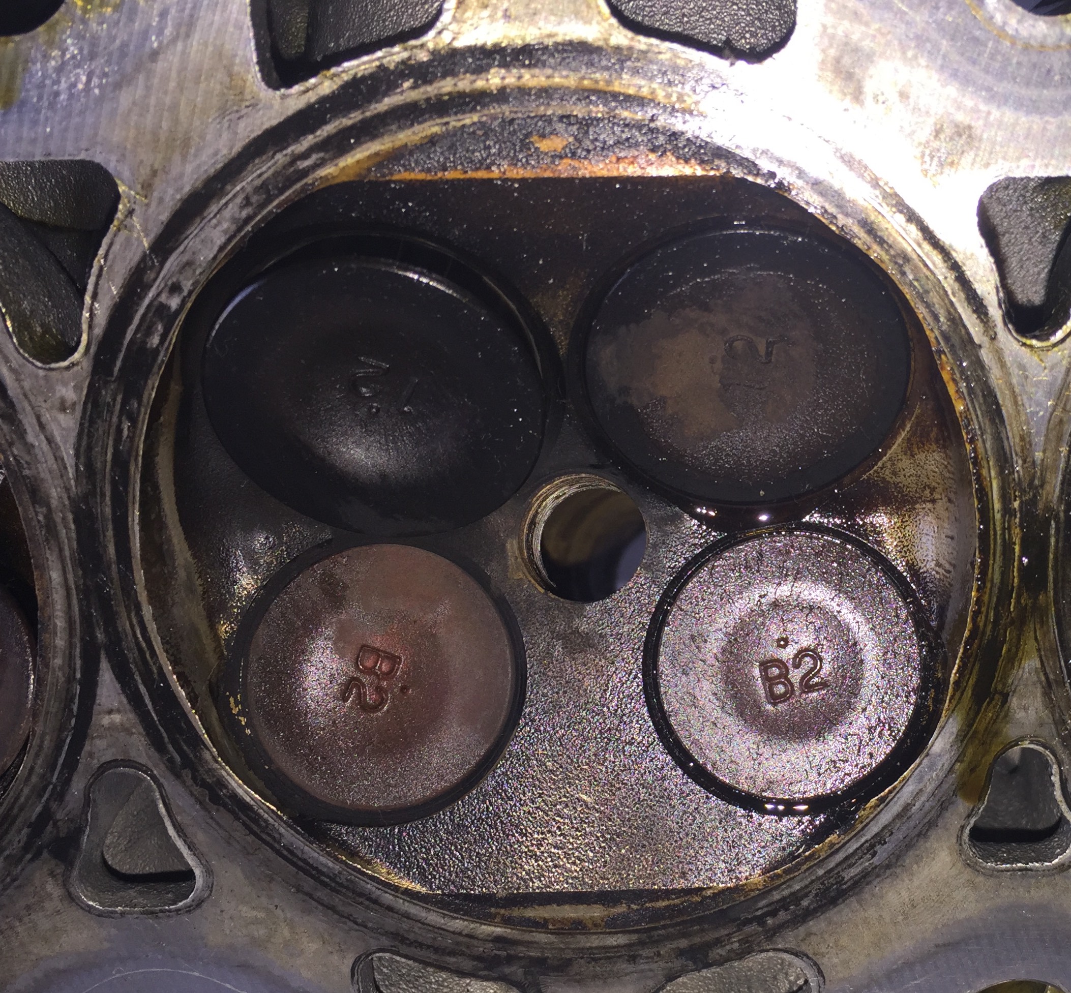

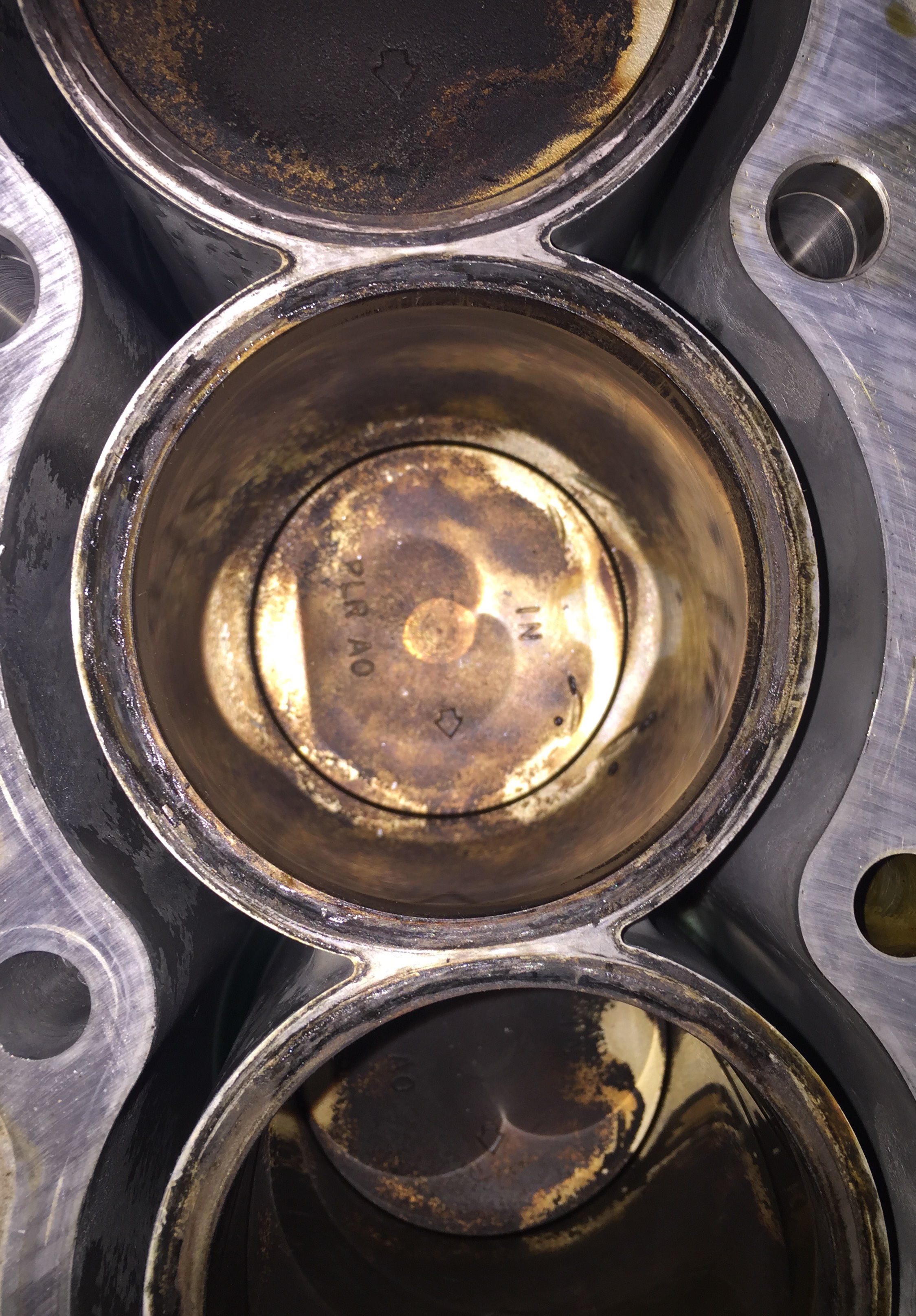

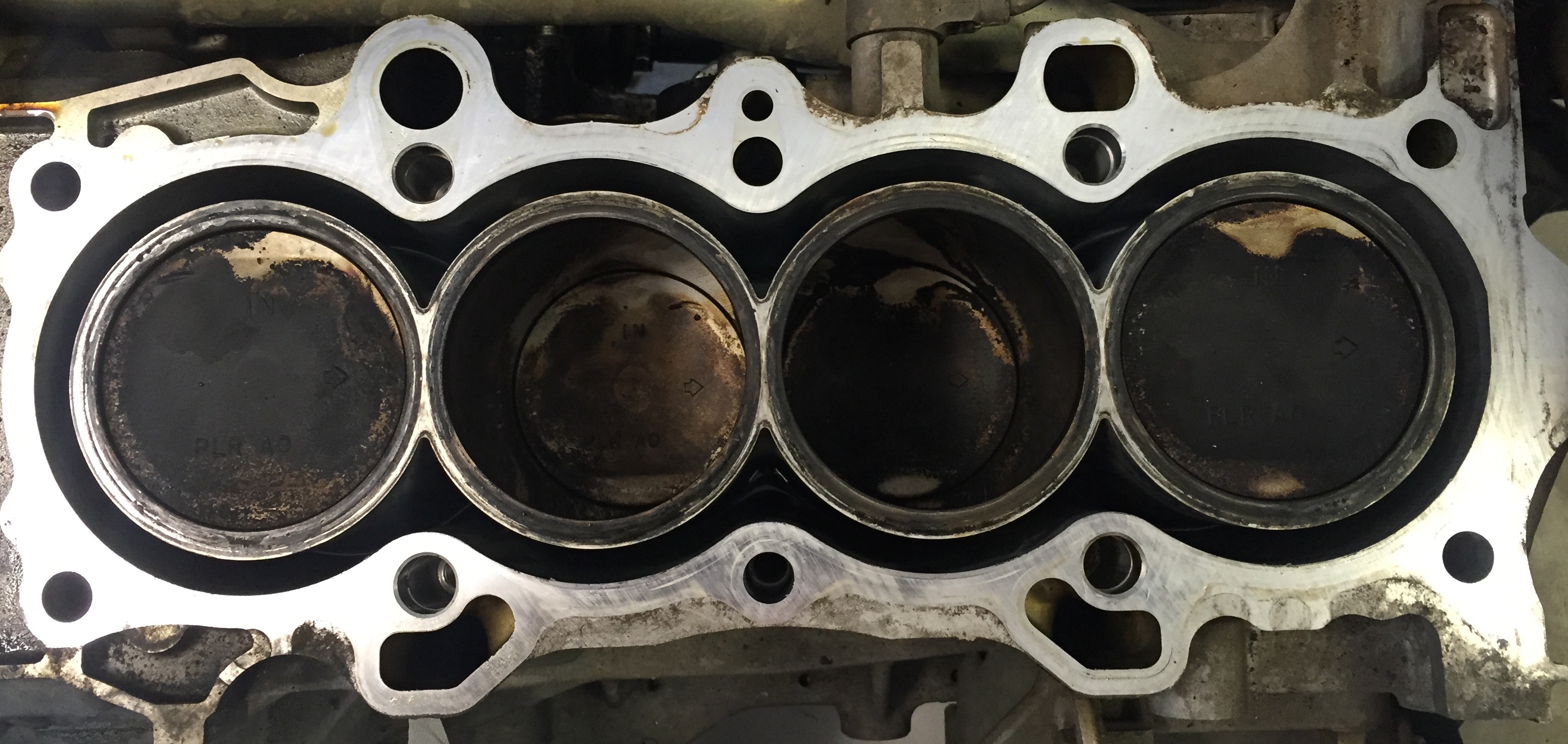

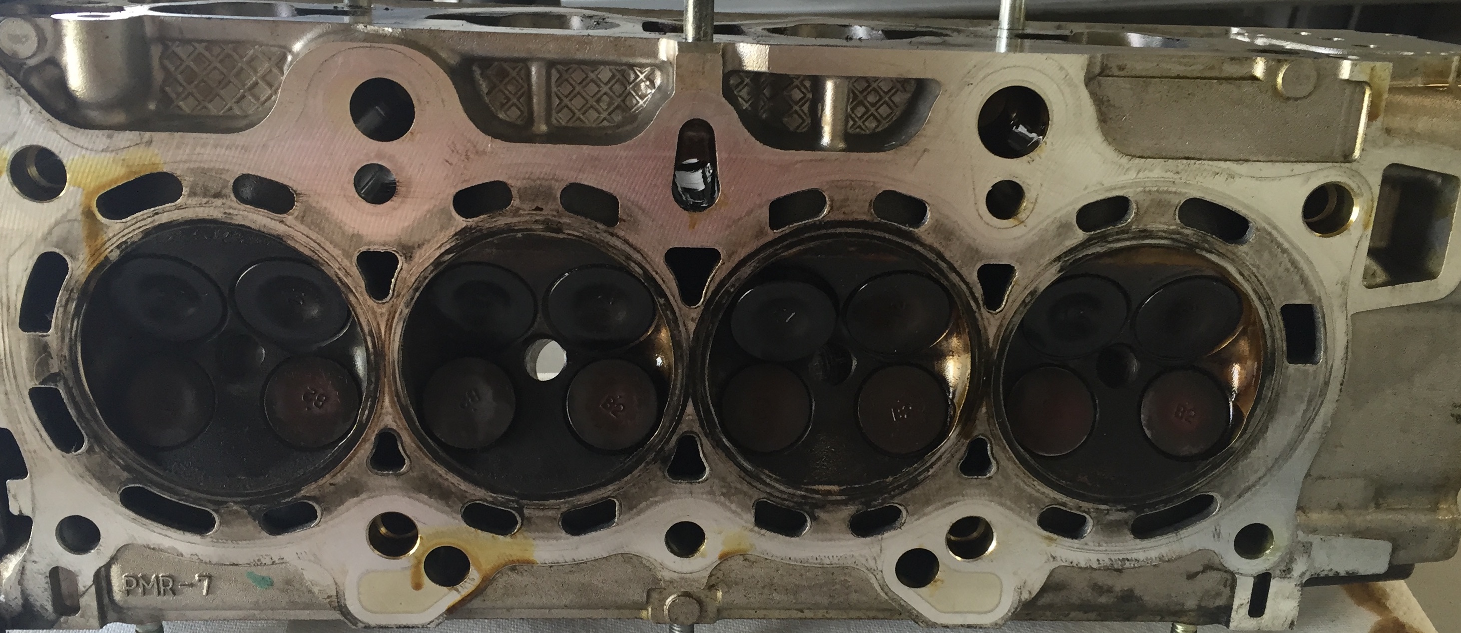

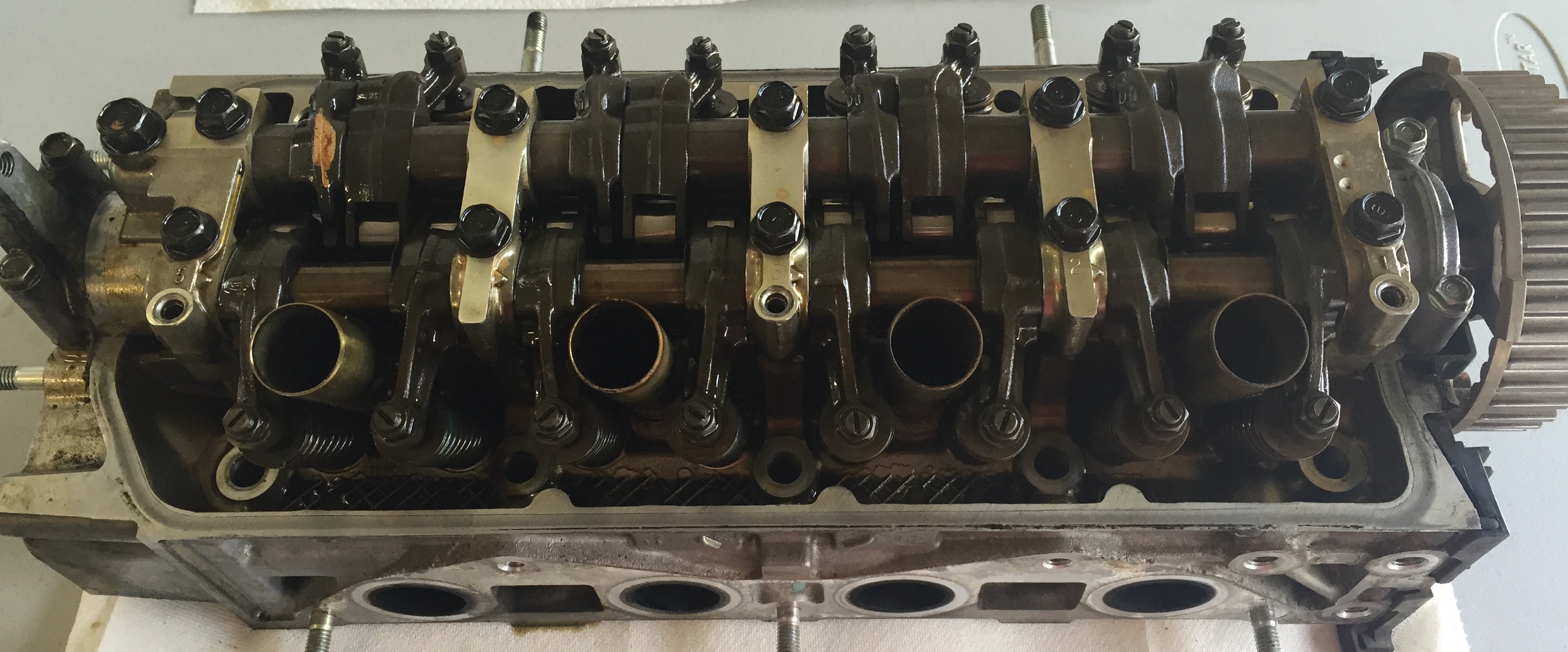

Got the head off. Some pics coming.
So the big question I have is should I continue with my plans to take the valves out, clean em up and reseat them. Thoughts? Pointers? Haven't found a good thread yet on a 7th gen DIY valve job. Thinking I want to do this while I have it open. Not sure if I need to replace the valve springs. Remember, this engine has 250k on it...
Pics of the head, block, valves, etc attached...
