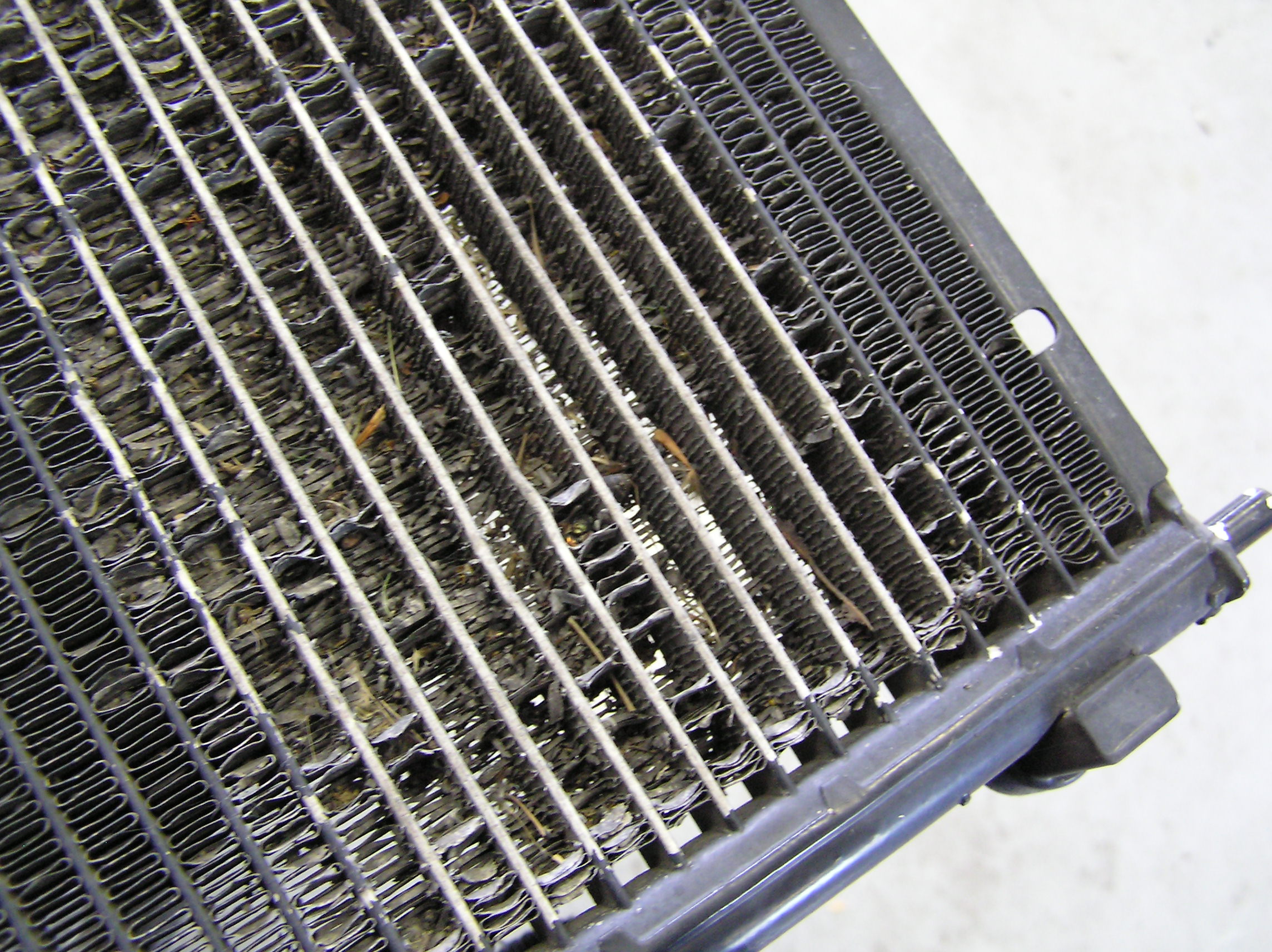

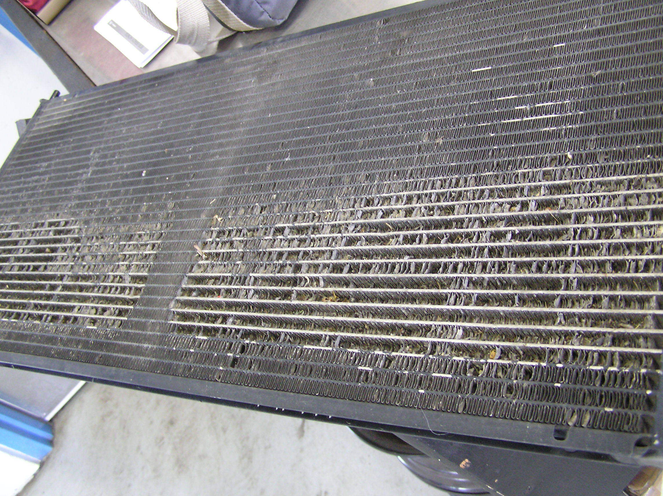

For laughs, this is a condensor I took out of a Honda Fit with about 250,000 miles on it.. The damaged area was all you could see through the opening in the bumper

My condensor doesn't look great, but it doesn't have damage like that. Some of the fins are starting to flake off on the top, but there is no real "damage"
