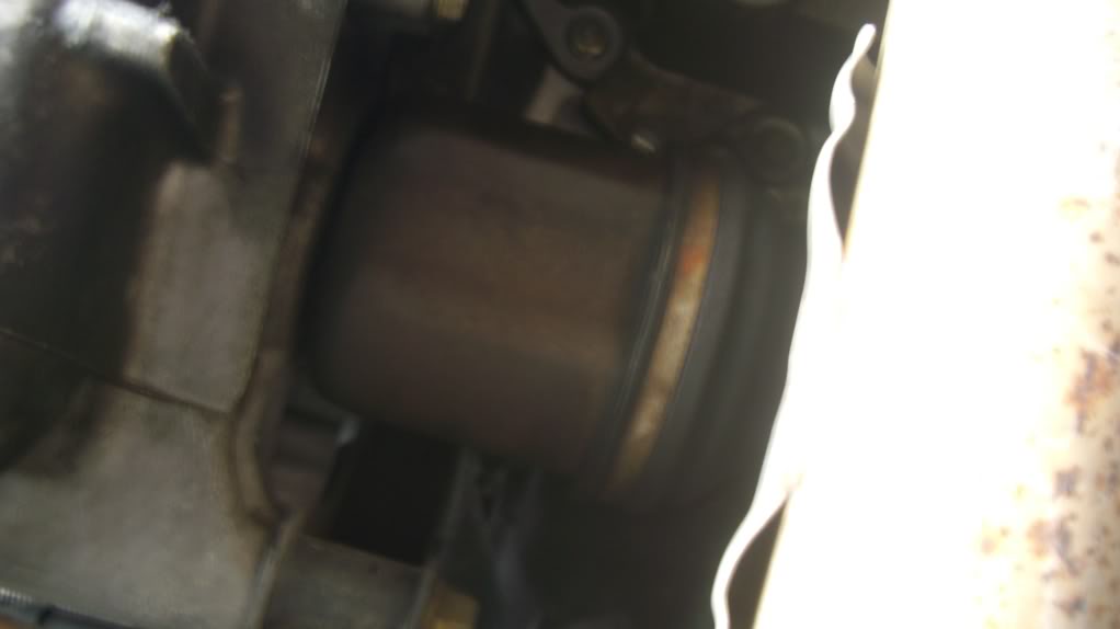

After checking the car for a few hours, this is what I found.....
I cleaned the brake system (rotors, pads, pistons and calipers.... it doesnt have shims), and visually check the brake line to make sure nothing was touching it or hitting it.
Looks like nothing was bad on the brake line or the brake system.
This happened at the left side...
To my surprise, my brother came to ask if I found something wrong so I said no. Then, he started to check everything on the brakes and then he went the drive axle. He got the drive axle with his hand and started moving and shaking it in all directions so we heard this noise very similar to the one I hear when driving the car and pressing the brakes. Sounds like if the axle is a little loose. The noise came from the axle or bearings where you put the tire and also from the other end (close to the transmission).
I check the right side and the axle also was a little loose and made the same noise in both ends (where you put the tire and by the transmission).
As lazlong said, I cant think of anything else so I am pretty sure it will be a bad axle
Is the axle supposed to be a little loose??
Or it doesnt have to be loose at all and it doesnt have to make any noise?
These pics are only from the left side.... The right side is the opposite with the only detail that the axle is a little smaller because the transmission in closer to the right side.
You could see my hand moving the axle

This is one end of the axle by the transmission
This is how the end by the transmission looks. (pic taken from the bottom)

The axle is supposed to be very slightly loose but, you shouldn't be able to move it as much as you're saying it's moving though. Especially if it's making a very similar sound. If you can move it that much and hear it then it's already damaged. If you can ignore it then it will last a while before it gets bad (I drove around in my '88 hatch for 3 years on 2 bad axles. lol). If not, I recommend a new axle, and oil seal (where it goes in the tranny). Also get a clean catchpan for the tranny fluid when you take that end out so you can put it back in. Inspect the tranny fluid and determine if it needs new fluid. Might not be a bad time for a drain & fill anyways. There's a DIY for the axle replacement somewhere in here and at hondatech.com or you could download the service manual and follow it. https://www.civicforums.com/forums/1...e-updated.html

Looks like we got a winner, Lazlong!
So, brakes will unload the axle or load it the other way and it will release itself and start making noise. makes sense.

Ups yeaaa
I missed that, and it makes sense.
I never though it will be the axle

I will be really mad to replace parts and then find out that the noise was coming from something else ... that sucks ahaha
I think I will replace those axles soon...
Im thinking those bad drive axles might damage the transmission or something else... am it right?
