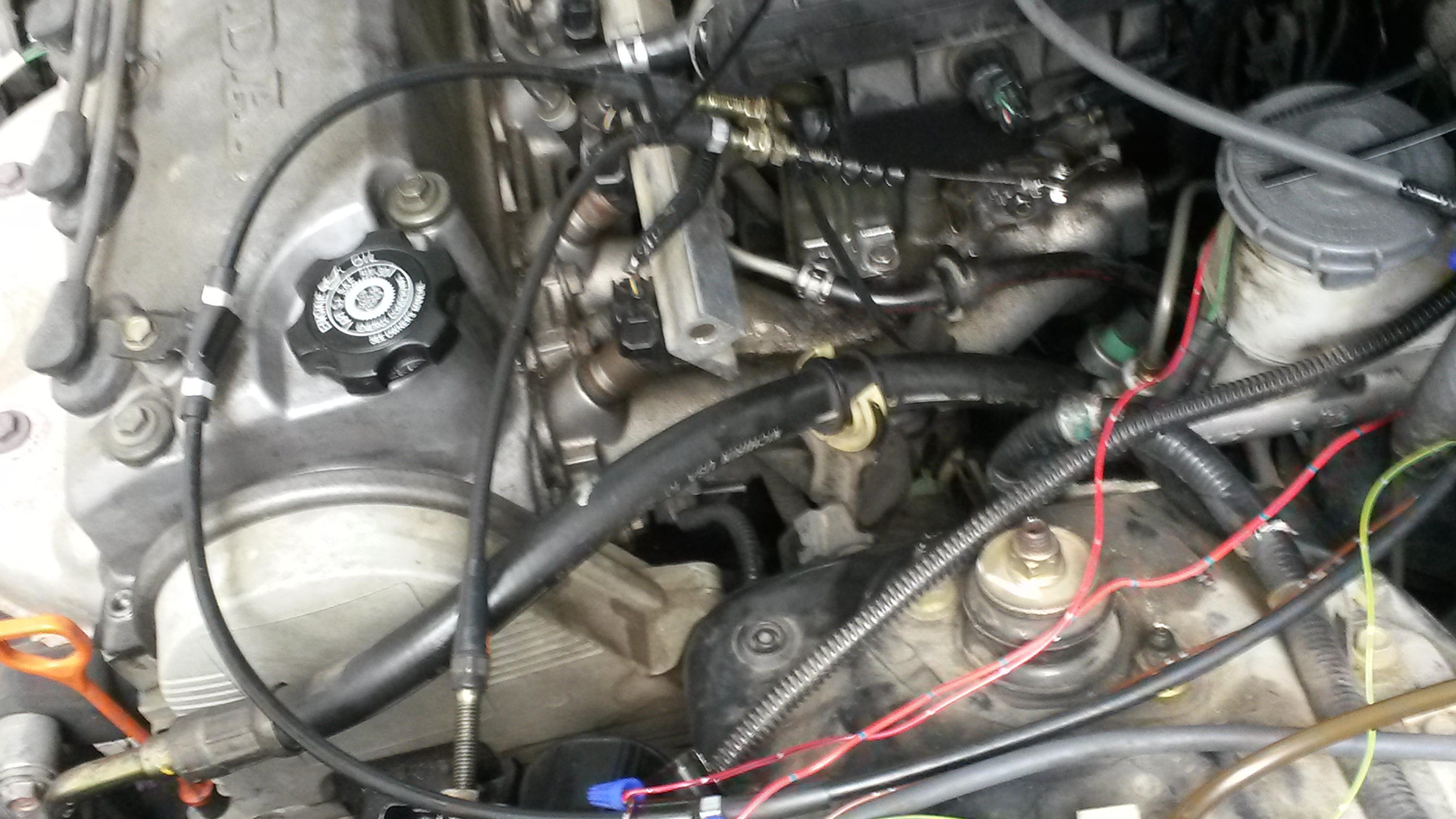

I need another throttle cable bracket mount thats longer with two holes instead of one that mounts on the intake manifold. This is where the servo cable needs to mount, not another location with a separate bracket. I don't have metal fabrication equipment. I already have an extra arm on the throttle for attaching the servo cable. How can I get another bracket made or order one with these dimensions that has two holes?

What is the purpose of the VENT HOSE at the bottom of diagram below. I have that hose floating downwards with the tip open to engine bay air. But on the car I took it from, I think i jerked it out of the windshield washer reservoir. Is this for keeping the servo cool from taking air from down in the windshield washer reservoir? That's the only thing I can think of for a vent hose. Don't know if my windshield washer reservoir is tapped for this to plug into looks like I'll have to remove the front bumper since thats how I got it out of the car in the junkyard.
Old Jun 20, 2015
Re: Factory cruise control adding to 98 Civic DX EJ6
It's exactly what it says. It's a vent. Open to atmosphere.
Maybe NEAR but not IN.
I think it should just be stuck onto a plastic nipple stuck in the frame, it may have a small filter thing on the end to keep bugs and crap out of the hose.
It's been a long while since I've been intimate with a 6th gen car.
Ha! No.
It's a place for pressure and vacuum to go or be sucked from as the servo is applied and released during operation. If you plug it off the vacuum operated servo (diaphragm) may not work.
If you leave the vent hose dangling in the engine compartment it will work but it may get dirt and bugs sucked into it which could eventually clog the filter element. The empty space inside the frame rail or body chambers is usually relatively quiet, airflow-wise.
HTH

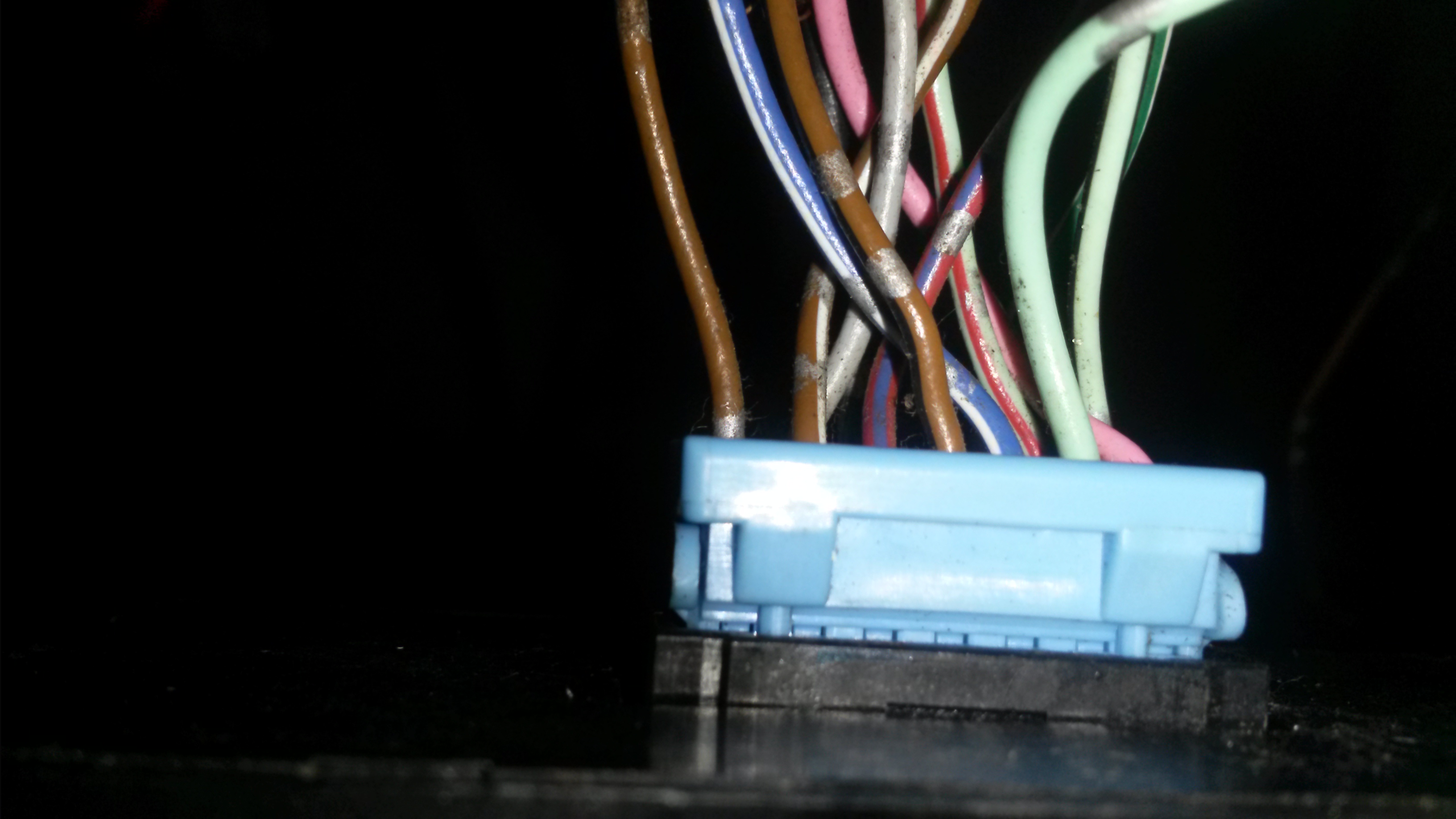

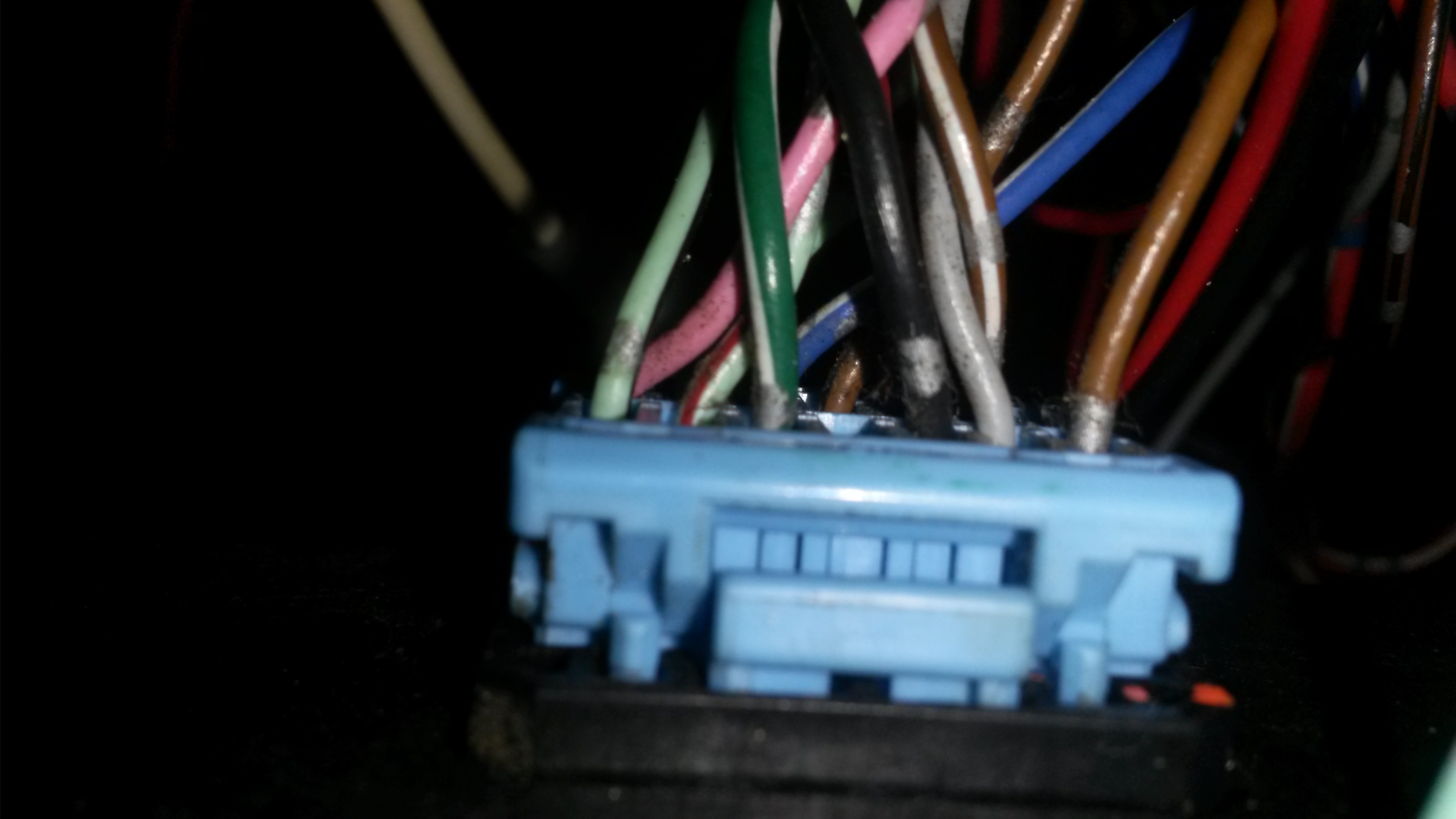

The cruise indicator light does not come on when cruise master switch button is either pushed or released. EDIT: The cluster for an ex that has cruise has a 4 pin jack in the back of the cluster for the cruise indicator light. So maybe this RED/BLU module wire is a signal wire, I want to get hold of a good schematic to tell. So, its looking like I'd need a cluster with a cruise jack after all, and it will have the cruise indicator light built in.
More importantly, I'm not getting any servo action when going over 25mph, cruise button engaged, and hitting the SET/accel button. I don't have the steering wheel controller hooked up in the steering wheel harness, but instead it's dangling from its three wires Ive connected where they seem to belong. Below is my wiring..
Cruise module wire ---> place of attachment
BLUE/WHT ---> BLUE/WHT in back of cluster which is the VSS wire
RED/BLU ---> LED + EDIT: This led doesn't come on. Maybe the RED/Blu along with other wires has to go to cluster that has cruise jack
BLACK ---> Chassis
PINK ---> Clutch PNK/WHT
GREEN/WHT ---> Brake GREEN/WHT
GRAY --> Brake WHITE/GRN
LIGHT GREEN ----> Brake GREEN/WHITE
LIGHT GREEN ---> Master CRUISE SW
LIGHTGRN/RED --> SET/decel SW
LIGHTGRN/BLK --> RESUME/accel SW
BROWN/BLK --> Cruise Actuator BROWN/BLK (thru firewall)
BROWN ----> Cruise Acuator BROWN (thru firewall)
BROWN/WHT --> Cruise Acuator BROWN/WHT (thru firewall)
Cruise master switch wire ---> place of attachment
YELLOW/BLK ----> YELLOW/BLK wire to fuse box
LIGHTGREEN---> Cruise module LIGHTGREEN
BLACK ---> Dimmer BLACK
RED ---> Dimmer RED
RED/BLK -----> Dimmer RED/BLK

Flipped over, the other side of module plug wires..

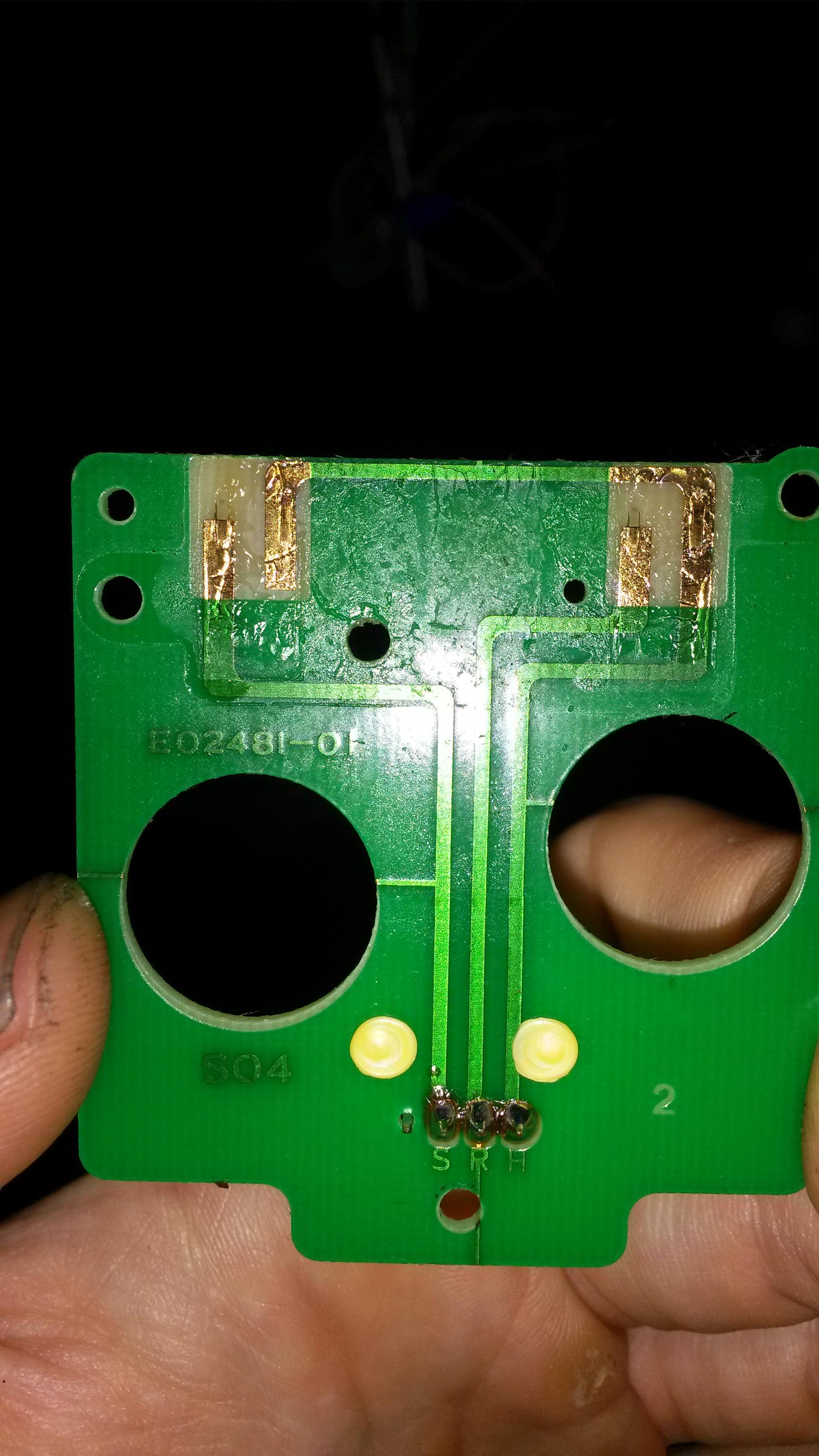

There are 3 black wires coming from the steering wheel cruise controller circuit board. The circuit board has labeled these wires as S, R, and H. S=SET/decel tied to LIGHTGRN/RED, R=RESUME/accel tied to LIGHTGRN/BLK, and H(=what does H stand for?) i've wrapped to Chassis since that made sense given the circuit board below. Im just noticing how rough that soldering looks Im going to check continuity between the three pins.
The light inside the main switch should light up at this time if you have a power (blk/yel, t3) and a ground (blk, terminal 1) in the right places. The 3rd feeds power to the control unit (lt grn, t2).
There are two incandescent bulbs inside the switch (they burn out easily), one is the indicator and the other comes on with the other dash illumination (t4 and t5) lights.
Not the light in the cluster. That's to indicate when cruise is activated.
I only noticed a single wire between cruise control unit and the cluster, it's to turn on the "cruise control" light. The connector used may have 4 wires, but if you know what it takes to operate the light you could put the light just about anywhere you want.
According to the wiring diagram I have, the cruise switches receive power through the Horn relay, so I'll guess that's the H you see.
You really need a good wiring diagram to go much further.

Problems: Cruise Main switch doesn't turn green and the switch is good and have gotten hold of other switches that dont turn light up green either when engaged. The dimmer light works in the button (illumniates the word CRUISE when lights are on and dims) but not the green indicator when I press and release to engaged position.
Steering wheel controller doesn't toggle voltages because its always zero volts on those control wires Light green /red and light green/ black to begin with (not 12 V like it should be in the beginning for them without hitting a SET or RESUME. Hitting SET or the RESUME button should make the corresponding the wire go to zero volts). Maybe its because Cruise never engages, never turns the main switch green ever is why those wires are zero volts always. Does anyone have a wiring diagram or more thorough test procedures for my sixth generation Civic? I've found EG diagrams and seventh generation diagrams not 6th generation.

Lt grn/blk- hold Resume button, battery voltage. FAILED
Lt grn/red- hold Set button, battery voltage. FAILED
Refer to post #12 and a wiring diagram, these switches are tied in with the horn relay circuit to receive their power source on the black wire.

Everything is working and every control button works since yesterday except that it is jerky when cruising. Every second or two going 30-50 mph in 4th and 5th gear it is jerky and makes my head go back and forth to keep the correct speed. So I tightened the servo cable to where it is perfectly taunt and gas pedal cable is equally taunt. So, I now I'm thinking either 1. the servo cable is has too sharp of an angle and stressed (see pic below.. Is it too stressed? I coated entire servo cable with vasoline to help cable to glide inside housing. ) or 2. vacuum leak (I have a tee in the brake booster vacuum hose which I've not checked for leaks). My next step is to check for a vacuum leak and to rehose this. Brake booster vacuum hose I replaced with a fuel hose years ago and cant get it off now exetremly tight on the intake manifold and brake booster.

It doesn't unlike the LX Civic took it from so I've tee'd the brake booster line.
Rehosed that brake booster line 3 times got another hose even. Check valve is in place leading to vacuum canister. Haven't gotten a vacuum gauge yet to see for sure if there is a leak.
Straightened throttle cable housing so its not angled as hard. Played with that throttle cable a lot and not fixing jerkiness.
What I mean by jerky:
When cruising only, every other second there is slight throttle jerk it seems. You can look down at the shifter which kicks back slightly as if gas was given then forward then that happens again and again, the same movement as head movement every second. It doesn't matter what speed or gear. 30 mph in 3rd or 75 mph in 5th there is still this jerking when cruising only.
I'm going to keep testing for vacuum leaking by getting a gauge and for throttle cable problems. Although, what would you try next? It's ONLY when cruising at a set speed.

Here is my video with a vacuum gauge installed, idling and then throttle action:
The needle wobbles and shakes between 20 and 21inHg. But doesn't drop below 20 idling. So that means not a vacuum leak, correct? Before installing the gauge, I sprayed hoses and connections leading to the intake manifold with carb cleaner trying to find a vacuum leak but no audible change in idle when spraying that I could hear. The vacuum gauge's needle shaking I've read can indicate my valves need adjusting (they never have been adjusted and nearly 200k miles). Could this be causing my cruise control to jerk/surge every other second? From the video, what should I do? And let me know if I should do more thorough tests with the gauge installed.
If you think it may be a cable problem, get into the servo end of the cable and work the cable by hand to see if it can pull the throttle open smoothly or if it works jerky.
It's smooth when I pull from the servo end. I've repositioned the cable and housing so much, adjusted the nuts, etc. Doesnt affect jerkiness when cruise is set.
Then maybe try changing the amount of slack in the cable.
Tried this. Went from being taunt to slacky. Then, set to 1/2 inch deflection which is spec.
How is the cable attached to the throttle?
A metal arm is bolted to the center of the gas pedal's throttle pulley.See pic.
