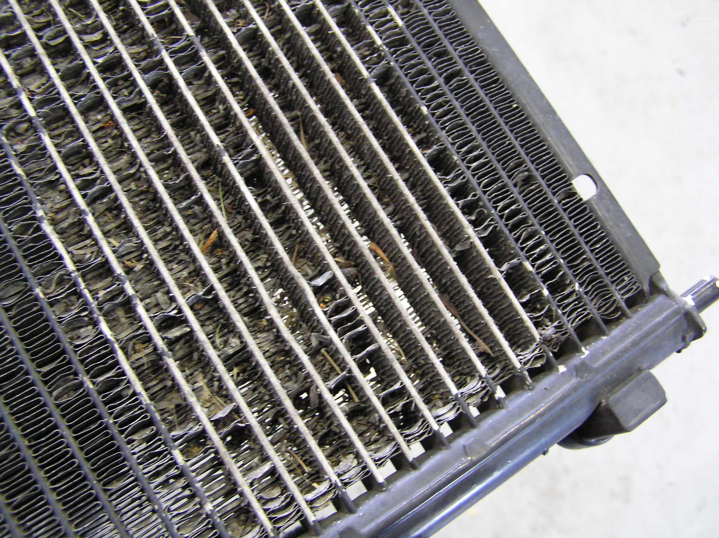

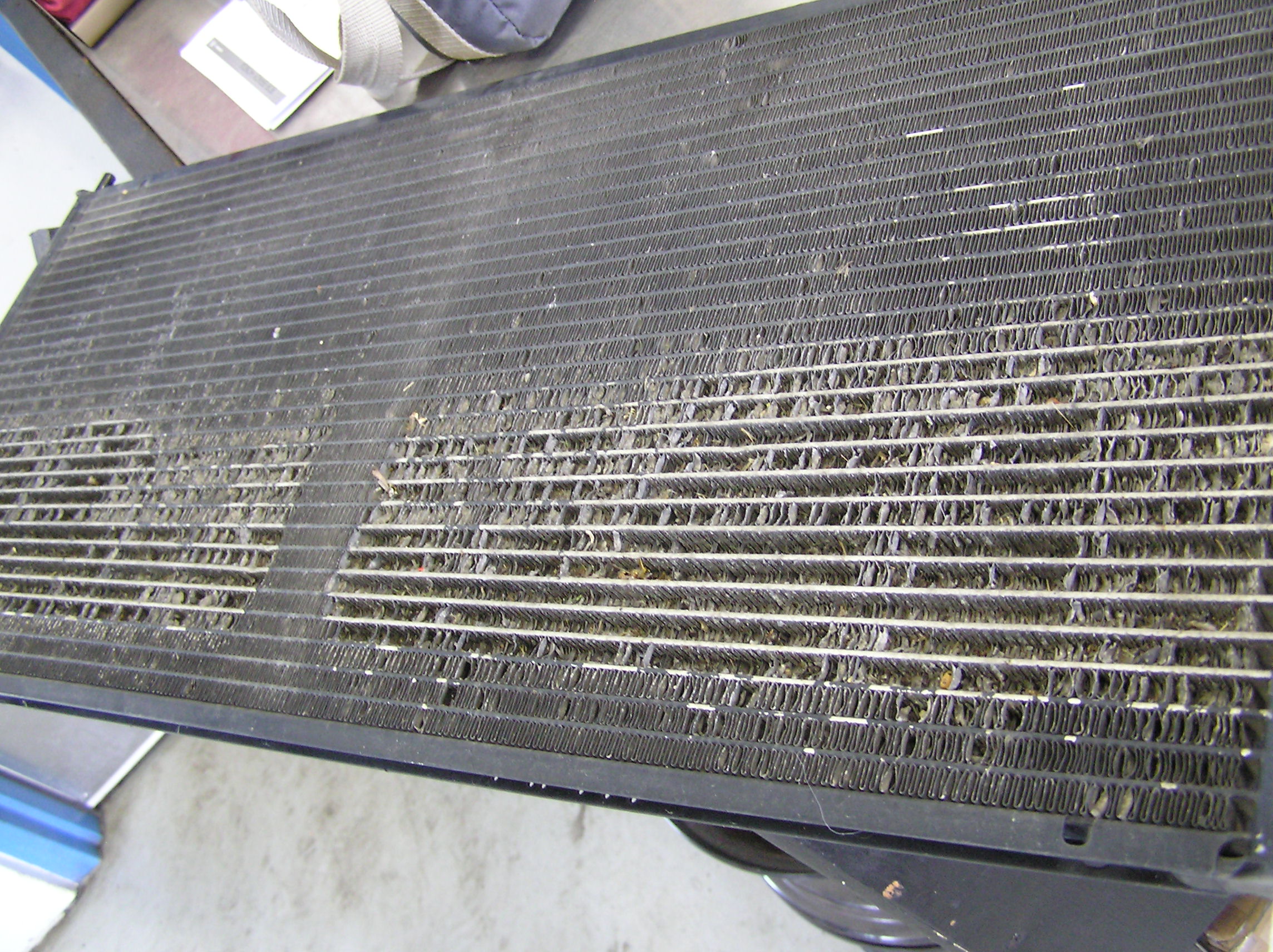

Originally Posted by ezone
Have you looked at the condition of the condenser??
Many miles and years of getting hit with road debris can damage the thin little fins, folding them flat so little air can pass through them
Road salt erodes the fins and they detach from the tubes,
and bugs eventually clog the fins
All these lead to inability to transfer heat, contributing to excessive high side readings
Pic of a condenser removed from a 2007 Fit with 250k miles on it
Size:  844.8 KBName:  IHsD0y5.jpg
The damaged fins were almost all you could see when looking through the front bumper openings
