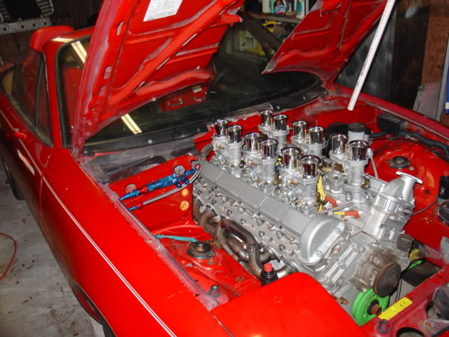

With enough time and money? Anything
In a serious tone, anyone attempting to do such a thing are resourceful, so they did not ask, they up and done it.
Resourcefulness are a must. If you need to ask, the chances of not completing are really big.

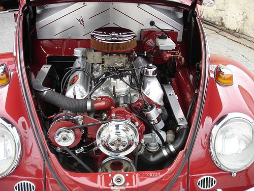

Actually, this V12 Jaguar in a Miata, the maker did start by asking questions in forums, so it is not unheard of. He actually completed the build.
I am not mocking you, mind. If you are serious, by all means go do it.
But even a K-series swap (most common) or a B-series (getting rare to find engines) will have troubles that looks unsolvable. If you are not serious, don't try.
