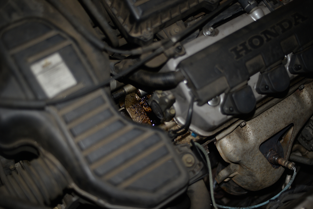

Here is my engine. Looks like this picture confirms where the leak is coming from? That's a puddle of oil right under the black cap. I need to read that other thread and deal with the oil leak now.

That might not be the only oil leak, but your end cap is definitely leaking. The youtube video in post #5 (of that other thread) shows it's very easy to replace IF the cap is intact when you remove it. If the teeth have fallen off I wouldn't leave them in my head. I'd remove the cylinder cover and remove any bits that were in there. I'd replace the cylinder cover gasket and plug tube seals while I was at it.
Don't put gasket seal or Honda bond on the end cap, it isn't necessary.
Next up, If it were me I'd pull my starter and see if I could have it rebuilt at a local shop... if not I'd visit Pick n' Pull. I'm tight like that.
