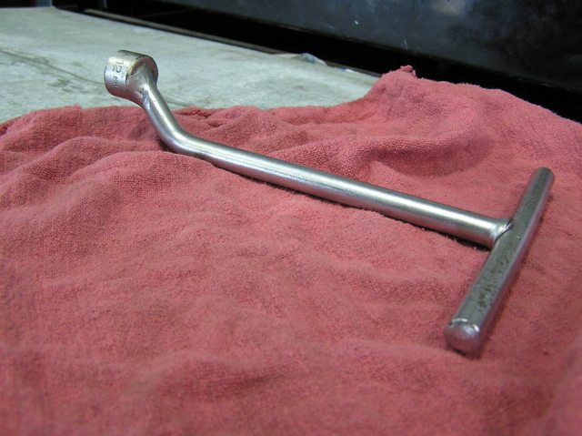

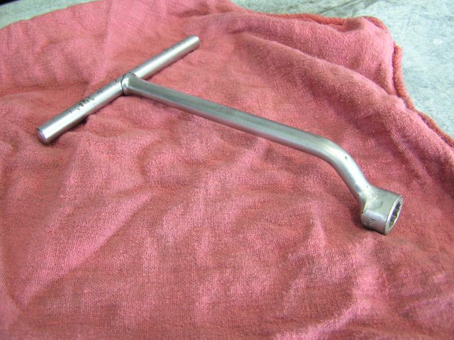

Re: How do I fix this minor oil leak?
Here's my favorite
But I doubt anyone is gonna find one of these easily.
Next might be one of these
Seriously, I don't remember, and IDK how a DIYer would do it. I have an arsenal of tools to select from.
Anyone else? Anyone? Bueller?
Alternate method comes to mind...but you risk pinching the O ring when you bolt down the journal cap.
Remove the valve cover, remove the journal cap that covers the plastic plug in question, replace plug and reassemble? That would let you avoid touching the EGR valve altogether.
