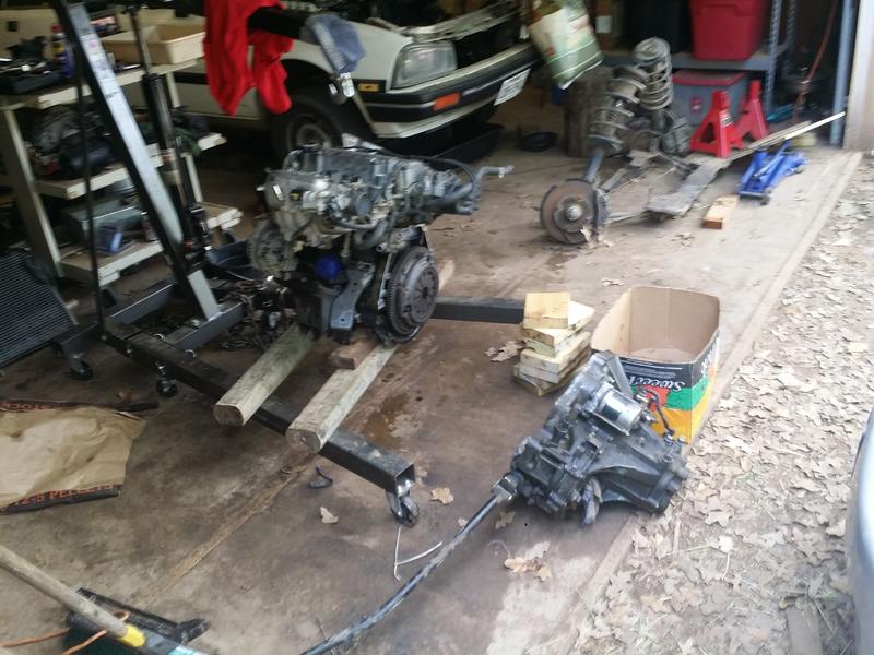

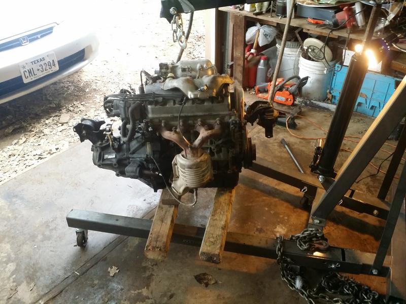

I have a 97 HX with barely under 200k on it. Couple weeks ago I took out my engine and had to send the tranny to shop for bad input shift bearing. Unfortunately it's going to take a couple more weeks before repaired and so I was wondering what I should do in the meantime. The car is old and has plenty of miles but engine runs great and doesn't leak oil. New radiator, new alternator and a couple odds and ends.. I was hoping for some advice on what I could be checking while I have the engine out. I'm not big enough with cars to know what I should also work on but I can if I know what to look for. I was thinking timing belt, water pump, maybe starter? I already have an axle boot and a motor mount to replace. I have had very random off and on misfires every 2 months or so for past 2 years but so minor I never cared. Any advice on what I should take apart and clean/change out? Thanks, I'll include a couple pix for the hell of it

Timing belt is supposed to be changed every 7 years or 100 000 miles. Now would be a good time if the engines out. I believe water pump is recommended at 200k miles as well. Check the condition of your motor mounts. Clutch? If it were me I would paint it just for giggles and clean/wax the engine bay while it was out too. I'd paint it something like lime green and tell everybody it was supercharged or something.
