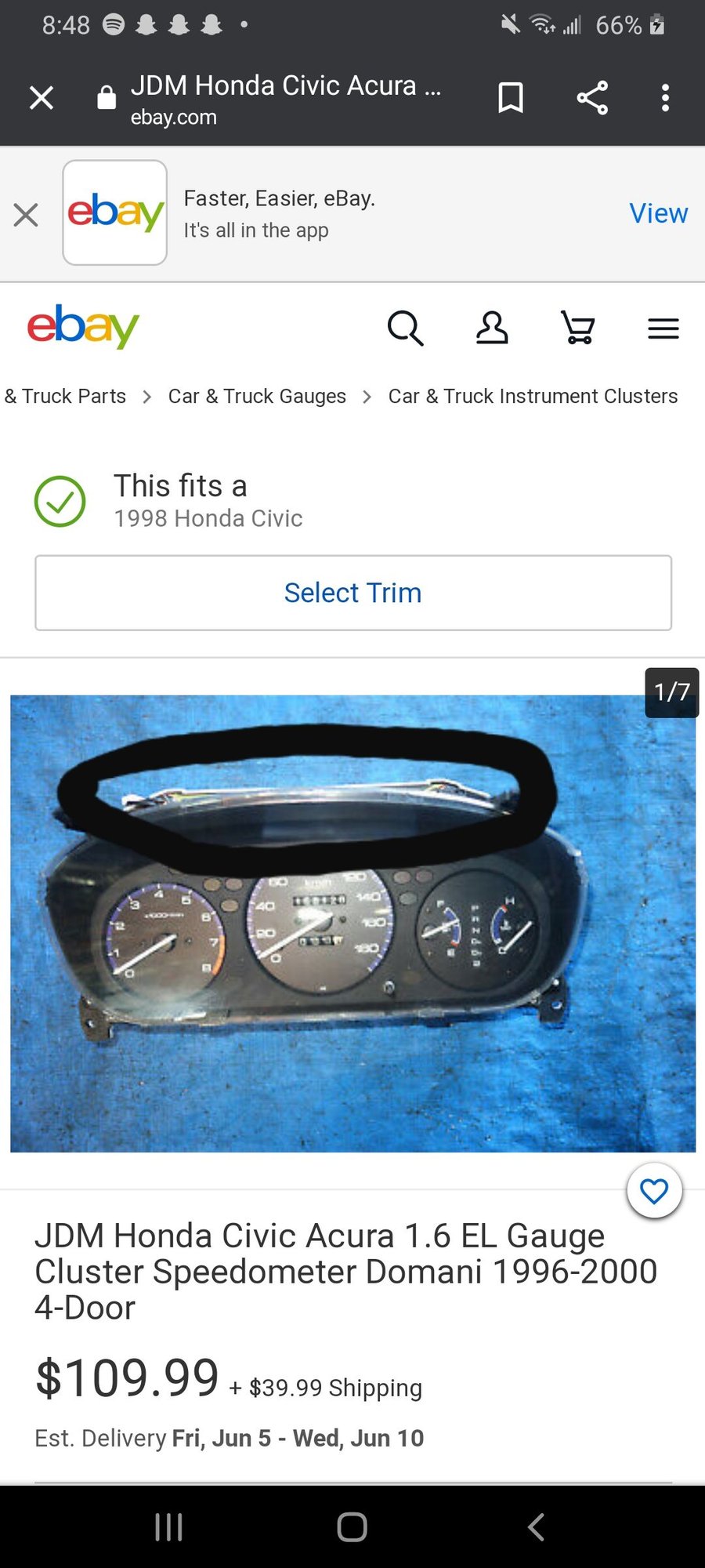

What would the thing holding the 2 lights shining down on the needles be called? One corner of mine is broken and I cant find anywhere what it's called, it's broken enough that the lights dont work from it and 1 light doesnt stay in

Like the little socket that holds the bulb? Pictures would be helpful

I'll be able to get pictures tomorrow, everyone's asleep right now, I got pictures off of ebay, it's a little hard to see but it's the best I can do atm, I havnt been able to find it anywhere

So the clear plastic cover? That doesn't hold any lights. Junkyard, any 96-2000 civic will work. It will be like $5

Hm alright, I guess I'll have to get new lights too then, thank you

There's little quarter turn sockets on the back of the cluster for the bulbs

I've heard them called "theatre lights" since they are lighting up the gauge display. However, searching for that won't give you what you're looking for.
Search for "neo-wedge" bulbs. That will be a small bulb with the wires wrapped into a plastic socket.
If the bulb can be removed from the original socket and you just need the bulb, then search for "miniature wire terminal bulb".
Check out Bulbtown.com for helpful videos.
