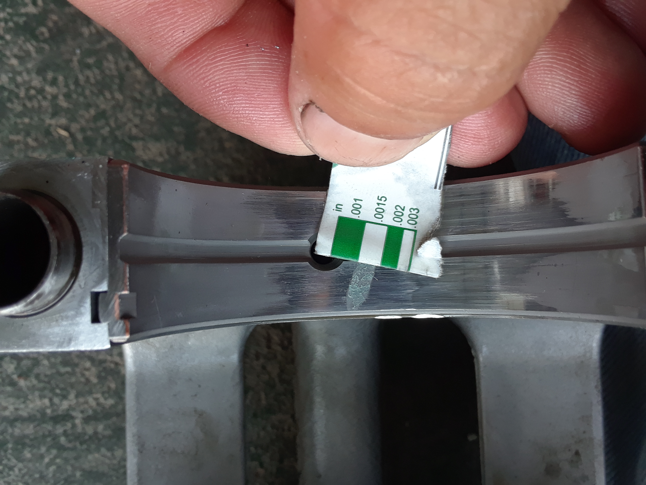

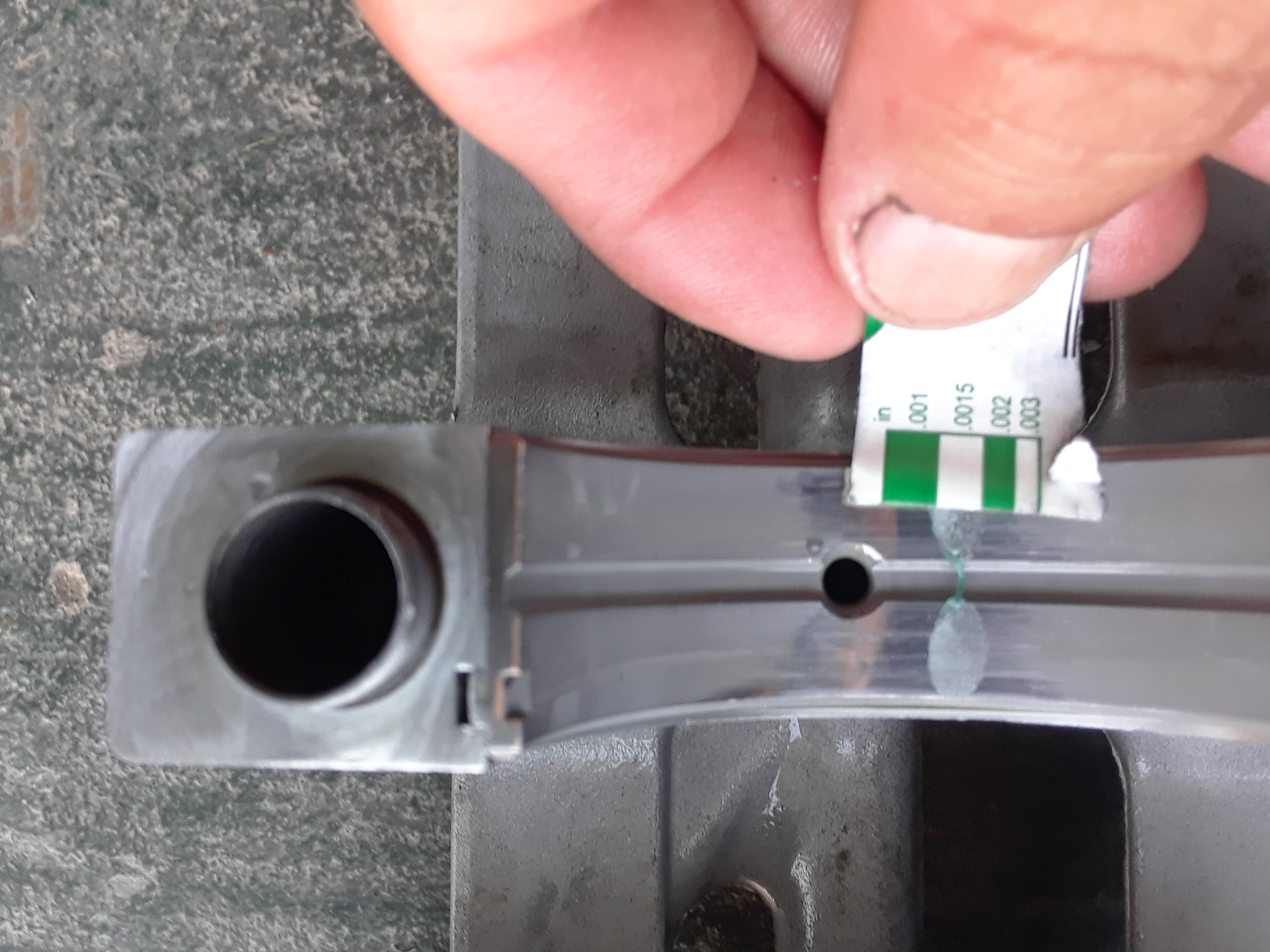

Yeah, I know. I just plastigauged the mains. Let me knkw what y'll think. Pics coming in a bit

Do you know what the factory spec is?
Same deal for the rod bearings too.

The only info I found states .0007 - .0014 for #s 1,5
And .0009 - .0017 for #s 2,3,4
I could be wrong though.

I didn' t do the rods. Didn't want to get so deep. Y'all think these two are enough to cause the low oil pressure??? I hear a small tick but that might be the valve lash (set to 8 and 10)

Looks like it's at the wide end of the spec range. Not ideal.
I'd say to check the rods.
Too many of these with clearances of 'almost too much' can add up to a total amount (I learned it as "stacking tolerances") that's just more than it should have, more than the pump can keep up with. You end up with low pressure.
