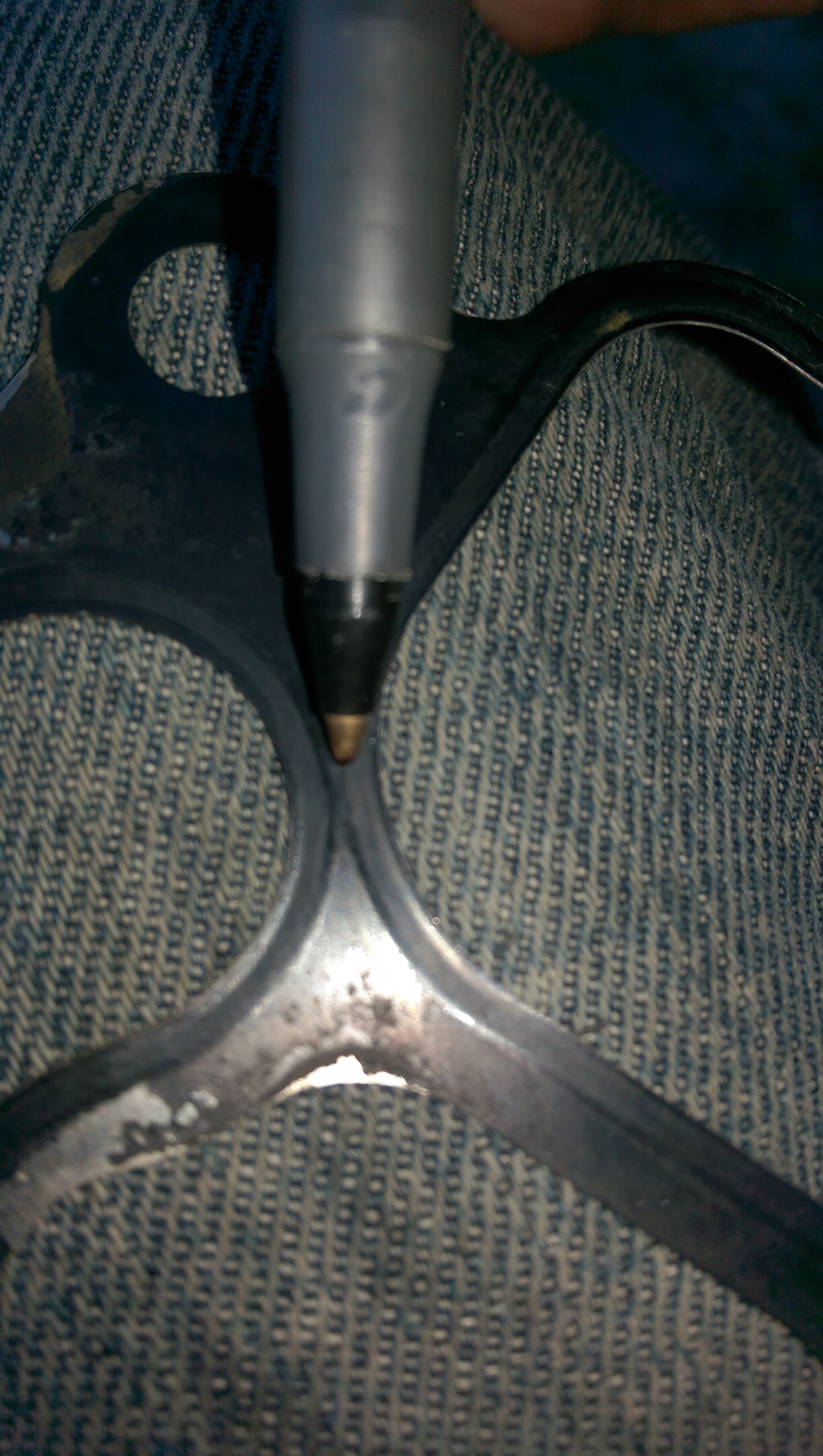

this should be enough proof......
Quote:
Now I am seeing the same original symptoms. The coolant overflow fills up and is not going back into the radiator when it cools down.

yeah but if u had blown your head gasket i would assume u would notice the loss of power, cuz u would be loosing compression. (mine was a slouch with a bad h/g) But u said it "runs really good". the water passage feeds off the exhaust side of the head(not inside the combustion chamber) so the only way u might notice it is IF it ended up fouling your 02 sensor(coolant leaking into the exhaust when the motor is off). it would not effect the driving much, if at all. Also it wouldn’t be detectable with a compression test or leak down test, but u would still detect carbon in the coolant.(the back pressure in your exhaust manifold would create a high pressure in your cooling system, pushing fluid into the overflow)Originally Posted by Scout1;4698712I
know on a couple of places on the block there is not much gasket between the combustion and water ports. That may be part of a design issue. I believe it is the D17A2. Think about it, im talking about a 5-10$ part that should be changed anyway, that only takes 10-20 minutes to change out while the head is on the car.....or $110+ H/G set and hours of work

yup, definitely your HG
my '05 deff had power loss from the H/G.... u cant tell me he shouldnt replace the water passage gasket first, since he has to do it anyway. its 1/10th the price and 1/10th the time.

this is enough evidence to conclude a blown HG.....

If it passes this test, then it's probably ok right now.
sdaidoji I had clogged egr passages and egr...the carbon build up was wet and slimy. I had the same issue after the head gasket along with a rough idle...soaking my egr fixed that...it was making me run lean at WOT. forgot to mention that.
If I start car now my radiator doesn't pressurize till the the car heats up like it's supposed to (lol just realized I forgot to get a new thermostat)
Edited...damn auto correct
Quote:
That's why I think he needs to replace the easy cheap part first
Yes, I agree about the water passage gasket, and replacing the cheap part or parts first.Originally Posted by thisguy357
PmI read my first post...That's why I think he needs to replace the easy cheap part first
