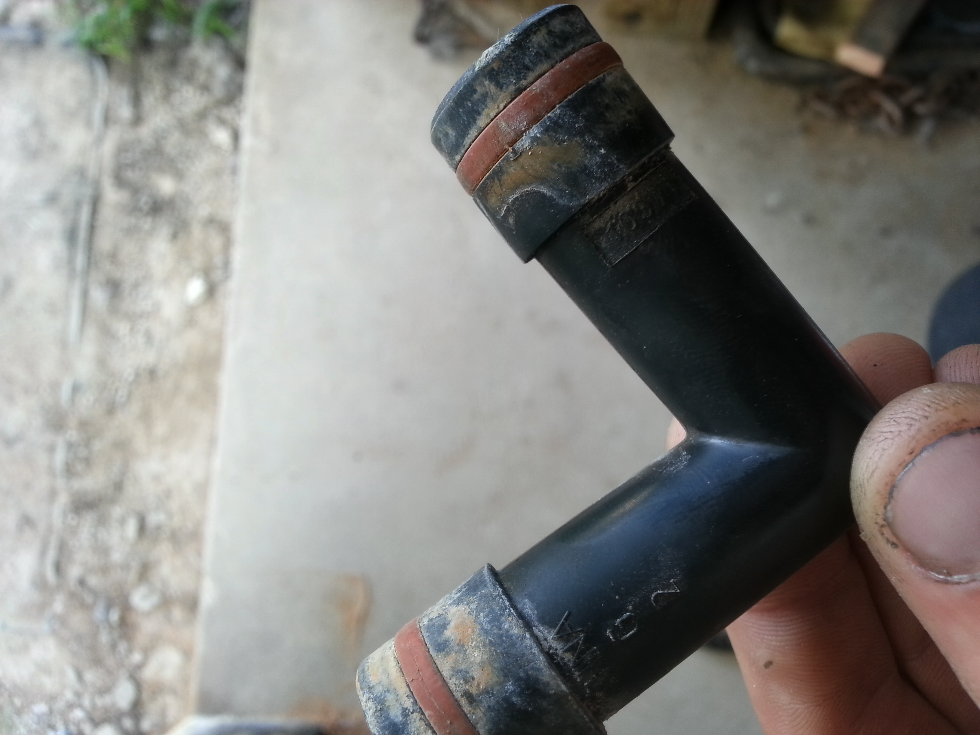

url]http://m.summitracing.com/parts/fel-hst9957pt2?seid=srese1&gclid=CjwKEAiAs4qzBRD4l-2w7qOoqEMSJABauikXSjAYb88etXwezgQA4uOwAnY8ZFfNznvm e19AgLRn2hoCPX7w_wcB[/url]
These aluminum LIM Gaskets? The 3.1 also had plastic coolant elbows that failed (just like the 3.8) did u replace those with the Dorman aluminum ones? If not the will fail much quicker
