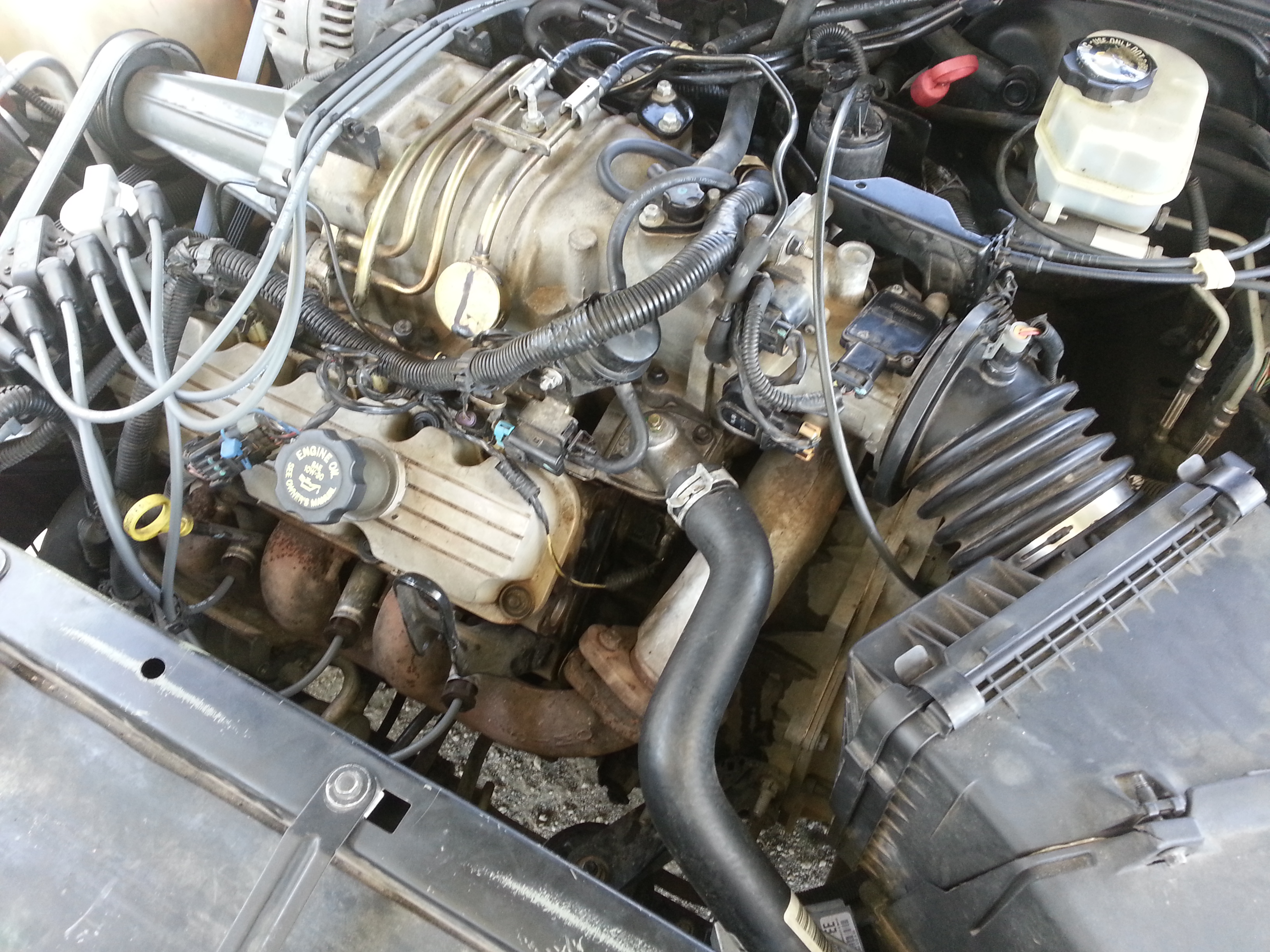

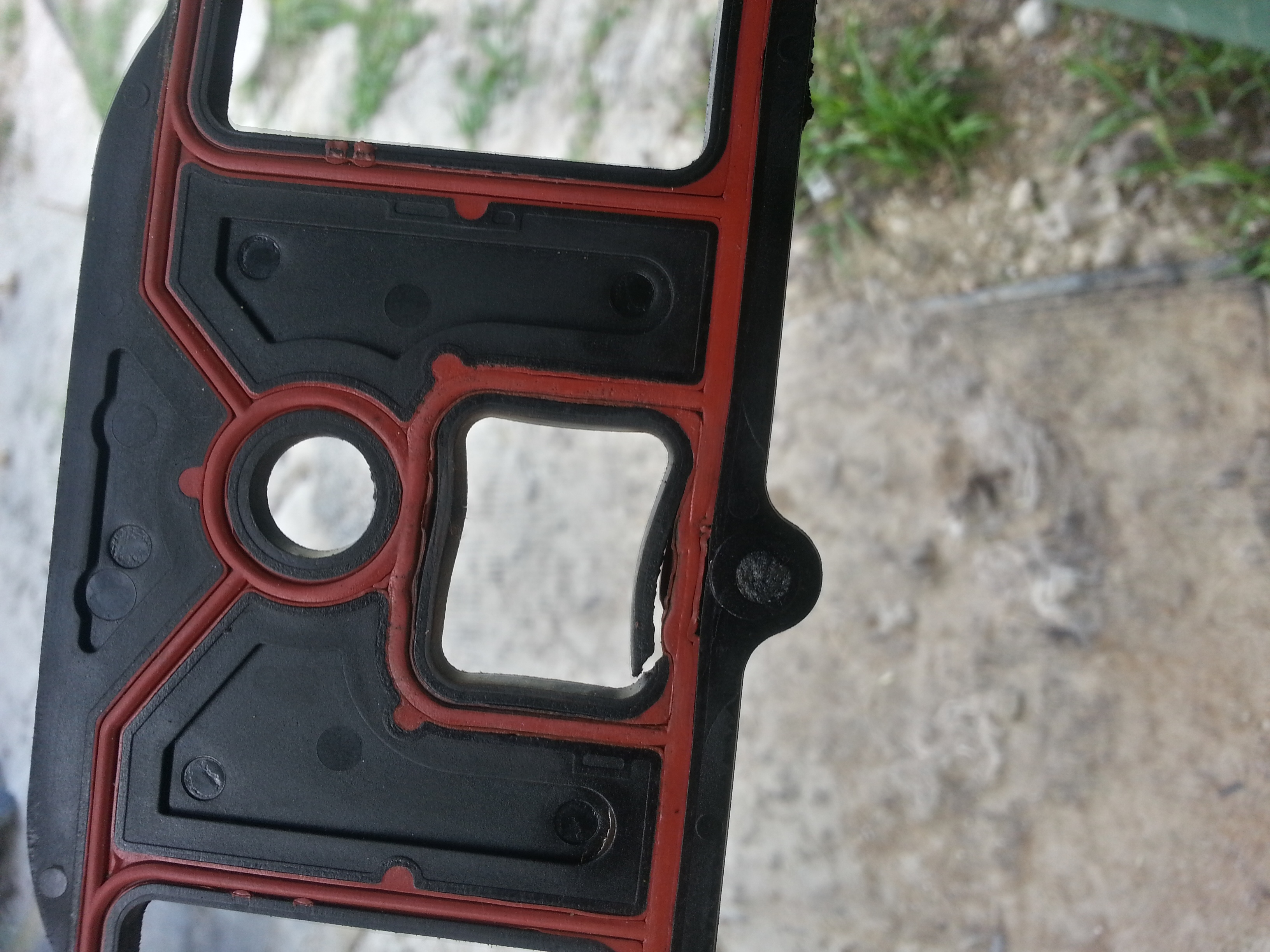

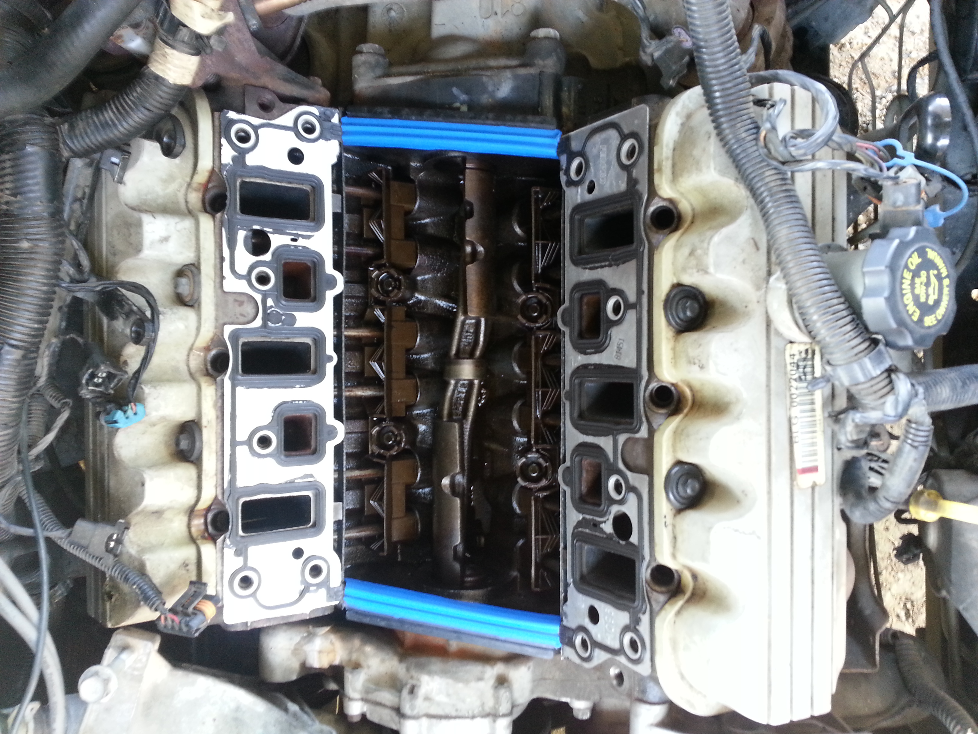

First I'm not trying to be argumentative, I'm just trying to save people time and monies
Second I have never had a felpro gasket fail..it s the only gasket I put on my personal cars
**black plastic LIM gasket is a GM andfactory part that fails alot but felpro makes upgraded gaskets. notice the felpro aluminum gasket set with thick rubber seals(notice the supercharger)
This car blew coolant everywhere because the LIM gasket failed at the water jacket and the boost SPRAYED coolant everywhere no coolant in the oil though lol!

Re: 2001 Head gasket Again?????
Felpro blue color is their trademark.
About 5 or 6 years ago I received an unopened brand new Fel-pro box and installed a set of red gaskets very similar to this pic in in a 95 or 96 3.1 GM that belonged to my GFs son.
I thought the red color was a bit unusual at the time but installed them anyway.
It lasted all of 2 years before caving an intake port and putting manifold vacuum on the crankcase, causing a really strange whistle or squeal noise.
The next Felpro set was the familiar blue color and lasted until the car was totaled in a crash.
Old Dec 5, 2015
the red gasket is a factory gm gasket
its from the L67 3.8 l supercharged V-6
felpro update gaskets are generally aluminum. plastics are cheap OEM replacements.
its like getting an original OEM GM lower intake manifold gasket, they fail...thats why there is an update part
kinda like GM swaybar endlinks use to have plastic spacers and would break going over a big bump...just cuz something is OEM doesnt make it right
You think I received original GM gaskets in a Felpro box?
For a 3.1 engine, early design, the ones that DID last at least 80k before they failed? (unlike the later ones that failed so quick under warranty GM had a national backorder on them in the late 90s).
nah it might have been felpro, what im saying is u probably got the OEM style (plastic ones that fail) not the updated gasket (aluminium)
I'll stick with OEM for the Hondas I service.
to each his own
I've not seen aluminum Felpro gaskets for the mid-90s 3.1 (M engine), and the most recent one I have done was in the summer of last year.
