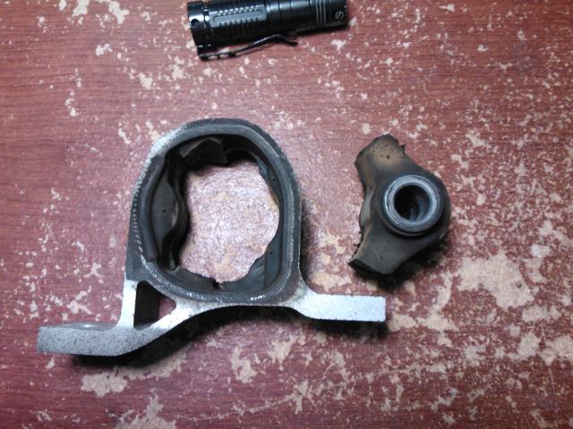

Any one see a problem with this front motor mount? I was thinking of just super gluing back in.
Old Dec 12, 2012
Re: Front Motor Mount Help
This guy just called:
Said that mount looks like it is shot all to he!!.
Have you seen a DIY for making/repairing mounts using some sort of urethane?
I have, but I'm good with just replacing these every view years. Not too many mcdoubles compared to a car payment.
