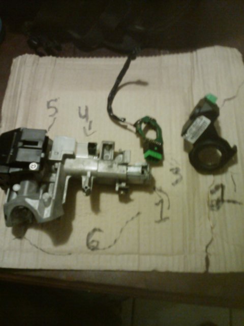

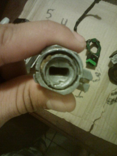

ok heres some pics of what i got this is off the ex the original parts the key lock is broken thats what the whole problem is cuz any key fits in it and starts the car and when im driving it the keys will fall out the ignition but thte car stays on. thats why they said i have to replace the whole cylinder which doesnt make sense why they cant order just the part where the key goes in

i was wondering if i take off part 1,2,3,4,5 and put them on the lx cylinder shell then if it could work but the only thing is the key would be diff.
Different key would still need programmed.
Heck, who cares if you can turn it with a screwdriver. The engine can't run unless the immobi saw a correctly programmed key.
Ok....
Ok, ummm, you are kinda screwed if your dealer doesn't have anyone capable of building one of those locks.
Honda only sells the steering column lock assembly complete with a pair of new keys, you can't buy any individual parts for the lock or its housing.
You can only buy the electronics and the ignition switch electric part separately.
The dealer SHOULD have a kit of tumblers that can be used to rekey the sidewinder locks.
But they need someone capable of doing the work......not all people can do it.
There are NO instructions from Honda for doing ignition locks. In fact, Honda frowns on it in the bulletin on rekeying the locks. They only tell us to retumble door lock cylinders. Someone has to think outside the box to fix an ignition lock.
I'm the only one in my dealer that does this work.
I would probably remove and strip just the cylinders out of both column locks.
Figure out what I need to swap in order to build a good cylinder. Yours looks like it is missing the shiny end cover from the cylinder. As long as the other lock has what I need, it should work.
Retumble the lock cylinder to fit the original key. New tumblers.
Reassemble, using the original immobi electronic parts.
Use with the original PCM.
You in the USA?
Would this be a good time to tell you to ship the locks to me? I would need a good original key, and the VIN of the car to get lock and key codes (again, USA only)... With a certified check for 120 American Dollars to cover tumbler parts, 2 breakaway bolts, taxes, and my work. Plus some money to cover shipping UPS.
